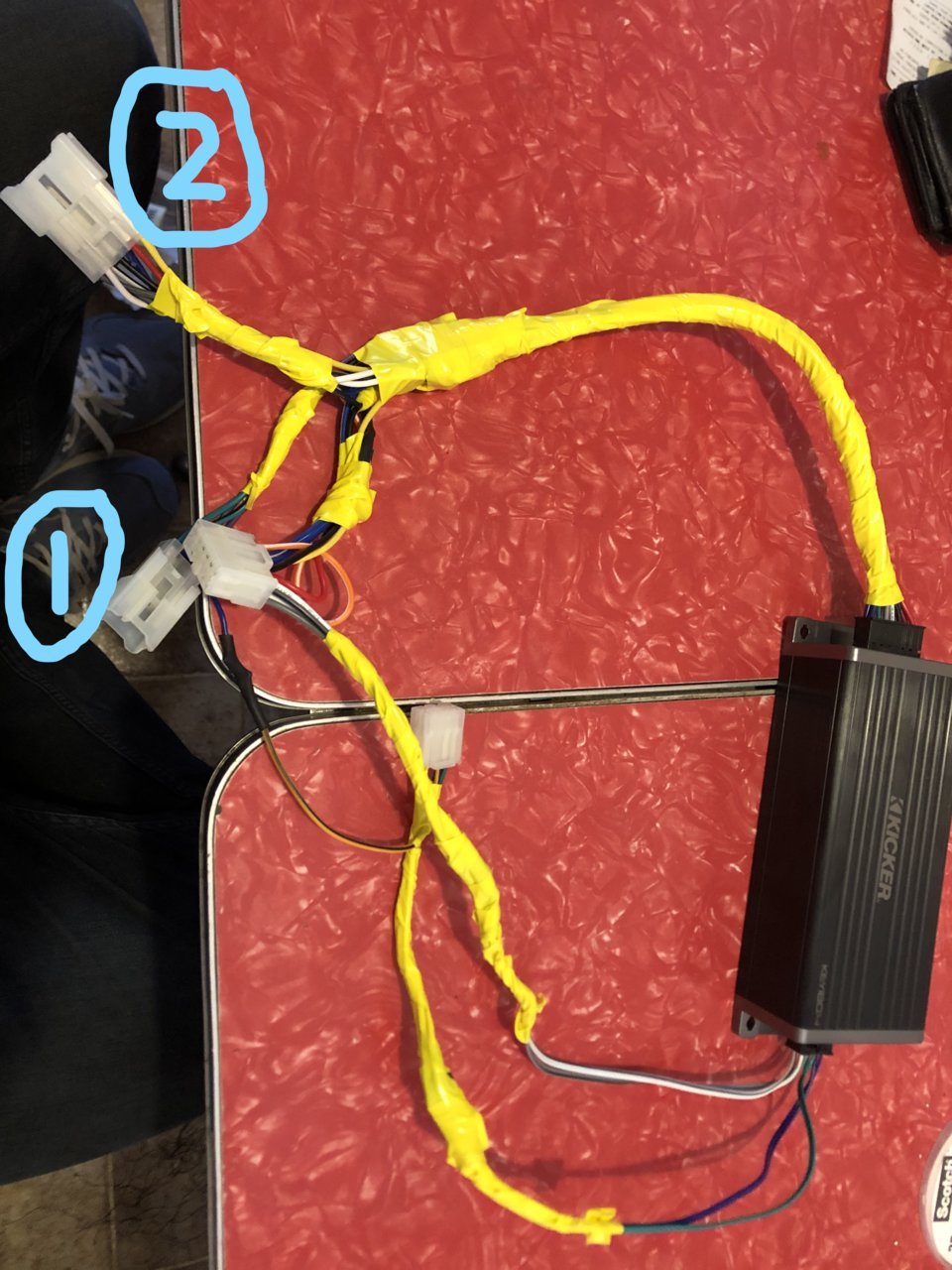

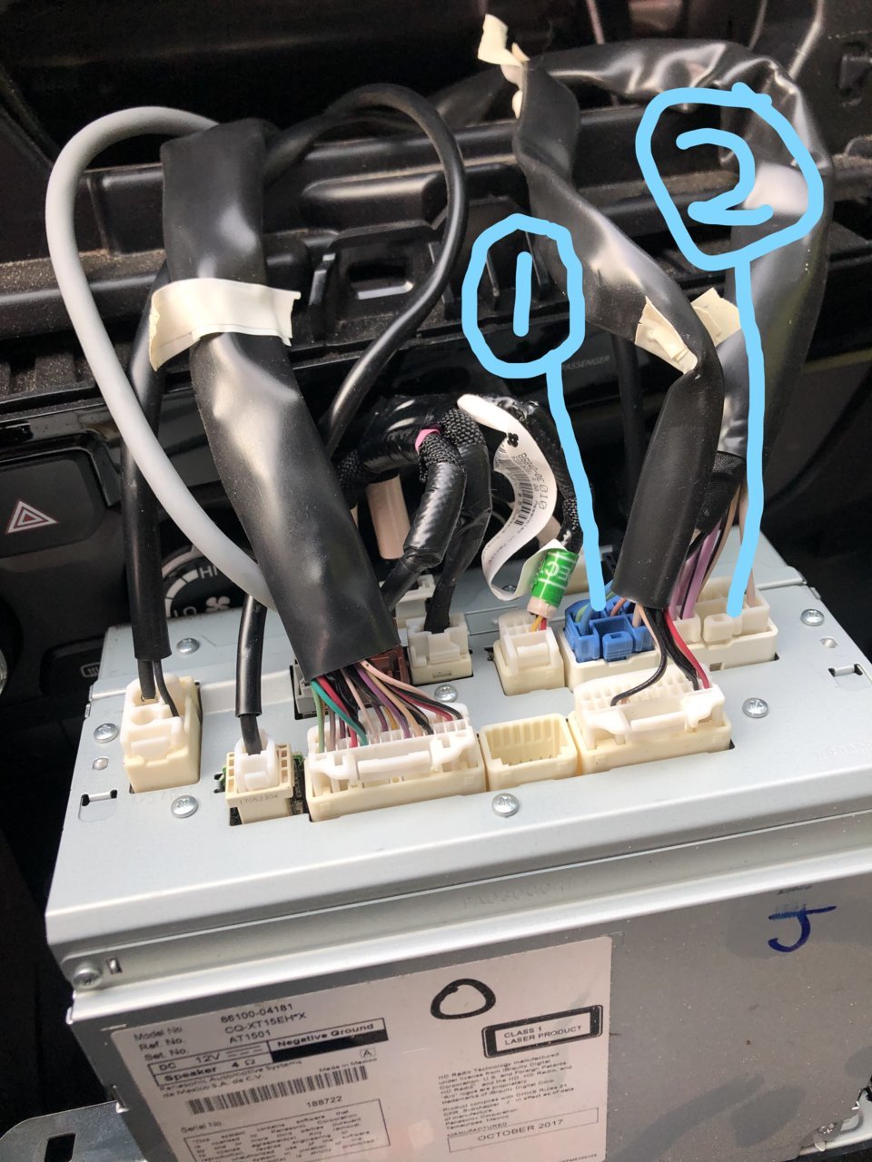

    Forgive my ignorance.... I have completed the T harness as shown in this and the other detailed thread. I just took out the head unit and I need some help with the connections. I think I have the speaker connections (from amp to speaker), but have no clue with the rest. See these:

    The 1 and 2 on harness will go onto the unit the ones that come off the stock unit will go into the the other 2 connections
