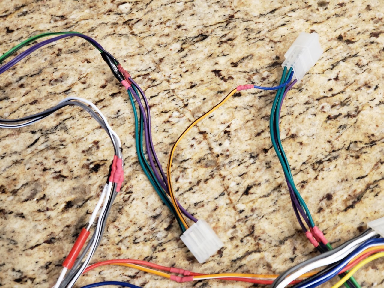

    I just assembled my harness this morning and plugged it in to test and all I got was sputtering from the rear speakers...no audio. Any ideas?

    Bad connections, incorrect wiring. Could be number of things. Got a pic of your harness? Did you solder the wires together?

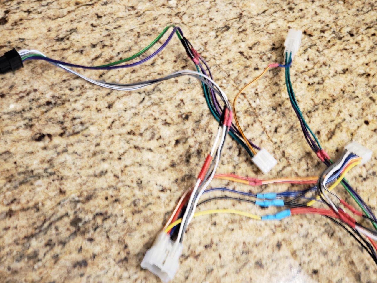

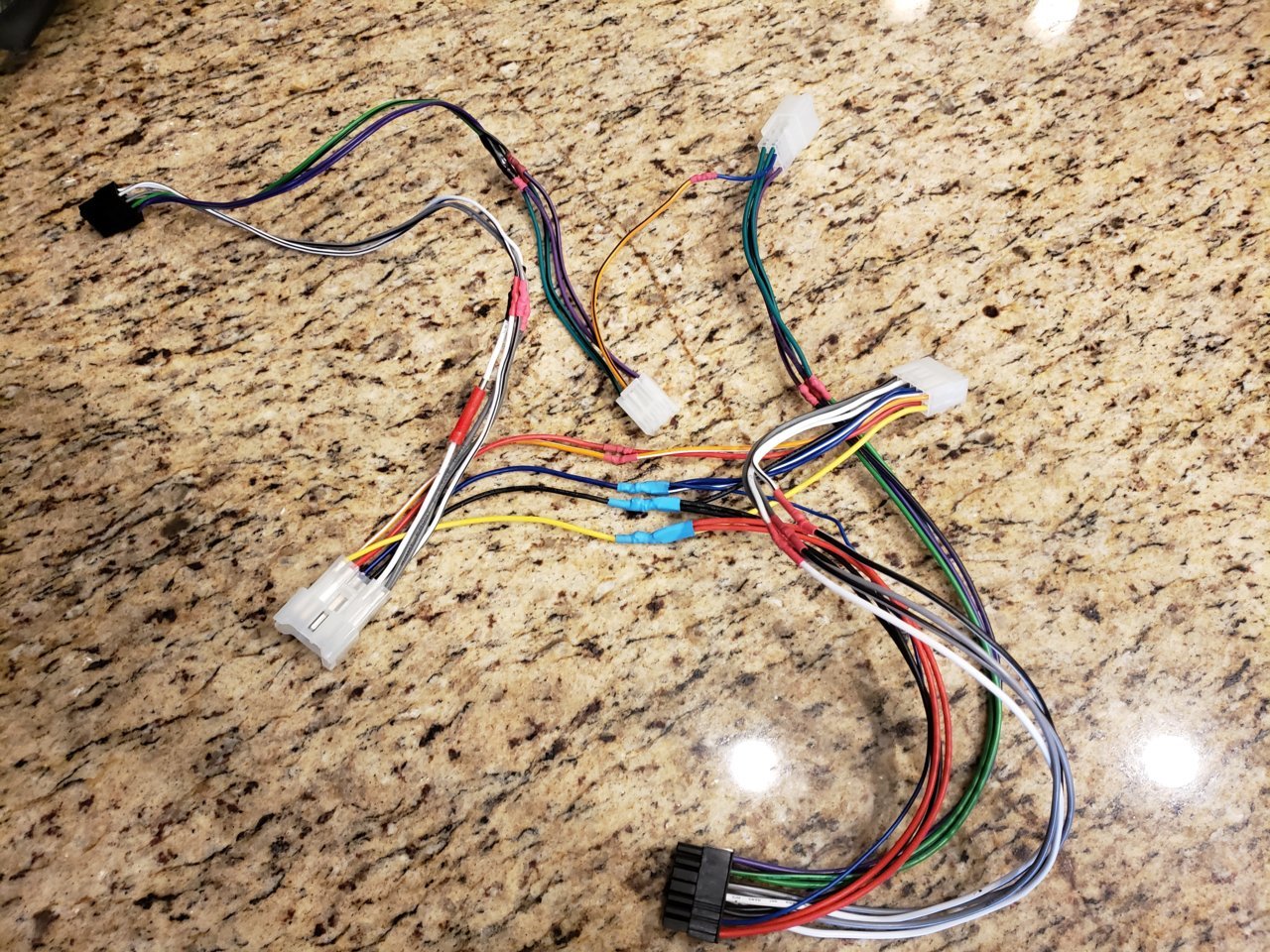

    I started to solder,but for some reason my solder iron wasn't getting hot enough,so I twisted an heat shrink most of the connections.

    @destin_meeks sorry to bug you again, I've re-done most of the connections. My soldering iron isn't working, but I tried plugging all in and I'm still getting rear sputtering sound and no audio. The connections seem solid. I've spent all day in this and it's defeating me. Also the large metra plug is getting VERY hard to remove from the back of the radio...I'm afraid to keep trying for sale if damaging the radio. Do my wires look correct,and should I try new metra harnesses?

    Your wiring harness (at least half of it) is wrong.
    you have the radio output (Metra connector that plugs into the radio) wired to the Key output. That’s a no-no.
    Your rear harness (green and purples) is correct. The front harness (whites and greys) needs flipped
    Philrab likes this.

    Thanks @destin_meeks for checking that. Ill take another look at the instructions tomorrow and fix those. That would explain it. Hopefully I haven't damaged anything. I'm not sure why the larger metra is so damn tough to get out of the radio.
