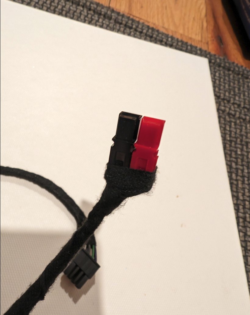

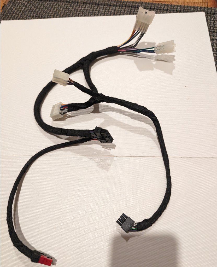

    My last unknown was how I was going to connect power/ground to the harness. I found some Anderson Connectors that fit the bill really nicely, making the entire harness easily removable if needed. I ran power to the battery and the ground to the grounding point to the lower left of the radio opening, behind the climate control panel.

    LOVE the connectors for your power and ground! Post a link to that if you can because every key install needs that

    Thanks! I searched for a while to find something I'd be happy with. It's really nice how the two connectors mate together to make a single unit.
    These are the connectors: https://www.amazon.com/dp/B01EUD2IJ8
    And these are the crimpers: https://www.amazon.com/dp/B01MSQPTDS
    The connectors are just a tiny bit small for the wire in the Scosche kit, but I was able to easily open the connector barrel just a bit with my nail set (see the middle connector in the pic below). As you can see, they still crimp down perfectly.
