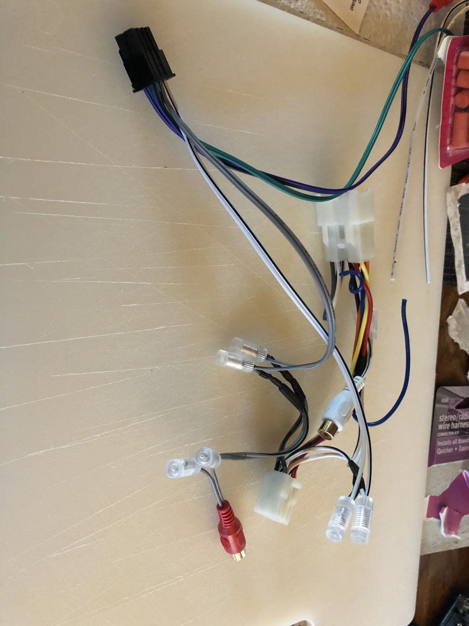

    Thanks a lot for the replies guys. Does anyone have a schematic of the way the harness needs to be connected? If not, I might do one once I do it myself for other people to save them some time and headaches.
