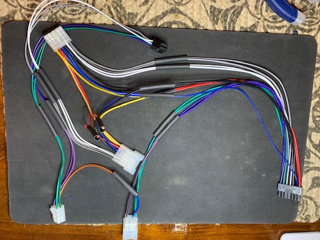

  13. May 17, 2019 at 8:41 PM
    #113
    horntac1
    horntac1 Well-Known Member
    May 5, 2019
    #292309
    94
    Alright here is my mocked up harness. The shrink tubing are just place holders. If you guys can take a look and let me know if you see any issues I would appreciate it.
  14. May 17, 2019 at 9:49 PM
    #114
    Btvr17
    Btvr17 Active Member
    May 7, 2019
    #292563
    40
    Vince
    2019 Tacoma Double Cab V6 4x4 TRD Sport
    Looks exactly how mine is wired.
    horntac1 likes this.
  15. May 18, 2019 at 5:14 AM
    #115
    horntac1
    May 5, 2019
    #292309
    94
    Great! I will begin soldering and shrink tubing the connections. I bought tape as well to keep it clean like yours.
    Btvr17 likes this.
  16. May 18, 2019 at 7:30 AM
    #116
    mblume7
    mblume7 2017 Cement TRD Pro
    Aug 22, 2017
    #227688
    60
    Mitch
    Salt Lake City, UT
    2017 Cement TRD Pro
    Looks great! Just like mine is wired up too. You'll be pleasantly surprised by the difference this makes once you get it installed :D
