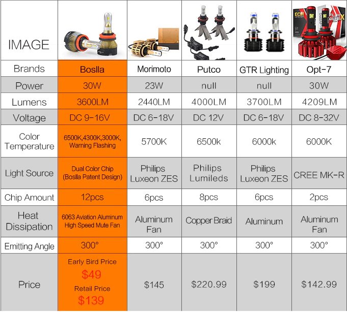

    I don't know. This is from their website...

    Specs on paper is irrelevant. Need @crashnburn80 to test out these suckers

    Totally agree.

    LEDs are awful performers in a halogen assembly, because the light source is not correctly aligned with the optics of the halogen assembly. Many manufactures now align them in the correct X and Y location, but are unable to make the light source as small as a filament, meaning they are still off in the Z location. Being off in the Z dimension eliminates the hotspot so your beam has no distance projection or 'throw' as people like to call it, because all 3 dimensions need to be aligned for focus, and focus drives distance projection. On top of that, the LEDs are only pointing to the sides, and LED light is directional (unlike halogen that is omni-directional) so the entire housing is not uniformly lit, so you end up with an inconsistent beam pattern that is not saturated. Basically dark sports in the pattern where there should be light but isn't. On top of all that, you see the design uses 2 sets of LEDs to support amber vs white? This means that the LEDs will not even be in the correct Y location, because you cannot have both sets of LEDs positioned correctly, causing the lighting optical geometry to be even further off than bad LEDs. If this is the design, the beam pattern will be a disaster.
    The specs are likely overinflated, while they actually reduce the competitors specs claims in that spread sheet. Opt7 claims 7000 lumens, funny the list them as a little over 4000. You'll also not that some of those competitors they compare to are very old dated designs, like Opt7.
    This is all awful marketing BS of the aftermarket drop-in LED world. Don't be fooled by these poorly designed products.
