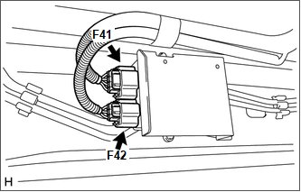

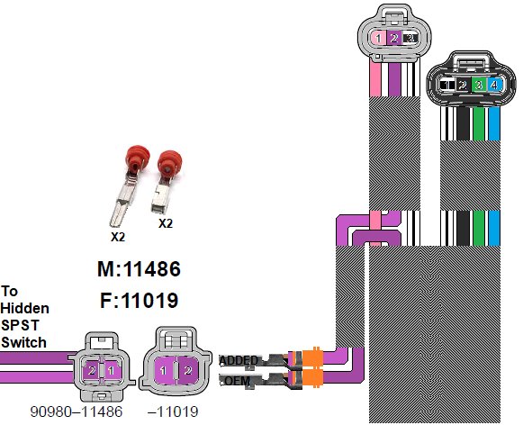

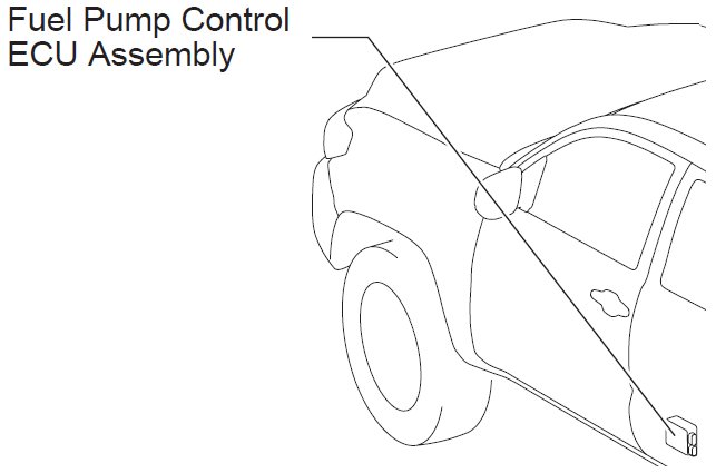

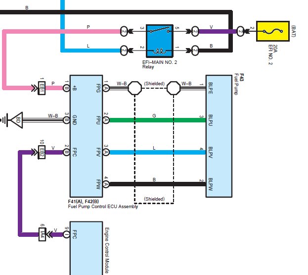

    Not sure about which wire but I'm sure someone on here has a wiring diagram. Maybe @caribe makaira can help.
    No this wouldn't damage anything. Just acts like it has no fuel

    caribe makaira
    caribe makaira Well-Known Member
    Feb 13, 2011
    #51121
    11,814
    Caribbean, Puerto Rico
    05 PreRunner TRD Offroad AutoTrans
    Hood Struts, My version Fogs always ON, Map & Overhead Light Mod,

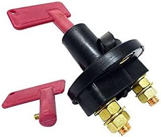

    In the 80s lots of people had these homemade coil kill switch...very simple and effective. Most people put the switch under the seat. For fun you can put a few similar switches that don't do anything, and in case someone actually finds the switch, they will get confused and thinks its a combination.
    https://performancedistributors.com/product/kill-switch/
    Good Luck my Friend.

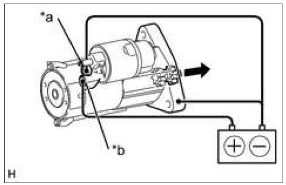

    The starter grounds to the engine block...
    Picture of testing starter function:

    so if you broke the ground to the solenoid it would still start?

    The switch you posted is meant for large gauge cable. The solenoid uses small gauge wire.

    i was mostly representing how easy it would be to disable the car by breaking a ground but in terms of swich size i would rather be able to handle more power vs the opposite.
