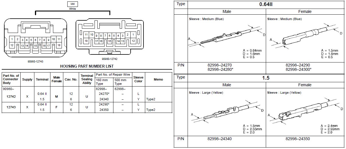

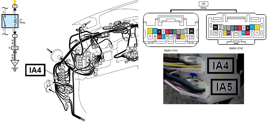

    I got that from the diagram, but the solenoid that pushes the gear to the flywheel is grounded separately. Take that out of the loop and you will basically free spin the starter.

    @auskip07
    Hidden cut off switch on IA4_10. No running wires from engine bay to cab.

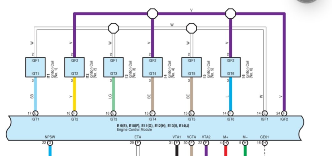

    Cutting coils is still an option on these engines. The only difference is that power now comes from the ECM... not the ignition switch like older single coil vehicles. You would just interrupt wires V and W on this harness.
