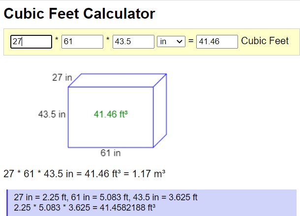

    So.. I need some help with math.
    The Pellet Pro (shown below) produces 36K BTUs and based on the size of the tank (275 gallons?) I'm wondering if adding 2 of these will be enough to sufficiently heat the tank enough to be able to smoke/cook things? I'd like to be able to get to the 400-450F range. I realize that there a ton of variables involved in this and there's not a standard formula for figuring these things out, but any insight would be appreciated. I's rather not invest the time/money if it's not going to get me the desired results.
    https://smokedaddyinc.com/product/new-pellet-pro-patriot-pellet-hopper-assembly-made-in-the-u-s-a/

    So.. answers.. though not exactly what I wanted to hear LOL Per Dennis at Smoke Daddy Inc the Pellet Pro is good for 36K BTU which is good for 10 cubic feet. Based on my measurements (and unable to account for the oval shape) the tank is 41.46 Cubic Feet which sounds like I'd have to run 4 units to adequately heat the unit (barring all other factors such as wind, air flow, temp, humidity etc). Obviously the cubic feet would be less due to the oval shape of the tank, but still warrant 4 units total.
    Also, per a fella at SMF, he advised 1 pound of charcoal briquettes = 9700 BTUs and his advice was to take 7.5 pound of charcoal (theoretically 72,750 BTUs - slightly over the same as two pellet Pro units) and see where the temp got to. While this is an excellent test (and cheap too) it may be a waste of time if I need now along the lines of 144,000 BTUs.
    The good news is that in the future, for anyone building these things.. there are now some answers without having to jump though all the hoops I have.
