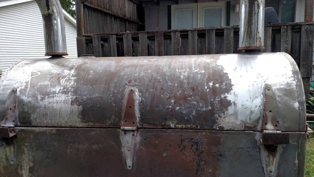

    Thank you for the input @Bigdaddy4760 !
    Finally making some headway on removing the old paint/primer!!

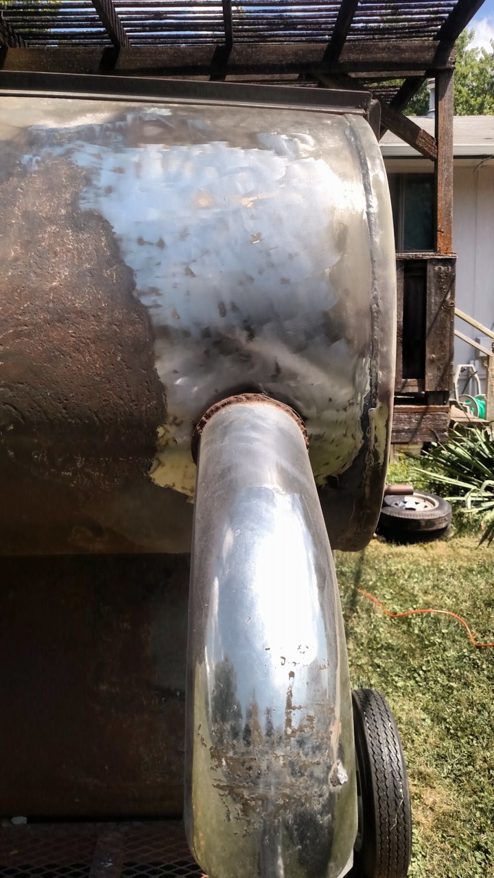

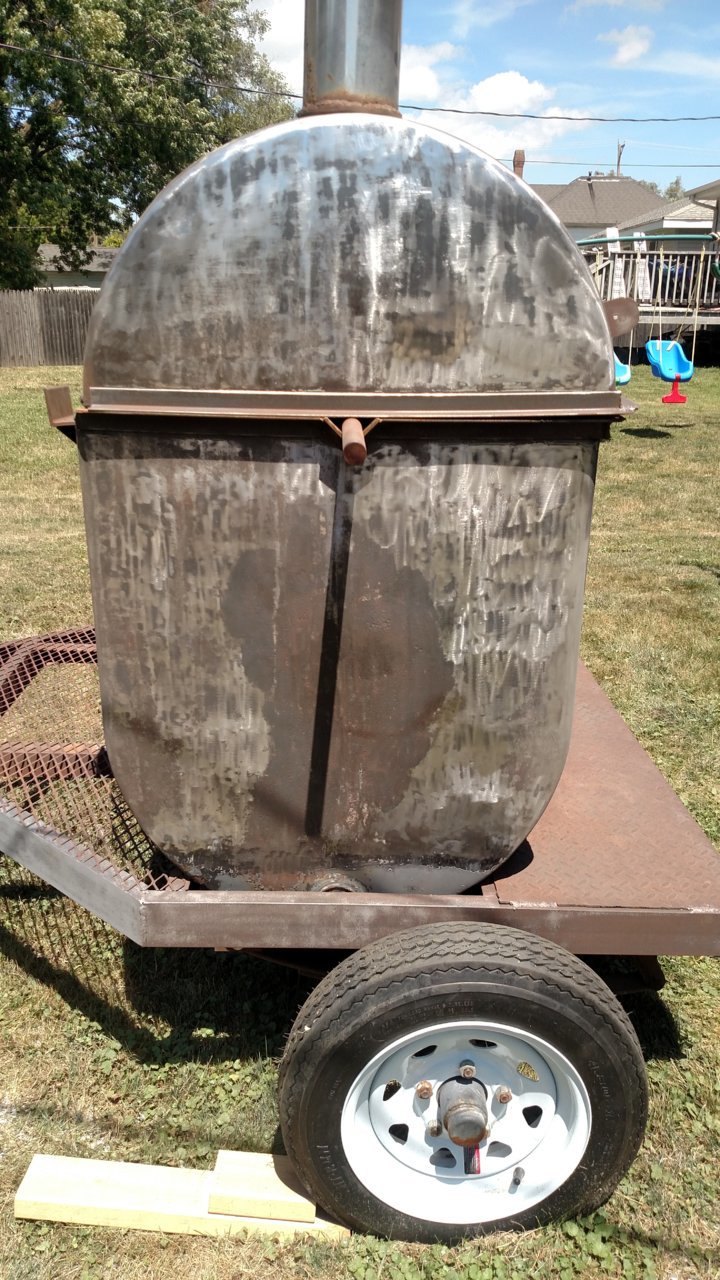

    Well the middle section is never gonna look like the outside of it.. at some point the previous owner must have has a large fire inside and the metal super heated...oh well.. progress is being made . Slowly.. but it's gonna get there one of these days haha!

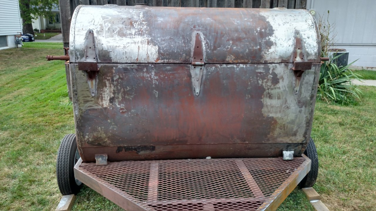

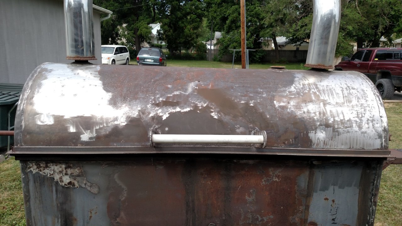

    I have a small sandblaster unit .. nothing I have tried so far has touched the old paint/primer which is why i resorted to using a grinder with some flap disc wheels.. once I get all the paint off I will hit it again with the sand blaster and remove the surface rust.
    It's making is a slow and tedious process especially in this heat/humidity so I've only been working on it an hour or two at a time. Currently in a heat index of 101F

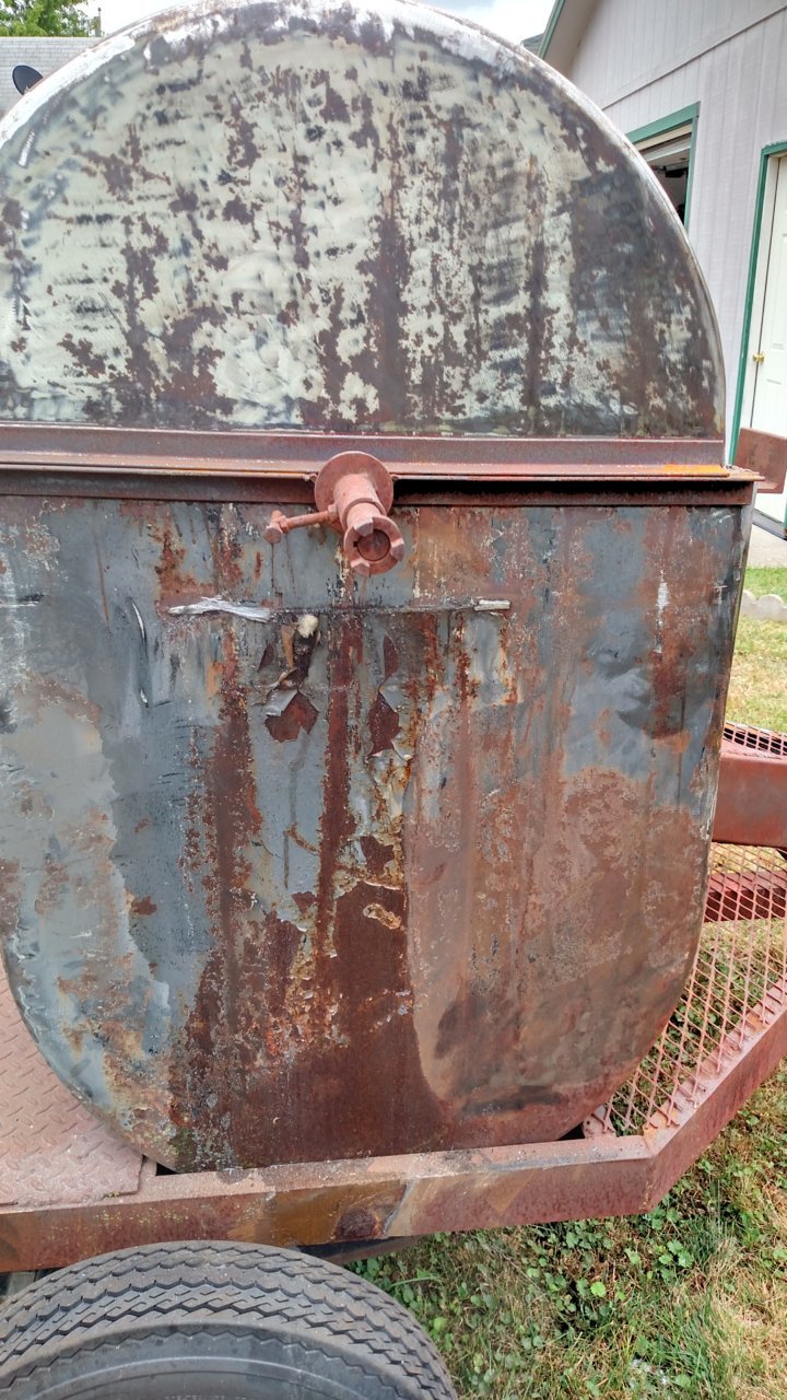

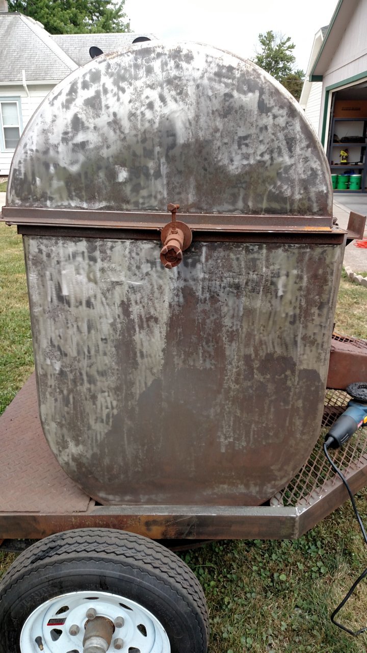

    Switched from a flap wheel to a pumice type stripping wheel on the grinder and made some great progress today before the heat/humidity got too bad.

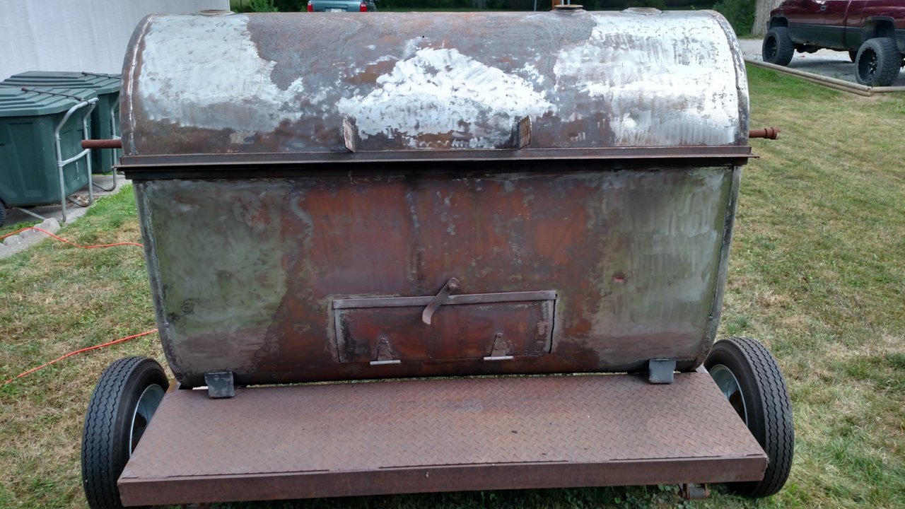

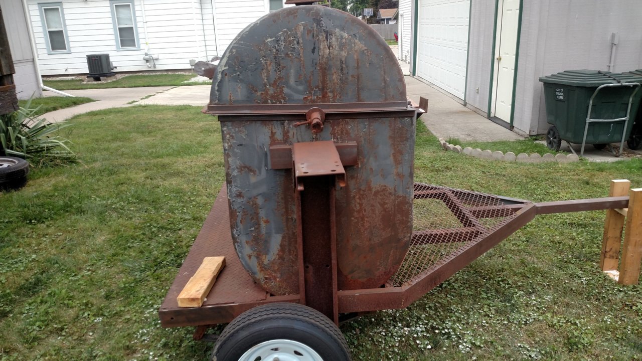

    Motor mount there
    Motor mount removed.
    You can see the way it was mounted was just trapping moisture and dirt.
    PRO TIP: A spray bottle with soapy water keeps the sawzall blade lubricated and cooler.
    Cleaned up with the stripping wheel

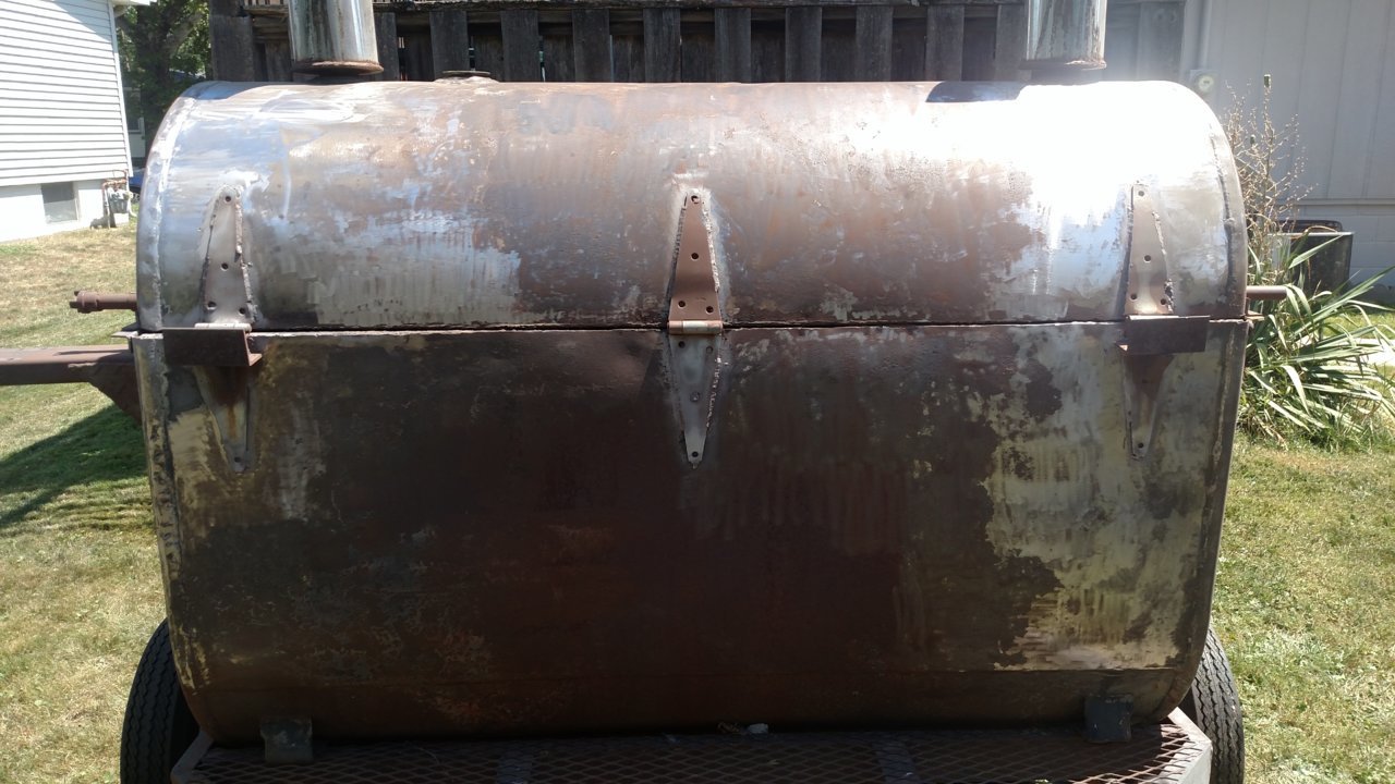

    The rest of it about 95% complete as far as stripping the old paint and primer and rust.
