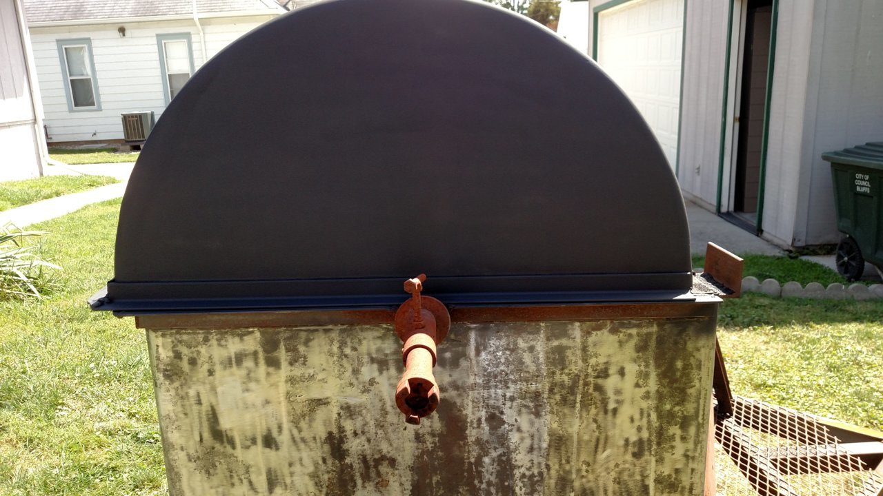

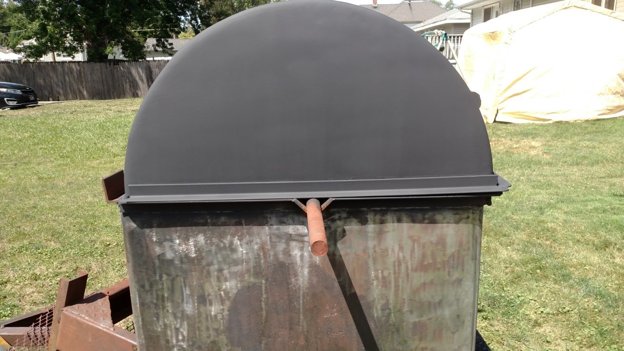

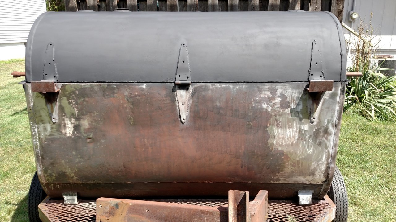

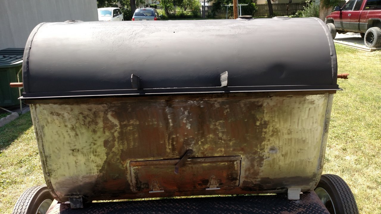

    Looking great!! You shooting that high heat paint straight or thinning it? HVLP gun?

    Actually.. since I can get the same in quarts and rattle cans.. I shot the lid with a rattle can just to see what it does... Haha it might lay down better with a HVLP gun... Still have more work to do before I shoot the rest of it.

    When I get home I send ya a link to a cheap 4.0 HVLP gun will make your life so much easier

    You got a air compressor

    I do.. but it's only a 20 gallon rated at 4cfm @ 90 psi.. so I may not be able to use a HVLP gun.

    Let me look at my charts. Bet ya can. I set my gun regulators for high heat black at about 50psi but need to go double check that.
    I put multiple coats on.

    What brand of paint you using? This was the Rust-Oleum High Heat for Grills

    That’s good stuff. Can’t hardly beat it. I like to shoot my stuff on a hot day. Light multiple coats it will last longer.

    The parts I sprayed today dried pretty quickly in the afternoon sun... I feel multiple coats , while not perfect, will be looking good!

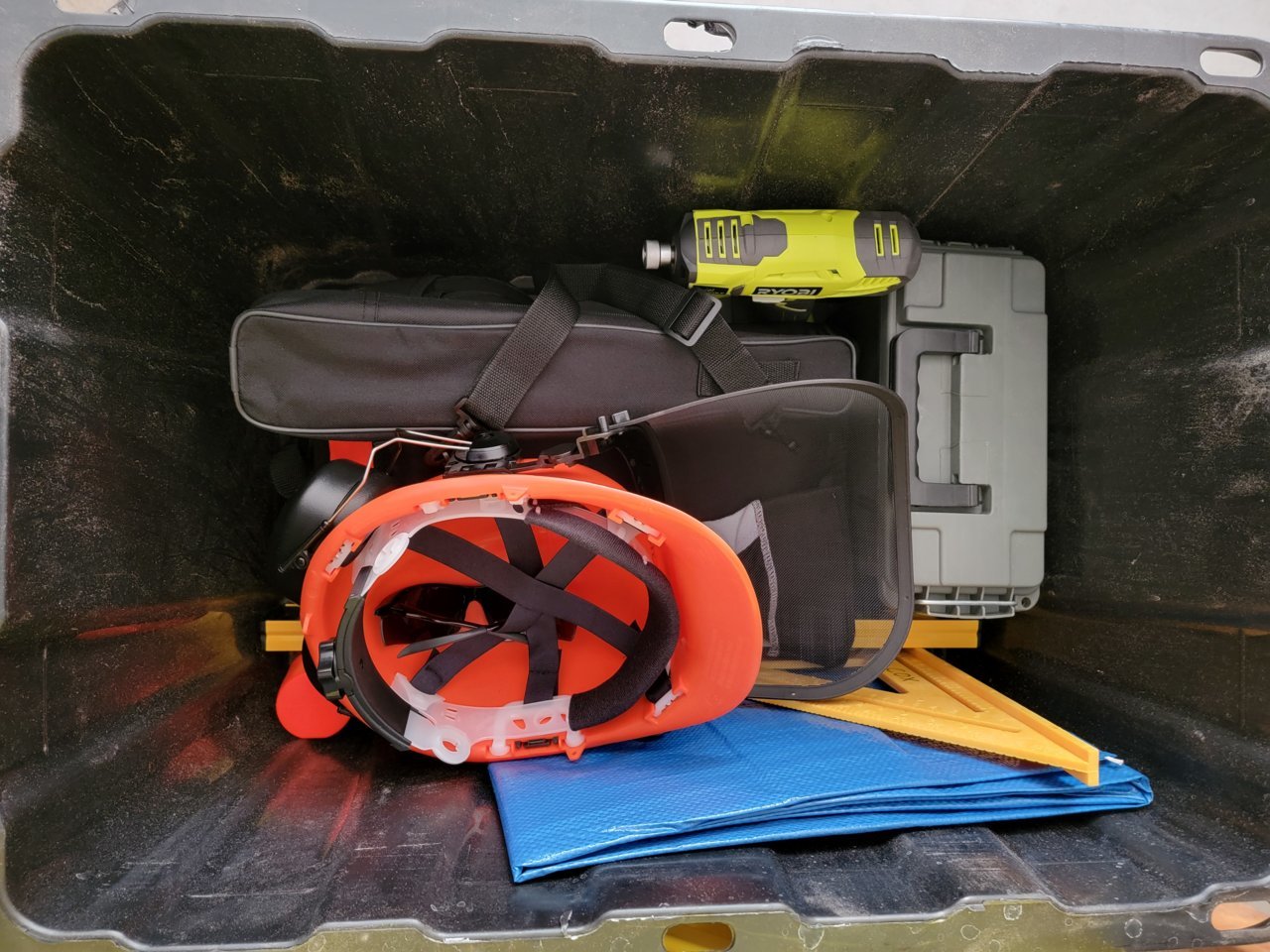

    I put together a large tote to carry all the things that go with chainsaw milling and posted this in another thread so I'll duplicate it here for anyone with questions...
    The tote so far contains in no particular order
    Spare Ripping Chain
    3 foot level
    12 inch speed square
    Wood marking crayons
    Wrench for saw
    Ratcheting wrench for mill adjustments
    Impact driver for screwing down ladder
    Screws in various lengths
    Bar Oil
    Canned fuel
    Chaps
    Safety helmet with integrated hearing protection and face shield
    Gloves
    Hand held metal detector
    Tarp
    Moisture meter
    Ear plugs
    Tape measure
    Tinted Safety glasses
    Dead blow hammer
    Wedges
    Knee pads
    Paracord
    Small plastic ammo box to store all the small things inside the tote.
    All the tools I just picked up cheap versions at Harbor Freight so I don't have to take anything out of my tool box.
    This is an older picture and things were added after this but you get the idea.
