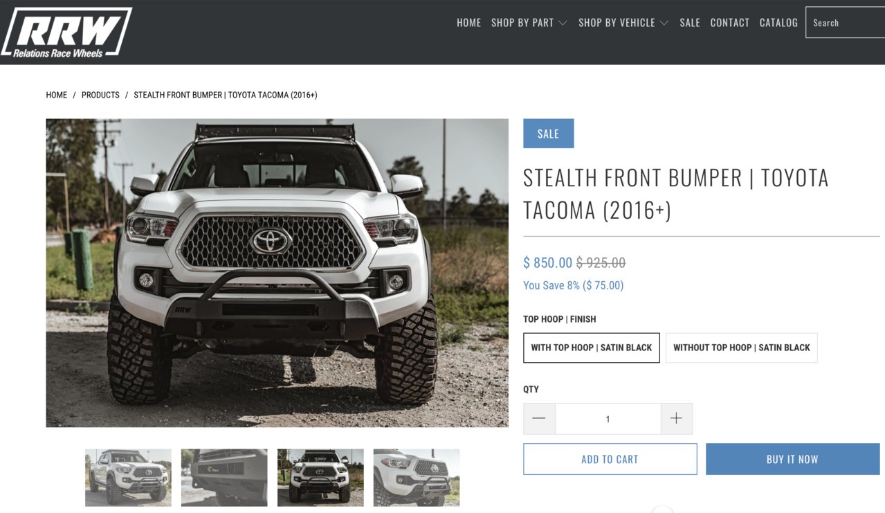

    If you're looking, this is pretty minimal, "stealth" bumpers was the search. Under a $1000 which is nice.

    Truck house looks to be using the SSO full plate bumper without the hoop, found here :thumbsup:

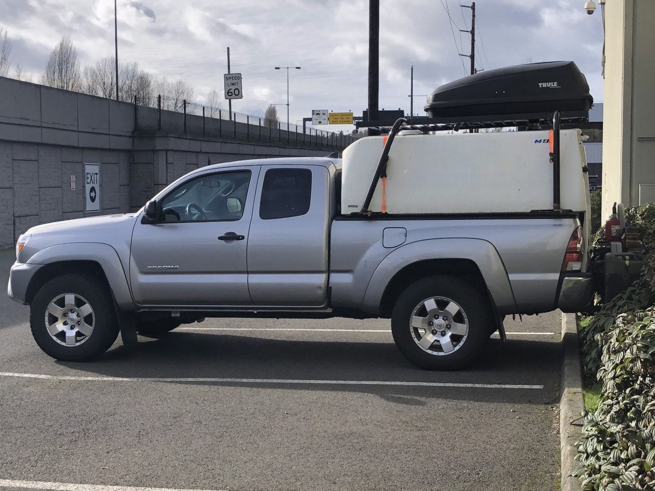

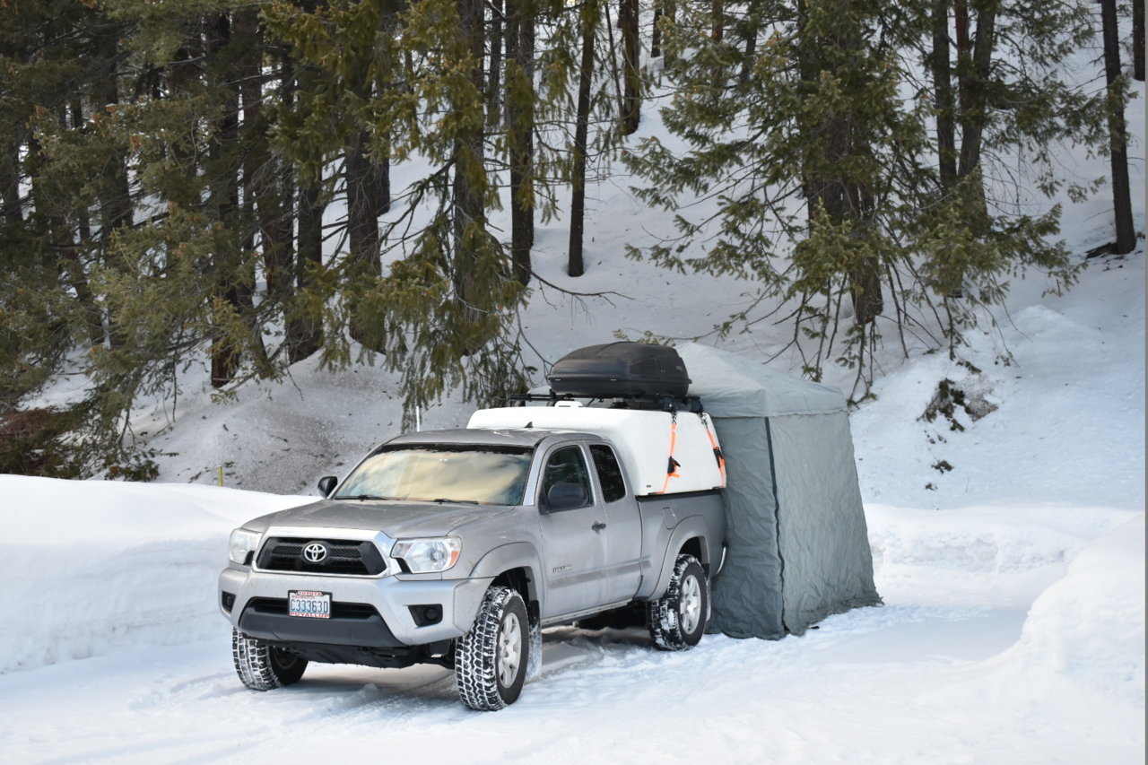

    Previous camping solution in winter garb - the diesel heater is in the storage box mounted on top and is removable for summer camping.

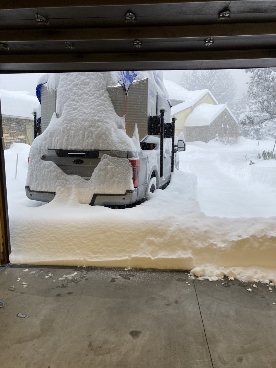

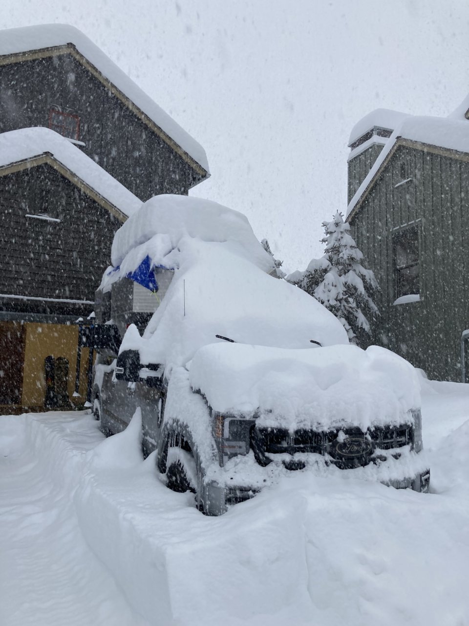

    Holy COW!!! that snow looks AMAZING - you're gonna be able to give everyone decent feedback on the Kimbo's snow performance for sure huh?

    Thanks for the link - love that bumper (without the bull bar) but that'll have to wait quite a while LOL.

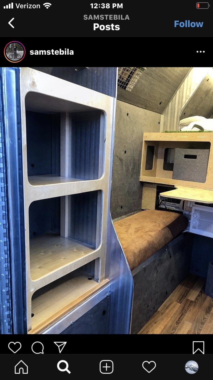

    yes, but planning to put the fridge right up against the structural wall where the wet clothes hanger is. The front opening door will allow for shelving above the fridge (where I’ll store the goalzero).

    I had this picture for awhile for a similar idea to help visualize. Hope this helps.
