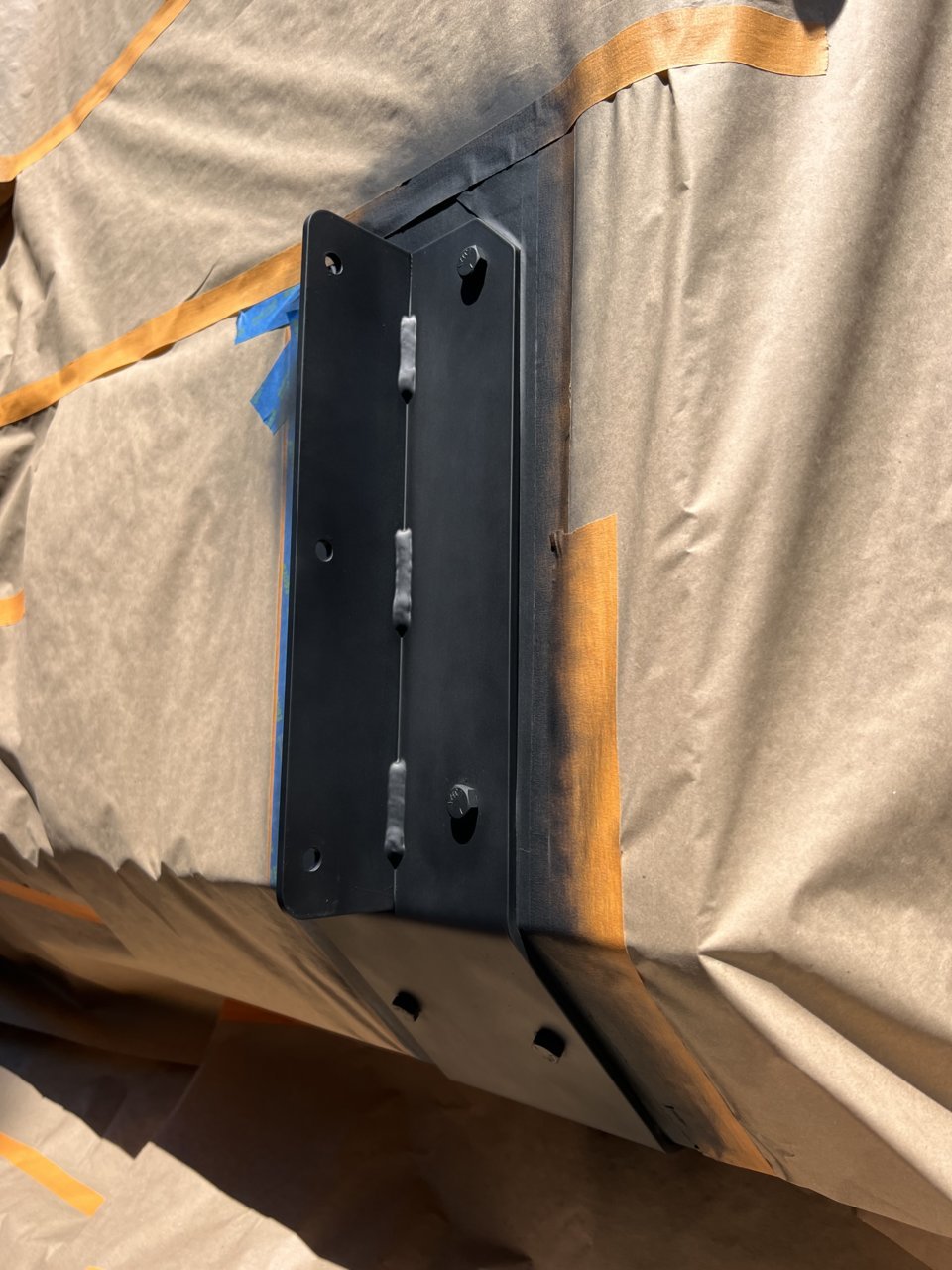

    I sanded, primed and painted the camper braces. I used simple sanding pads maybe 120 grit, then a rust primer and a rust oleum gloss enamel. I’m happy with the results, I’ll let you know if they start rusting up again.

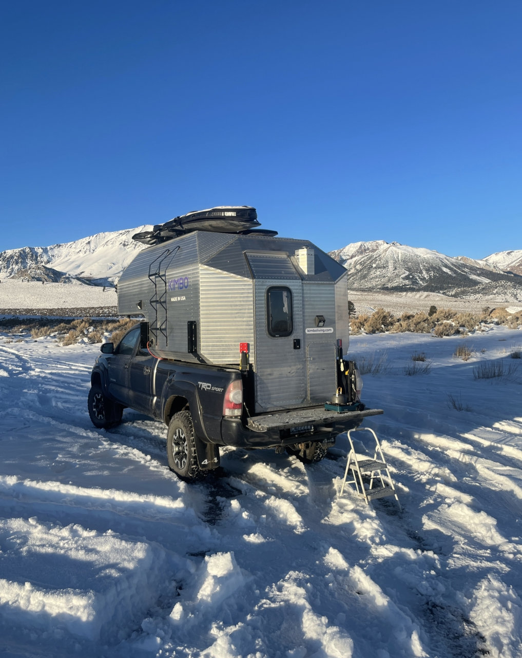

    Photo tax from late November In the Eastern Sierras.
    After a year and a half, the remote to the lights has kicked the bucket after being dropped one too many times. Has anyone replaced the remote without having to rewire the entire light strip?
    Not sure if this is a major bummer or just a matter of buying another remote of the same kind.
    Cheers!

    Ya, my braces look wrecked...gotta touch them up soon - glad to know I'm not the only one.
    nelsonator[QUOTED] likes this.

    You guys need to slow down these space pods on re-entry or use some high temp paint. Mine seem fine. Curious if it was a powder coating issue for a few.
    I on the other hand, had some major salt or mag chloride/grime build up over the past winters here in Colorado on the back. Took some elbow grease, but a fine sand pad and some aluminum polish got it back to shiny. Kimbo stripes are gone but it’s clean.
