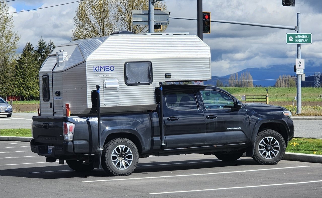

    This was posted recently in the WA/Oregon truck spotting thread. Found up in Mt. Vernon. He needs some springs or bags by the looks of it. YOHB? New camper, perhaps?

    This is an early Kimbo that was modded within an inch of its life and then put on the market within a year.

    My DCLB has a payload of 945lbs. No matter what I do to upgrade the suspension that plate in the door jam will never change

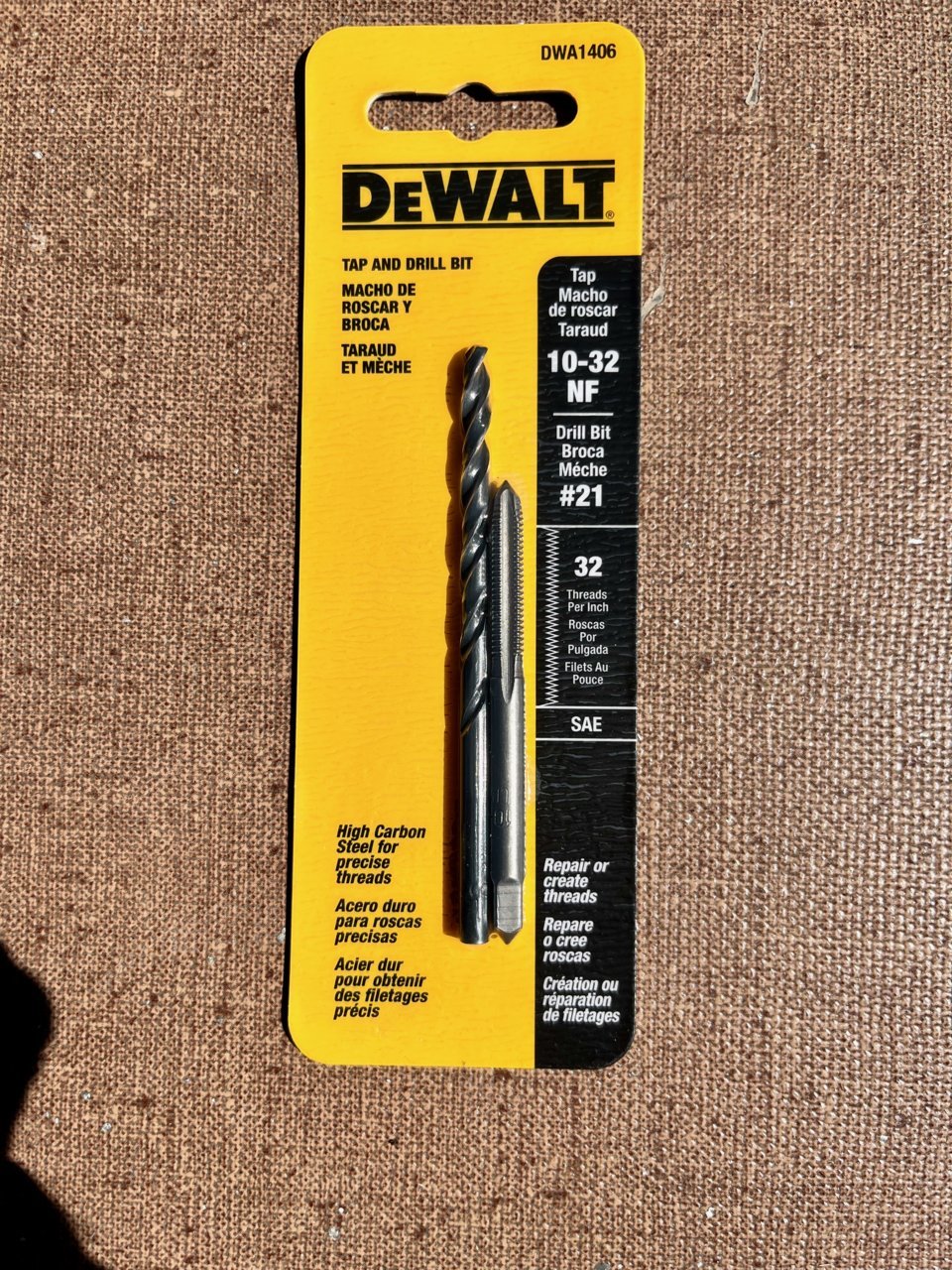

    Picked up a 10-32 tap to help clean out some of the old Thread Compound of my Rivnuts (not sure what the correct fitting are called) I didn't need to drill any out beforehand but some have loosened and I'll have to be reseal those on the outside . Worked great, hopefully the thread compound issues are being worked out .

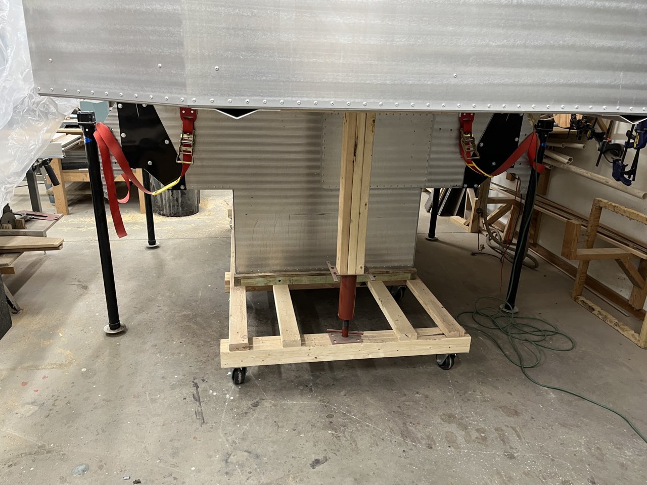

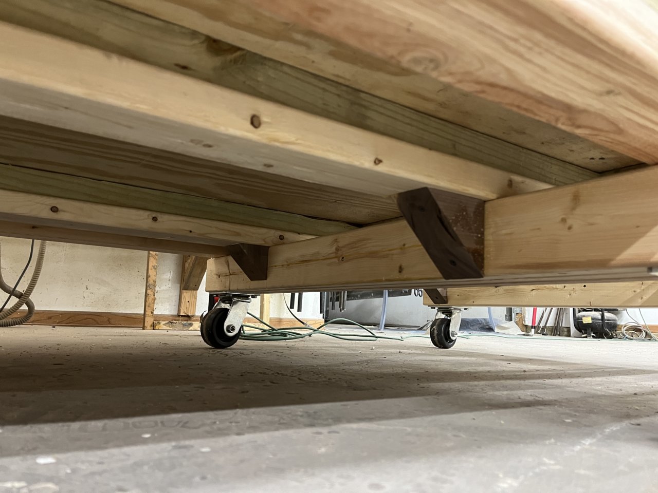

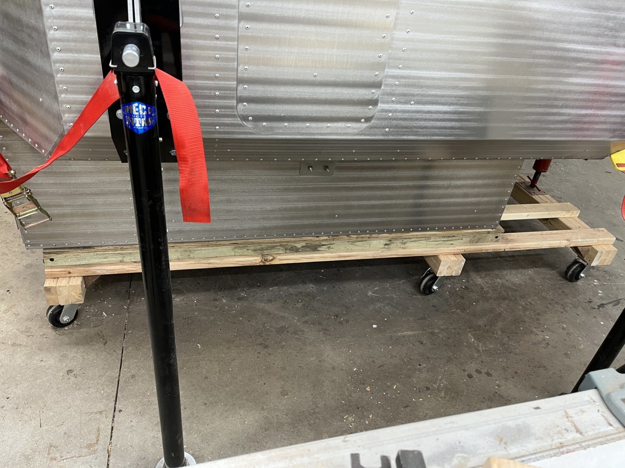

    I made a simple stand/support for mine. It basically keeps is stable when off the truck and at a height that make it quick to load so I don't have to spend time raising and lowering it. I just used stacked pallets with casters underneath. I still support the front end with a stand too.

    Post a pic?

    2x4’s, 4”-400 lb. casters

    That looks pretty darn cool. Yes, I did talk to the shop but they sent me the metal dolly plans. Thanks everyone...I appreciate your comments on here.
