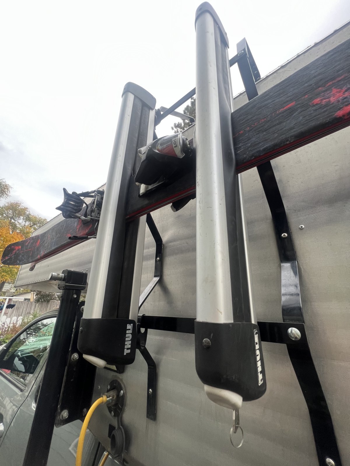

    Hey Voltron - thanks so much for the hook idea. I just tried rigging up a rack (I also found for $40 on Craigslist!) and was having a time trying to get skis in there by myself. What are you using for the attachment from the rack to the ladder? The rack I bought came with clamps that fit the Subaru bars but they’re obviously too big for the ladder and it will move around when driving.
    Thanks for any thoughts you have!

    I ended up using hose clamps from a hardware store and wrapped them around the ladder and the ski rack themselves. In all honesty, this is will be my first season using this method, but it seems pretty secure. I took a test drive with my skis in the rack and it seemed to hold up just fine.

    So I had some left over silicone sheets from the wood stove install and just used some pieces as spacers.
