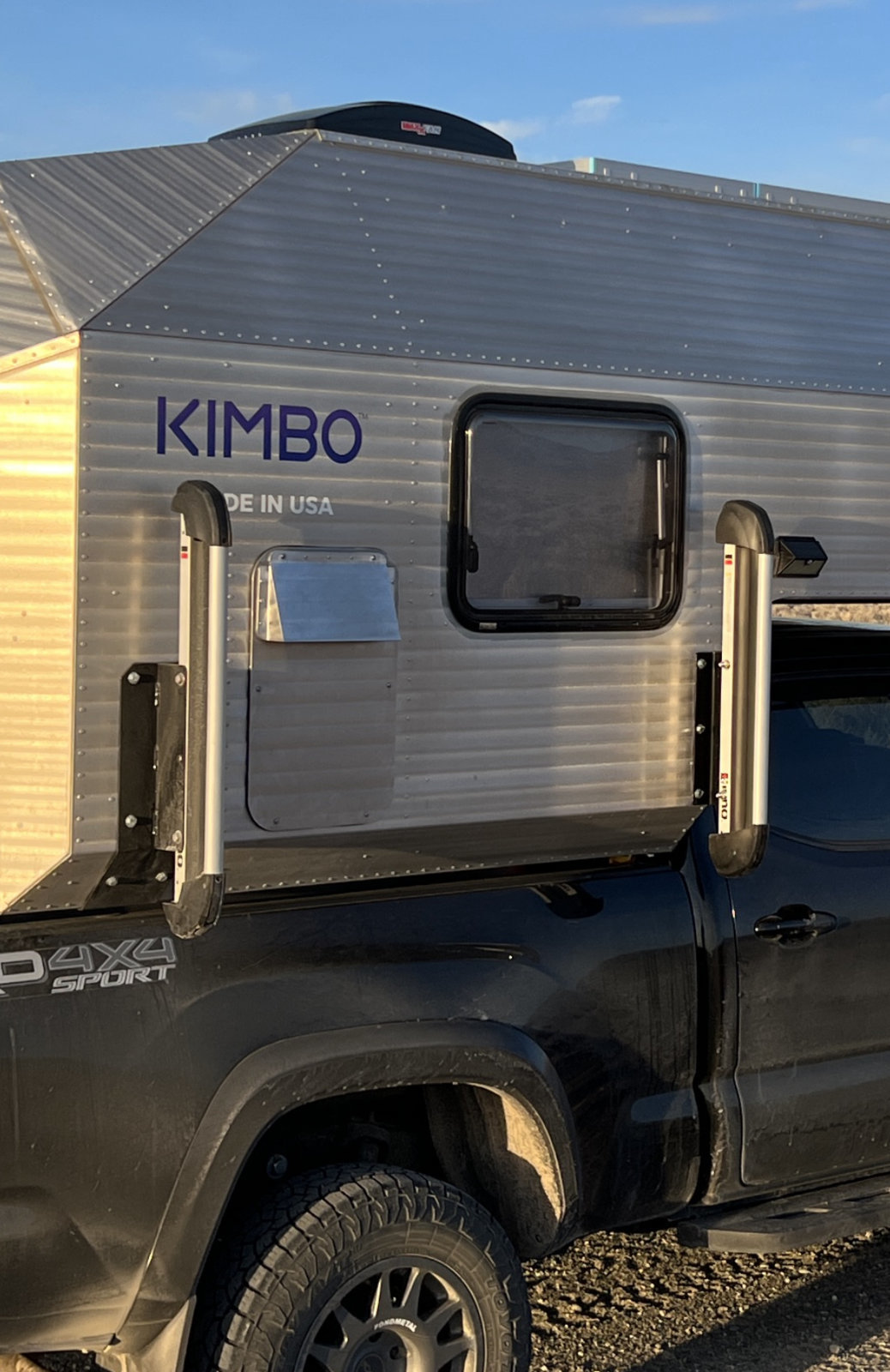

    Figured I'd share my setup. It allows you to maintain use of the ladder, which is important for us when it dumps in the Sierras (heavy snow out here). All it required was some stainless steel hardware, and drilling holes into the ski racks. we also cut and drilled a piece of aluminum stock to fit in between the gap of the forward jack mount.this can easily fit two sets of skis while also allowing use of the window.

    Well that worked out great. Nice job!

    That’s a smart move to keep access to your ladder. When I wanna clear the snow off, I channel my inner hillbilly and start doing donuts while shouting yeehaw.
