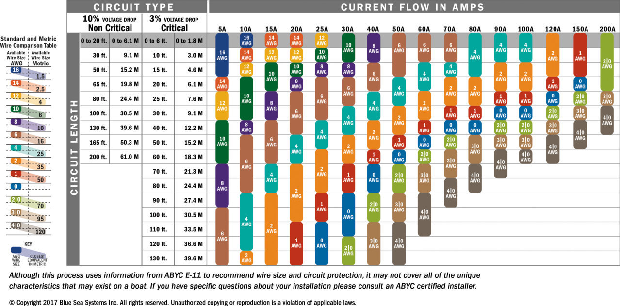

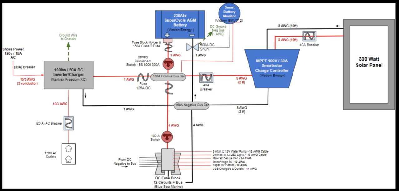

    Finally settled on a diagram to base my system off of with some tweaks. Now to fit it all in like a puzzle. Plugged in is nice right now since it’s 3° outside. Toasty inside. Added some helpful charts.

    :thumbsup: Might consider getting something like this for your wall outlet. Also, the RTS if you don't have it already. FWIW, I installed something like this for the USB charger

    Thanks! The white cord coming out of the wall powers a multi port box but I wish there was a 3.0 quick charge in there. The EPEVER came with everything. Adding this shunt too, it's is the same as the Renogy one.

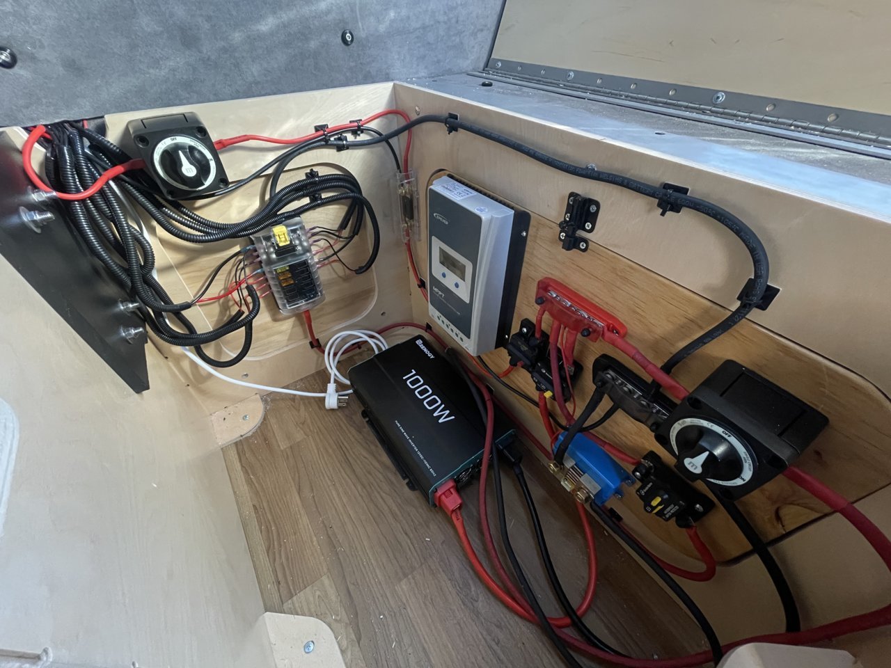

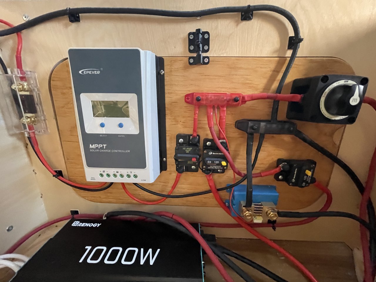

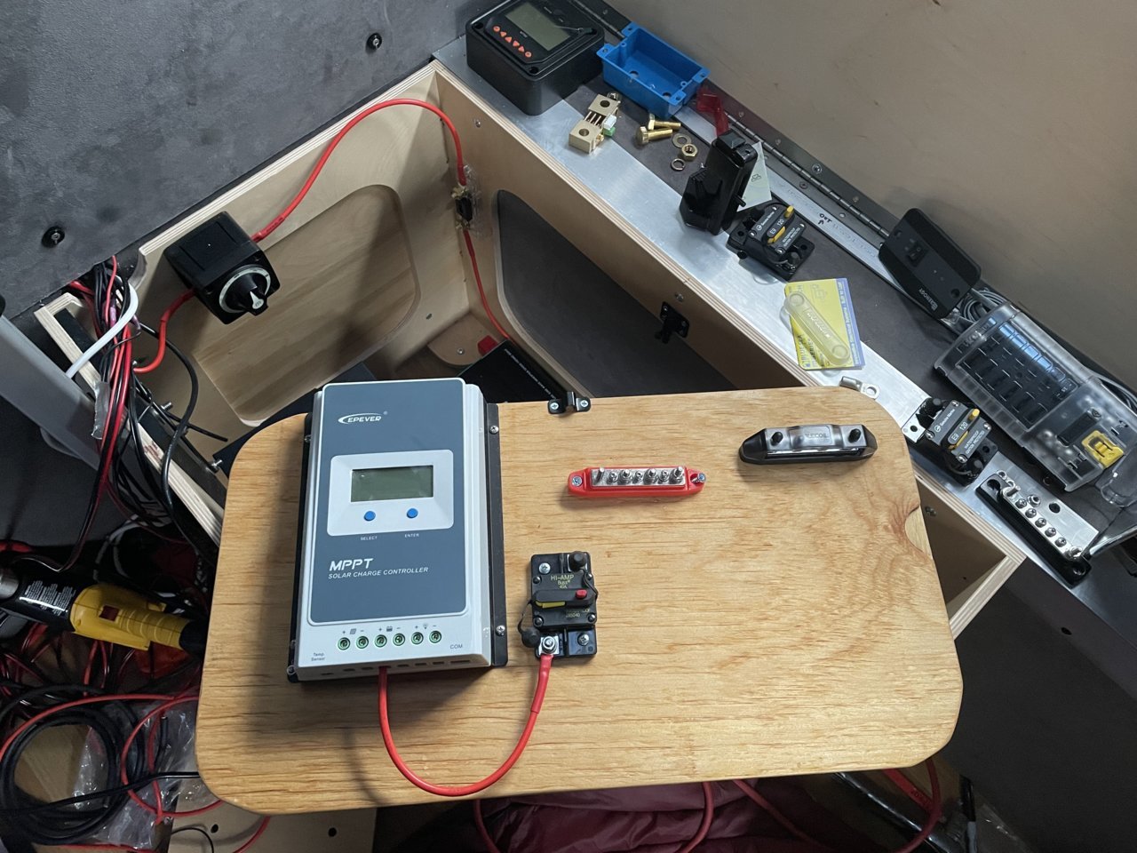

    Electrical done. Just need to install the solar panels and it will be self sustaining. Will be adding a wooden base plate for the inverter to keep it from moving later.

    That is a well thought out system for sure! Is that filler panel with the barrel latch removable?
  13. Feb 16, 2021 at 9:32 AM
    #213
    Voltron4x4
    Voltron4x4 [OP] Well-Known Member
    May 2, 2017
    #217975
    2,067
    Denver, Colorado
    2014 Black Trail Limo
    This and that...
    Thanks! It took a lot of research but really happy with it. Looking forward to seeing how it preforms with the panels attached. When installing it was really difficult to picture where everything should fit. So I just started with the positive solar and installed the parts as I worked down the chain. Getting the perfect lengths for the shorter cables was challenging with the thick gauge but worked out well. Will add the inverter remote and shunt/batter monitor screen when the kitchen is built.
    Yeah the filler panel is removable which made the install a little easier. My jigsaw skills do need some practice though. You just need to disconnect a couple of cables to have the slack to remove again.

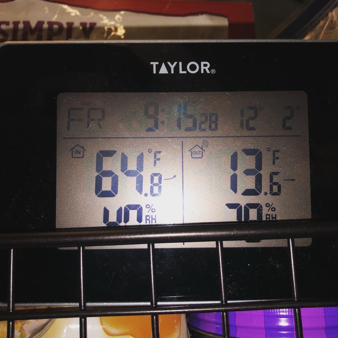

    OK!! had our first cold nights in the Kimbo and we figured it'd be good to pass along what we've learned so far.
    1. Aluminum, if you didn't know already (LOL) is a terrific conductor - so any exposed aluminum was quick to be very cold. Plans for skinning/covering/insulating those areas are in the works...more to come on that.
