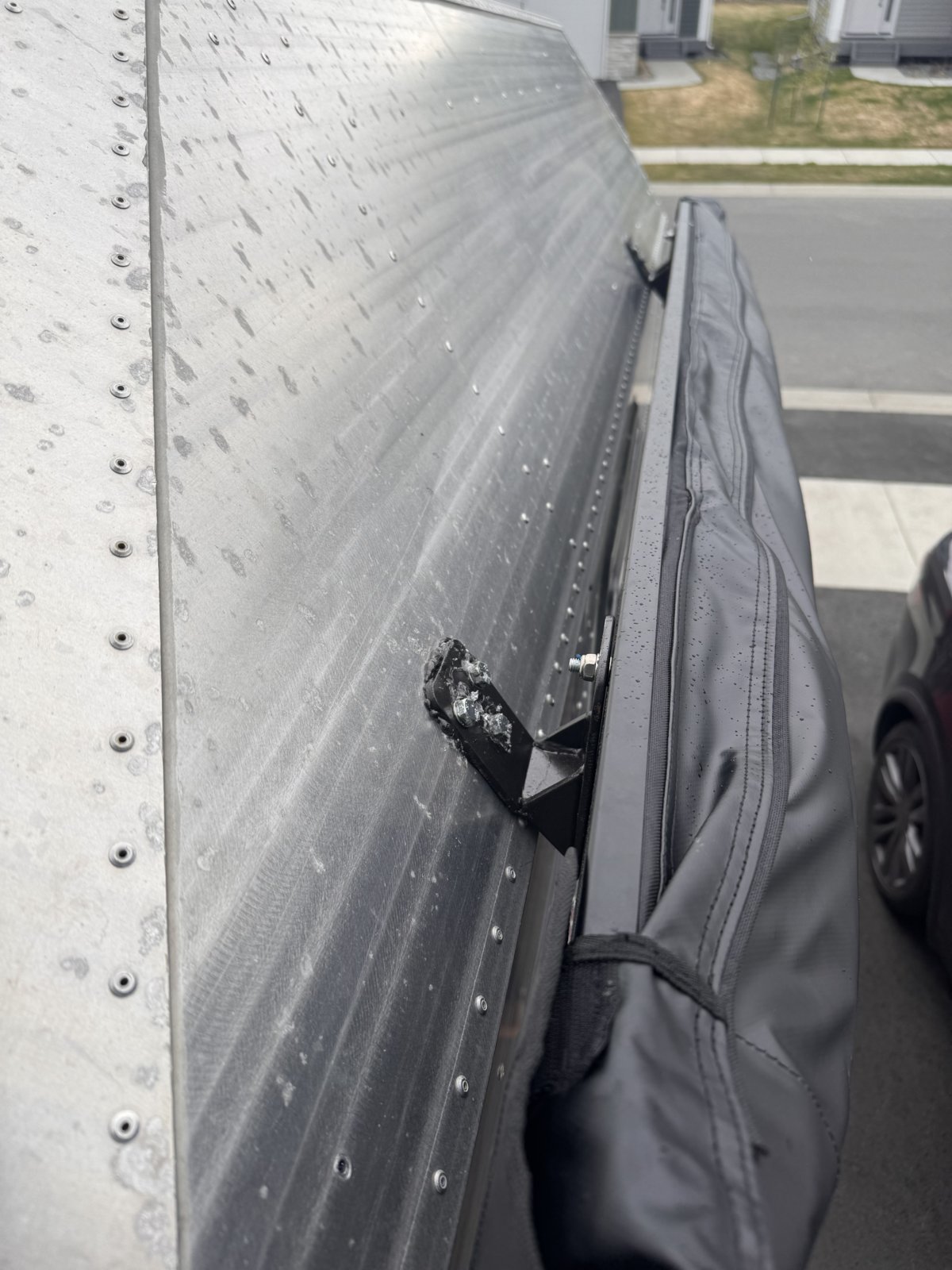

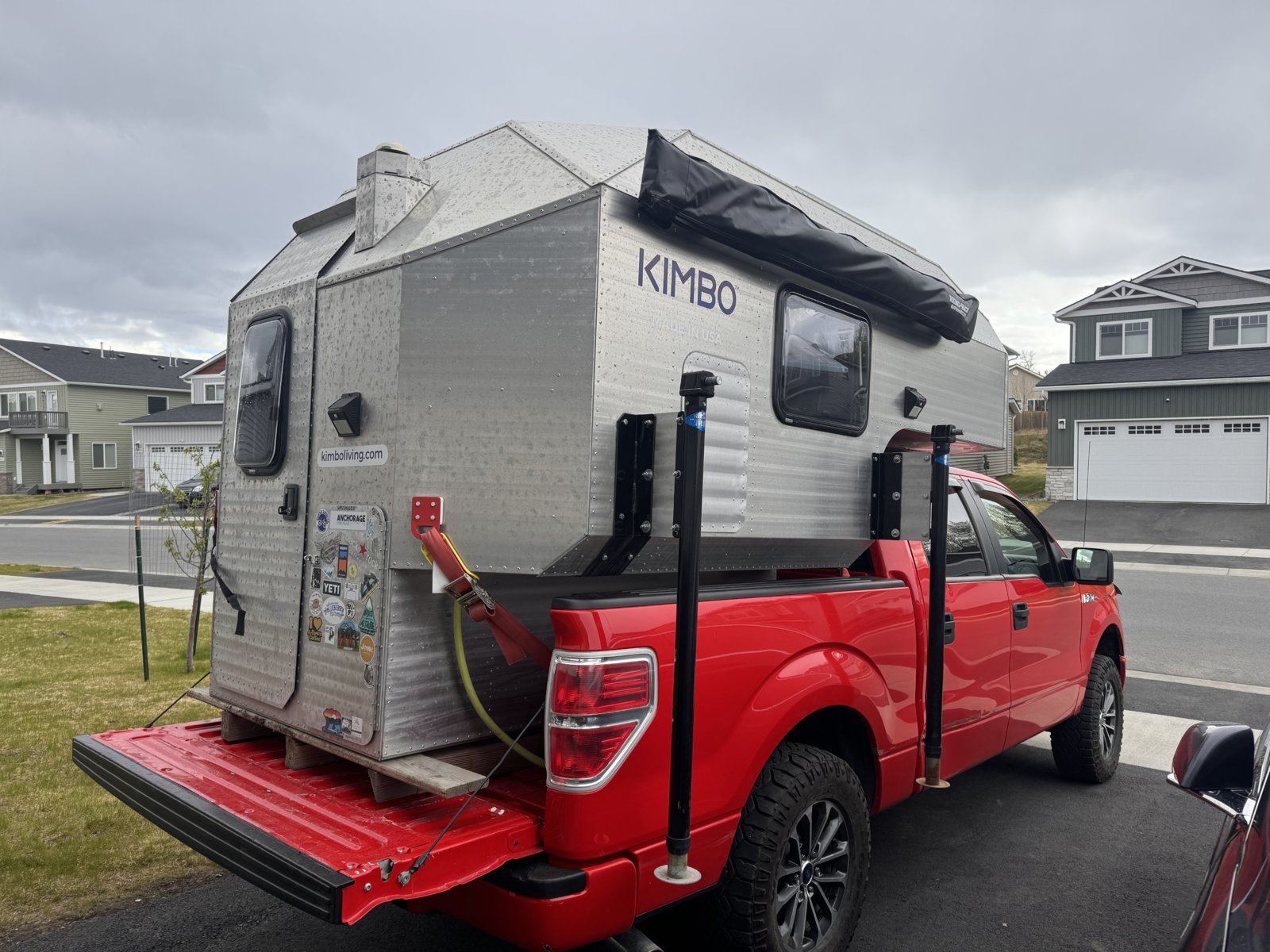

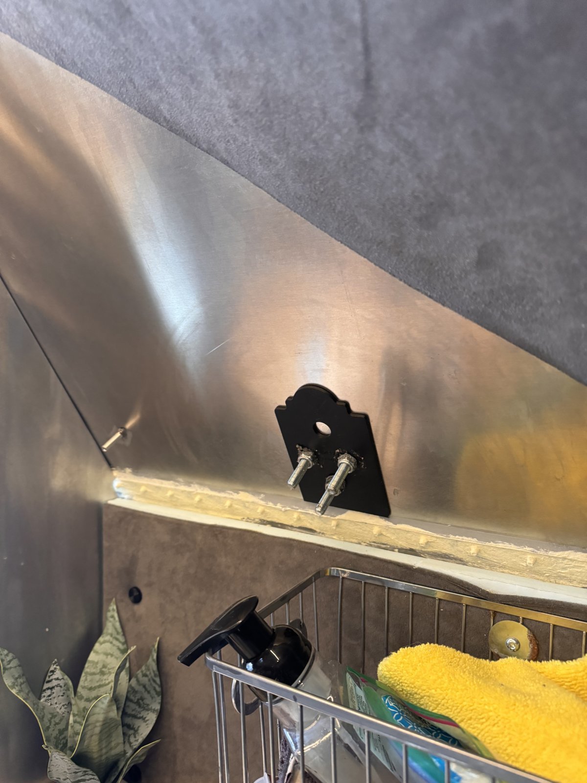

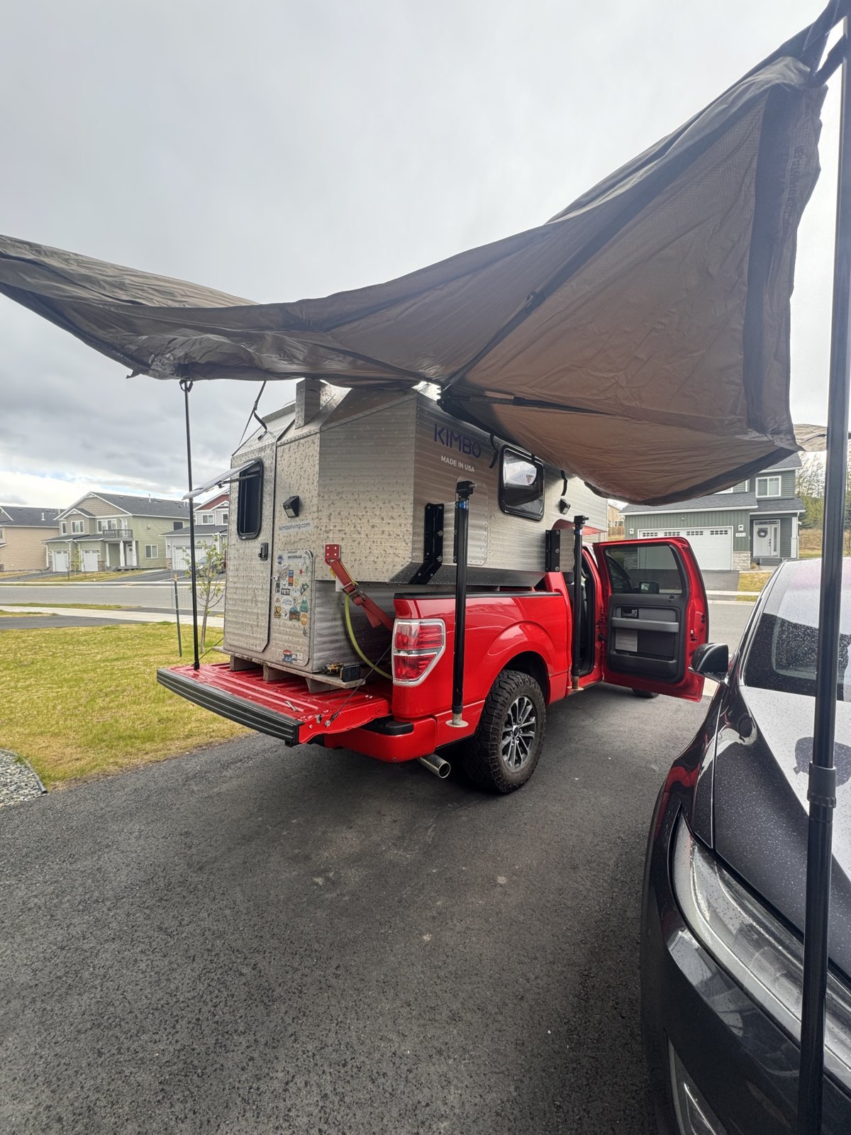

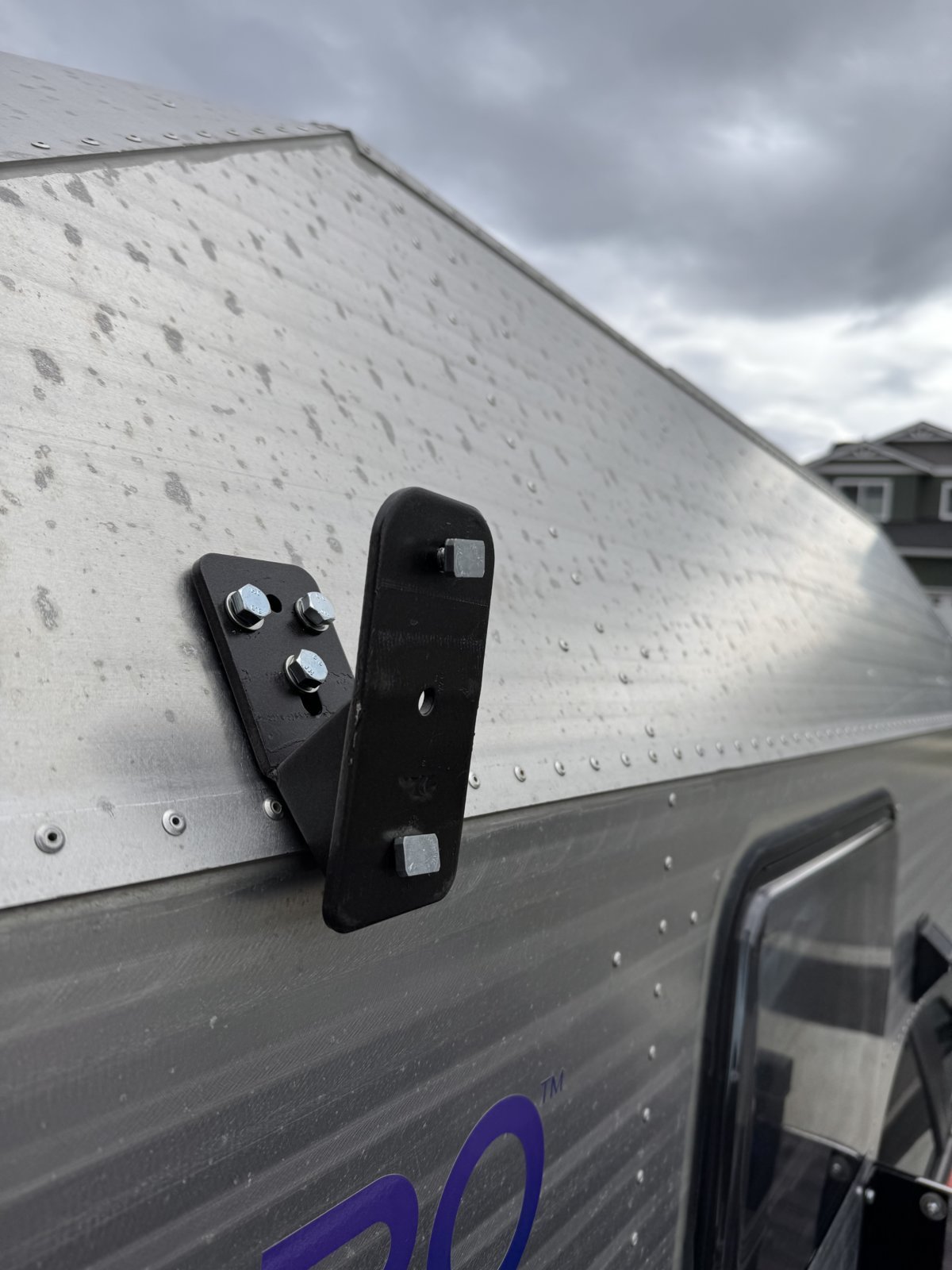

    I just finished installation of my Batwing Compact. It was a few day process but I’m 90% happy with the outcome!
    Voltron4x4[OP] likes this.
  6. May 22, 2024 at 6:44 PM
    #2286
    Arctictomcat
    Arctictomcat Member
    Jun 7, 2021
    #367937
    9
    Tom
    Tundr
    Kimbo camper

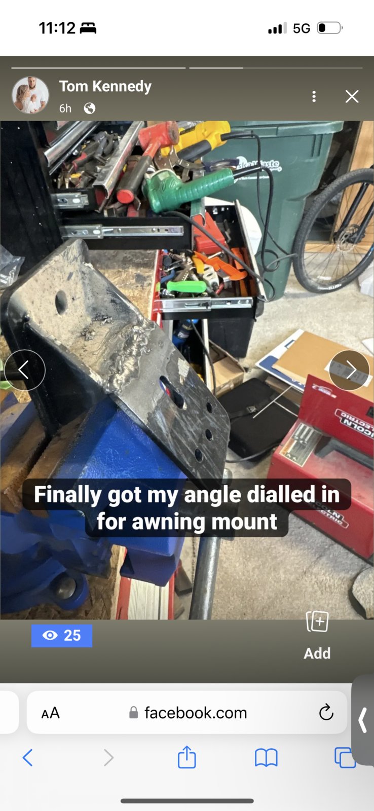

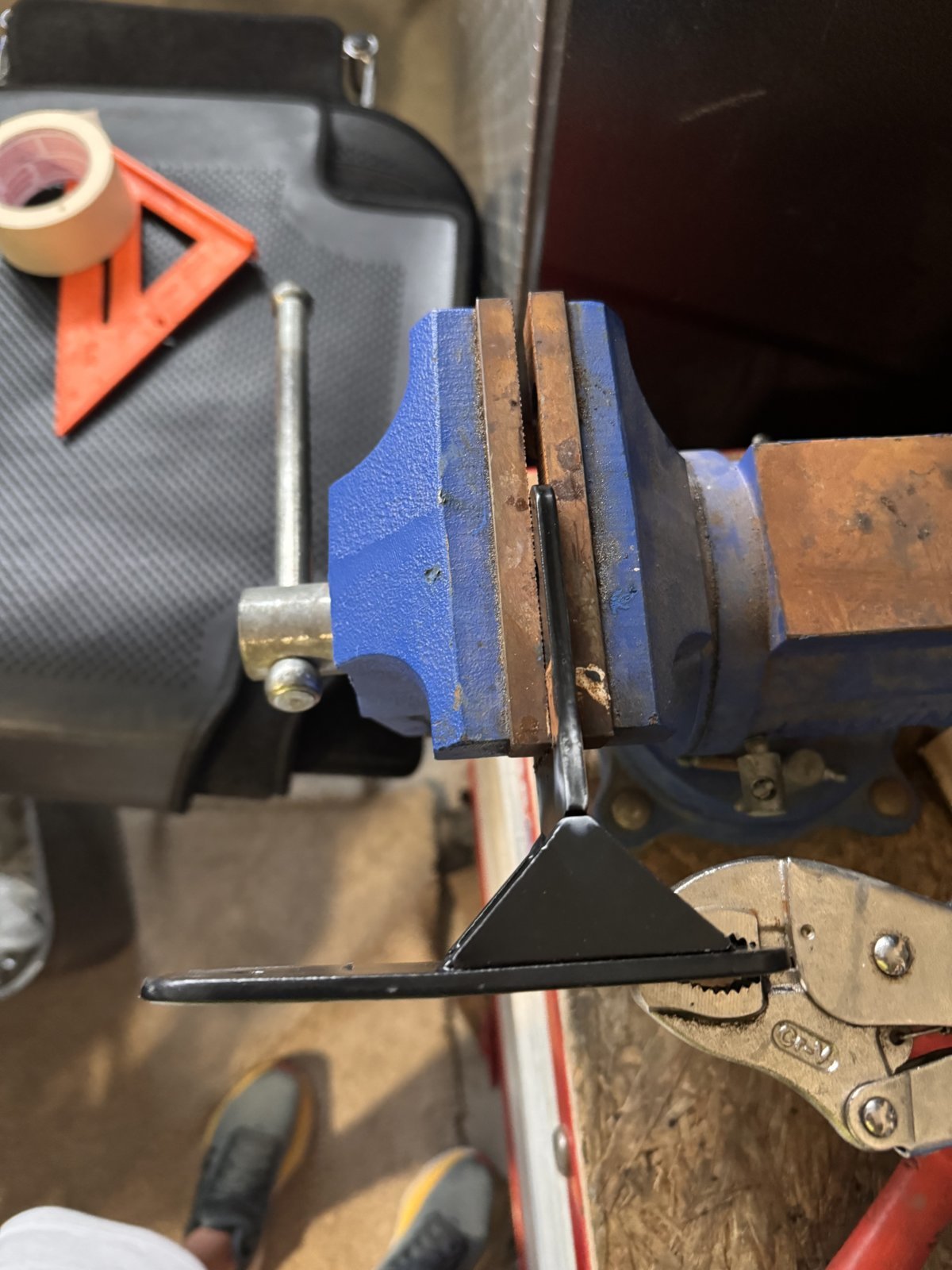

    First off yes I’m sorry it’s on a Ford right now while my Yota is being rented out.
    I had quite a few challenges.
    1. Had to cut and re-weld the main brackets so the awning would sit at 90° and not an angle. After multiple attempts at heating and bending, I gave up and cut then re-welded.
    2. Some of my screws for the interior paneling were seized. I had to pop the rivets out . Ended up just JB welding then back in place temporarily.
    3. The stove is a bit in the way of the last section of awning so I’ll have to take it down to adjust.
    I would do it again, it seems to be VERY secure and I don’t off-road anymore so no worries about it ripping off.
    any questions?

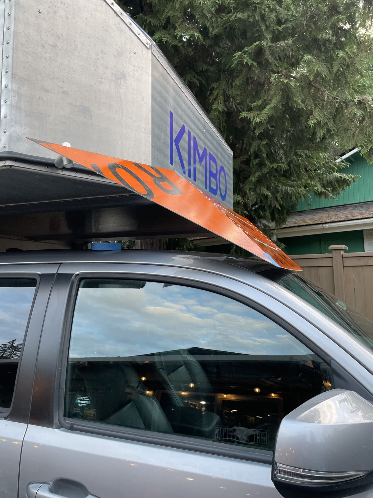

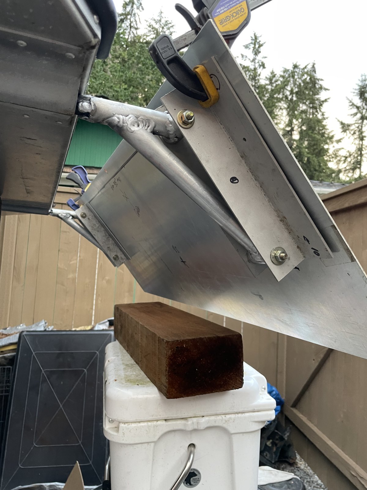

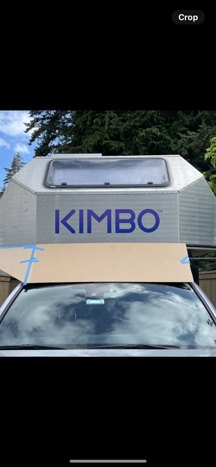

    IMG_5607.png IMG_5609.jpg IMG_5632.jpg Had some time last weekend to mock up the air dam. This week I got the tubes cut and welded up for the struts, machined bushings, pop-riveted the reinforcements and mounting. First pic is mock up with card board - was planning to mount the air dam to the roof at the rack mounting points but didn’t want to tear into the truck and open the possibility of leaks at this point. Second pic is after using and old eyecrometer and bunch of guesstimates because I had the Kimbo off and changed the mounting location to the Kimbo. Was real worried all the welding and work on the struts would be wasted but it ended up working out better than I could have hoped. Last pic is all riveted and testing the possibility of wings to match up with the Kimbo angles better. I want to get it out on the freeway to actually see if it’ll be stable before putting any additional work into it.
