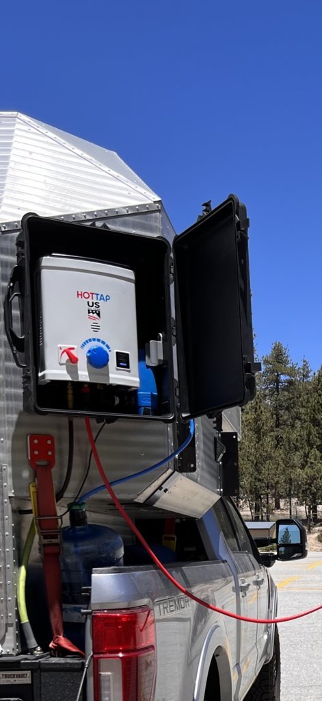

    Do you still have this shower set up? Any chance you can show a few more pictures thanks. I’m trying build something identical but want to leave as many hoses attached as I can

    Hi aarcarr,
    Here is what I found on my phone. I still have the setup and it works quite well. I used the mounting bracket that Joolca sells with their setup so that if the heating unit stops working I can swap out the heater without replacing the bracket which is what mounts to the Kimbo. The heater is located in the lower left of the pelican box and then I bought some plumbing elbows and got the pump to fit next to it, very tight fit. I can keep the hoses inside the pelican box I mounted. I cut a rectangle out of the back of the pelican box so the Joolca bracket mounted directly to the Kimbo exoskeleton. I'm able to fit 5 gallon water jugs under the shower. The whole thing works great. If I am being picky I wish the Joolca pump was a bit more powerful, but its more than sufficient for a great hot shower.
