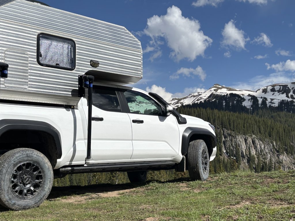

    Still working out the details on putting my Kimbo on my 2025 Tacoma (6' bed). But I'm close to being finished.
    -Relocated the shark fin antenna to the drivers side dash (through the headliner and A-Pillar)
    -Used 2 pieces of 1" foam board (similar foam that used with my Tundra) to raise the Kimbo. This along with my OEM bed mat raises the Kimbo to clear the top of the bed rails by about 3/4". It clears the top of the cab by about 2-2-1/2".
    -Moved the front ratchet mounts 2-1/2" outboard. This gets the ratchet buckle out between the cab and Kimbo. MUCH easier to tighten it down now.
    I don't "crank" down on my straps, there're tight/snug and I haven't found my camper moving around any. My Kimbo did move around a bit in the Tundra but not because of the straps. I ended up putting blocks between the camper and the wheel wells which helped (I did the same on the Tacoma).
    I ended up taking the bed rail on the front of the bed off so the camper is flat against the back of the cab. Bed mat also reduced some of the movement as well.
