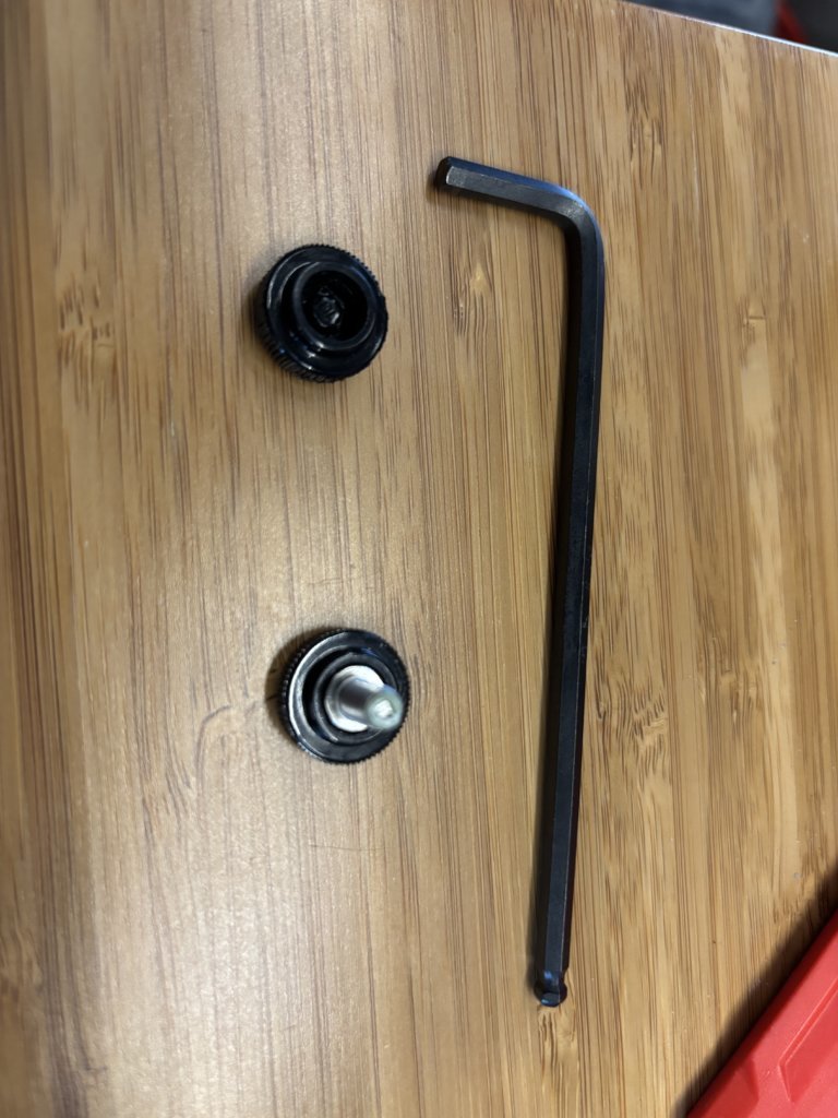

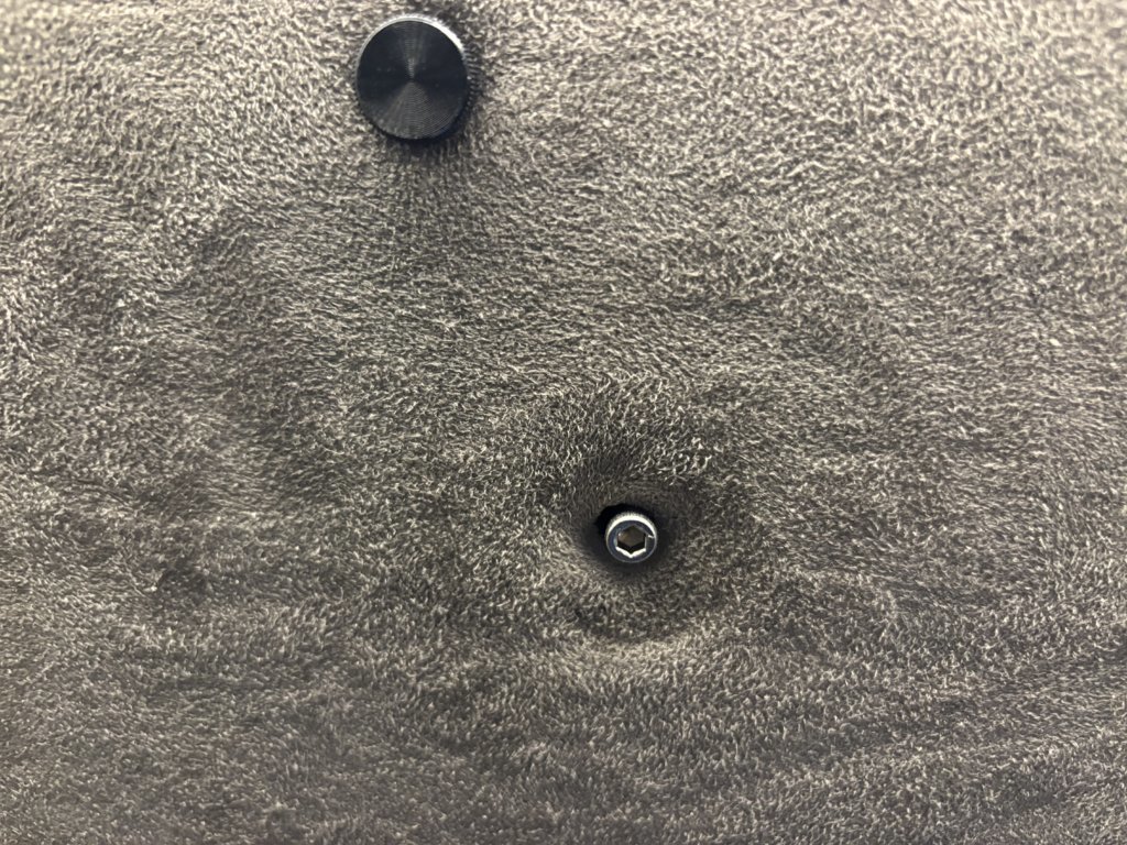

    Tried to pull a couple of the thumbscrews from the fabric covered panels (you know the ones, which in my case were installed with loctite from Kimbo). I ended up spinning 2 of them due to the loctite, tried to heat the thumbscrew but it started to melt. I had assumed that they were metal. But there plastic and have a 1/8" hex bolt under the black plastic cover.
    ps, I tried heating the bolt again without the plastic cover and wasn't able to unscrew them. What a PITA
