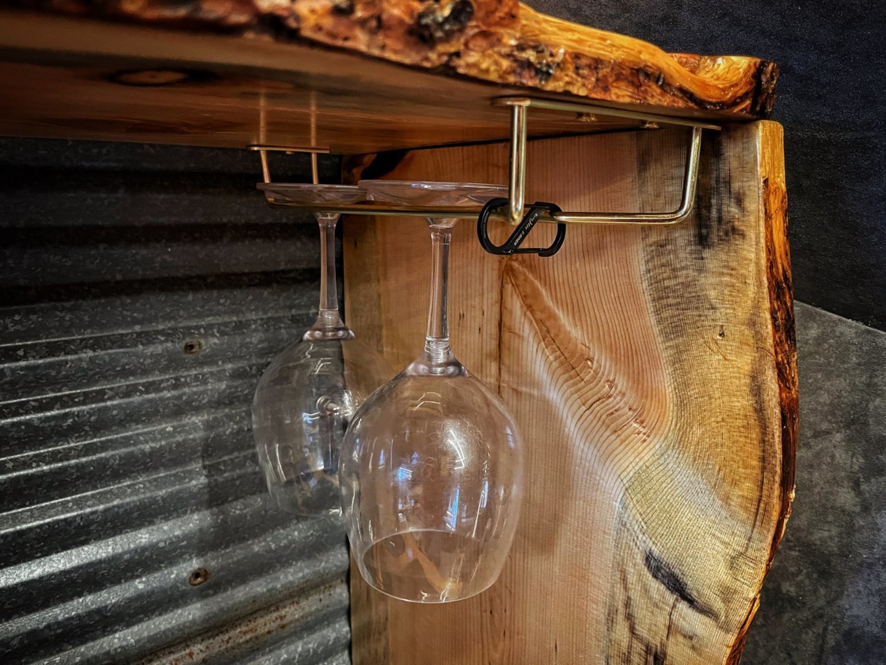

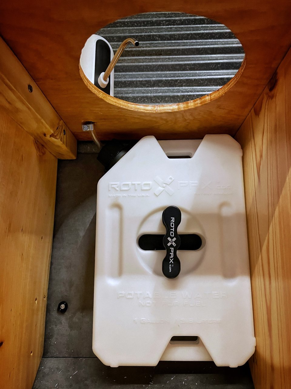

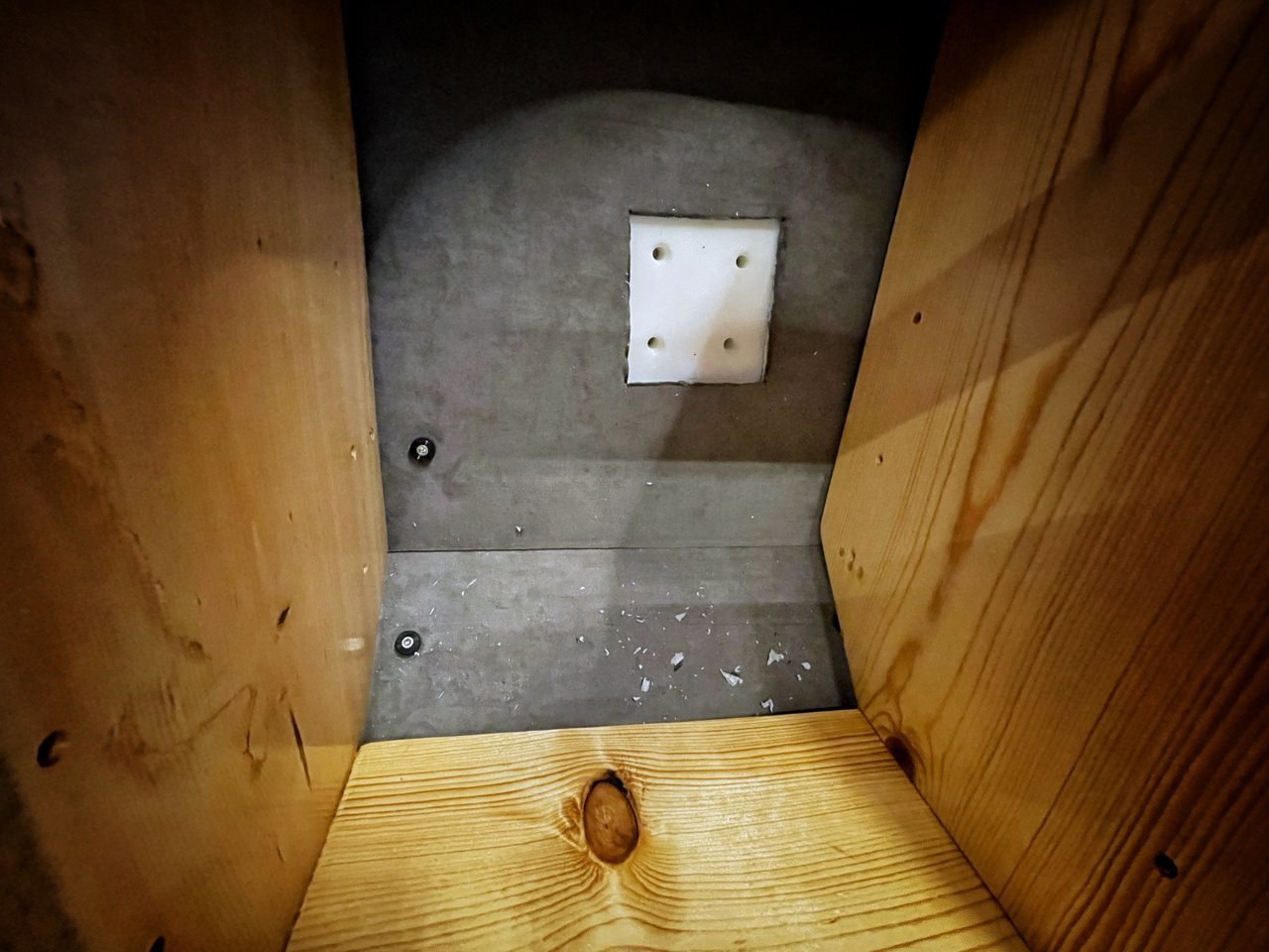

    Here are the pictures of the water system and how the camp “glasses” will stay put.
    EDIT: HDPE spacer is sealed on the inside with Sika Flex and bolts outside with Proflex RV. Stuff is so messy and hard to keep clean. I have no clue how Kimbo was able to keep their shit so neat.
