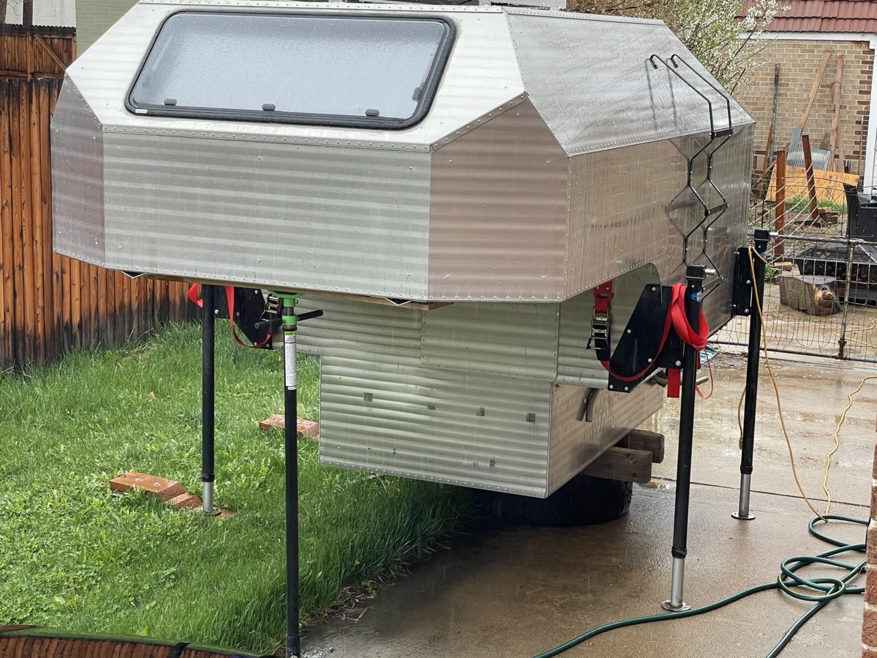

    This is what I have done in my driveway @nelsonator and @Profloundering . Once lowered on the tire its pretty stable. The jack stand in the front is fairly portable if you take the base off. I could see packing it if staying in a spot for over 3-4 days, if you were far out of town dispersed camping and wanting to hold or secure your site. I would't bring any base supports and just deal with the wobbles with getting in and out. I bet one of those inflatable jacks would do well underneath, but they are pricy. Maybe something else that is inflatable. Curious what others do in this situation to hold their camp site, use an old tent?
    Building some roller platforms to make loading easier in the driveway. I'll be able to shift the rear end left and right to line it up quicker. On the Tacomas there is barely any room between the wheel wells.
    https://www.amazon.com/gp/product/B07VM9JCN5/ref=ppx_yo_dt_b_search_asin_title?ie=UTF8

    It is a bit scary when I have mine up for loading. Im sure yours is a tad more nerve racking. When lowering, I am more focused on the rear legs. I feel like its better to have it tilting slightly nose up than down.

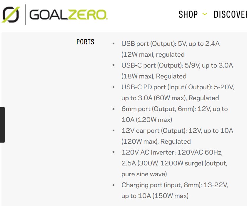

    How did you get half to be regulated? Thanks in advance!

    The Yeti 500x has a cigarette lighter 12v regulated outlet - I spliced into the cord that came with the IceCo fridge for the plug and sent the power to the fuseblock and then wired the rest of the cord from the IceCo to the fuseblock. I leave the fridge plugged into 12v all the time and also 110v all the time, it'll then run off of whatever power is available but defaults to 110v when using shore power. I love the auto switching function.

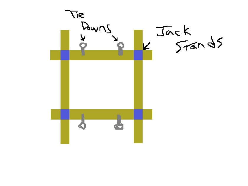

    Thought I'd poke my head in here again and toss around an idea or two. I'm wondering if a possible solution to the instability of the camper while off the truck could be solved by building some kind of platform with thick wood 2x4 or 2x8 with a metal hook or loop embedded to utilize the tie downs on the camper. this may solve the tipping issue since the tie downs are what keep it firmly in place while on the truck. Allow me to illustrate:
    Just a rough idea hehe, but i'm wondering if it could work. it could even be portable in a sense if you ran the cross boards with the tie down hooks underneath the boards that the jack stands stood on and doubled the wood in the other sections where it could sit flush with the ground, then the pressure the jack stands exert on the top wood would be enough to hold the cross wood down and create a stable tie down point. Then disassemble into four seperate planks of wood for portability. Of course I have no first hand experience with a kimbo, just going off pictures so this may prove erroneous or impractical in a real world setting. And also other factors like the wood may not be strong enough to support the camper, you would also probly still need some kind of support under the floor of the camper that maybe could be integrated with the wood planks in some way. anyway i'm done now :notsure: :wave:

    Nice. I'm thinking since they are all connected it still may tip unless the wood base is heavy enough. I guess it depends on who's sleeping in the bed... Like the eye bolt idea, should eliminate the wobble.
