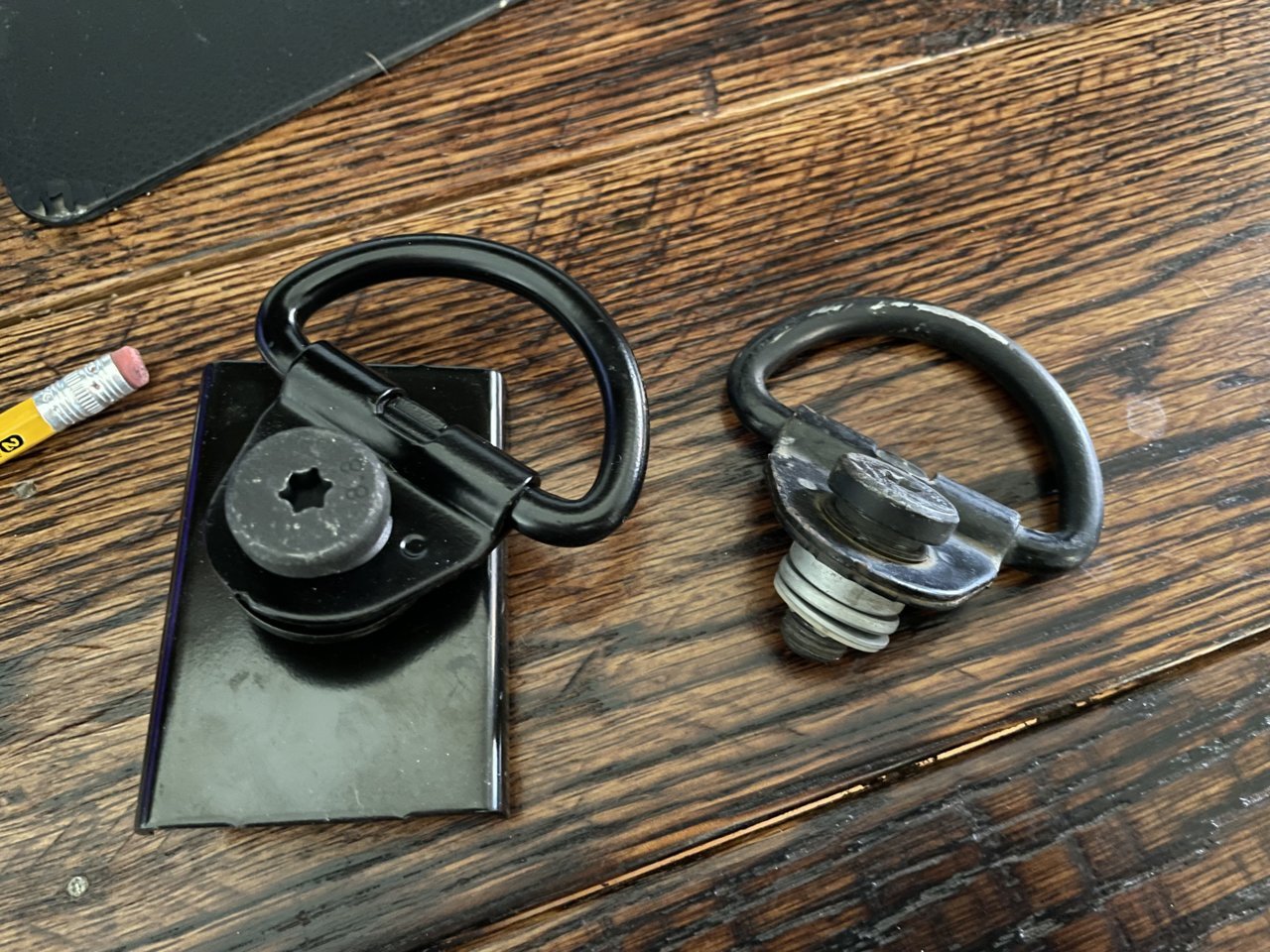

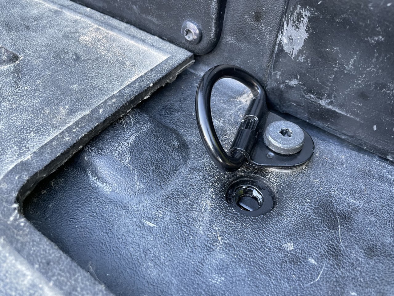

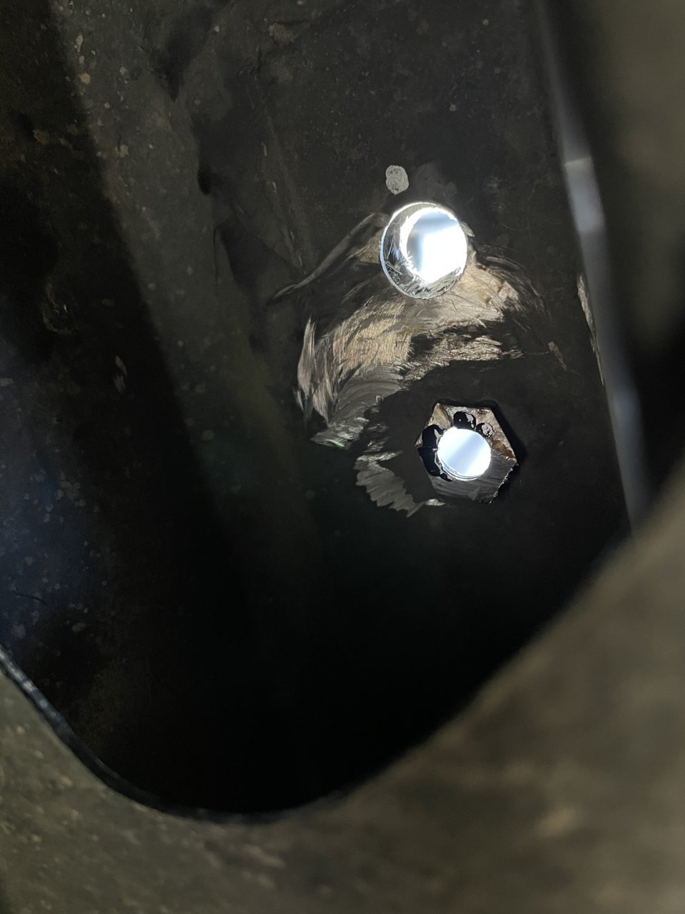

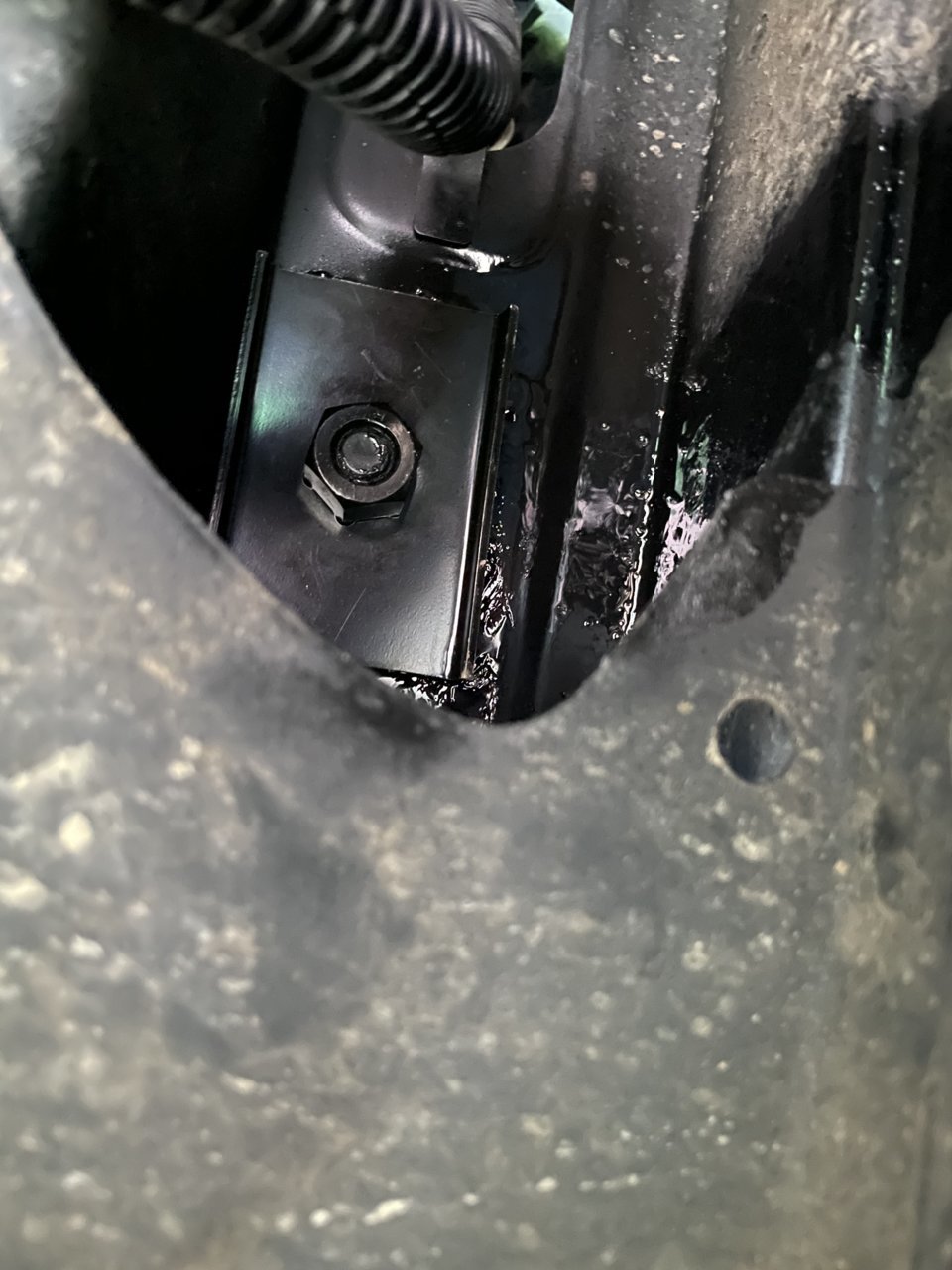

    Not a huge update but finished the new rear tie down install. There was already a hole next to the original bolt, just had to drill through the plastic bed. I also had to remove the original bolt to give room for the distribution plate. I guess that’s what you call it. Painted the surface and tightened the new ones down to the recommended torque. Need a breaker bar for the front so hopefully take care of them by the weekend.
