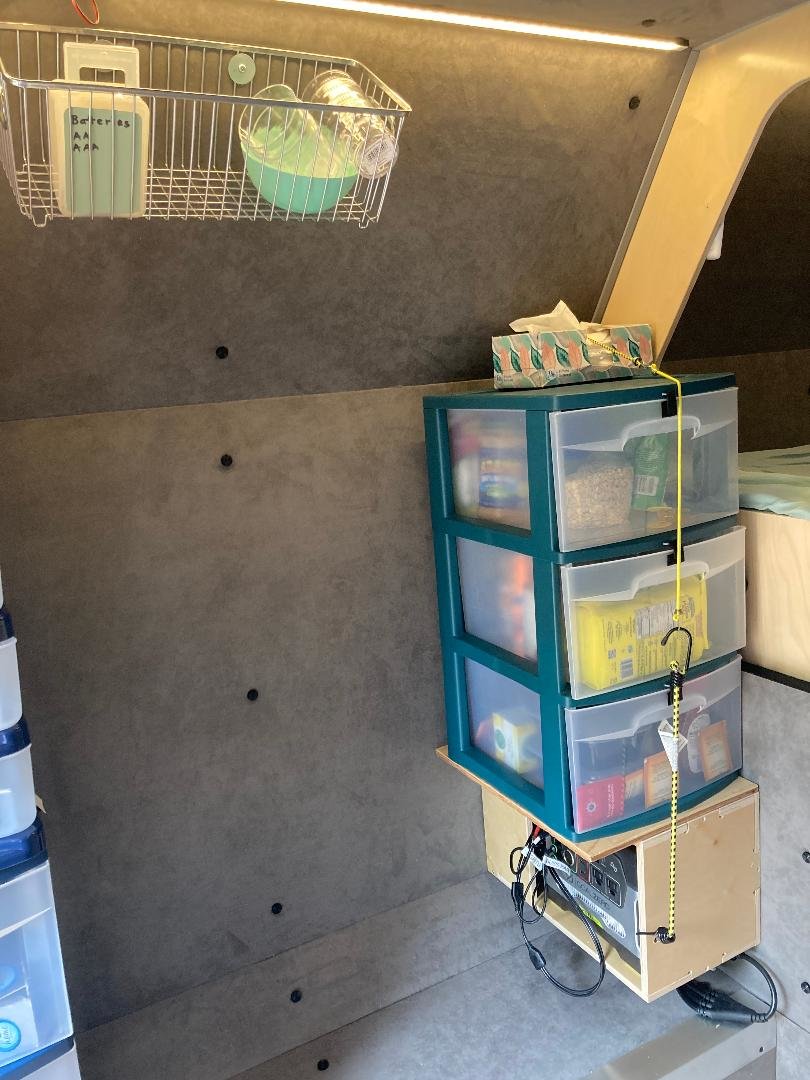

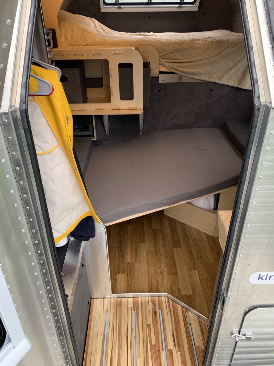

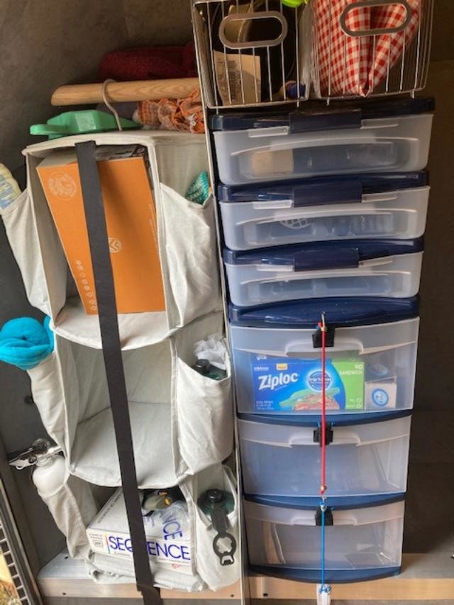

    Simple Kimbo build. So I know there are some really nice interior builds, this is just easy stuff for organizing. Did well on a 800 or so mile journey with no spillage on some bumpy campground roads, curvy mountain roads, never had to go to 4wd for any of it though. First pic Sterlite drawers on top of goal zero housing, cut a piece of plywood and added dowels that the drawer framework sit on , screwed the plywood down on to the housing. My wife added Velcro on drawers to hold shut with bungee for extra safety when traveling.
    Second pic of closet area where we hung an organizer , the velcro strap keeps shoes etc in place. Next to it is basic lightweight sterlite drawers with same mod with velcro to hold shut and again bungeed for extra caution while traveling, it's super velcroed to the divider and rear of camper, stayed in place the whole time, baskets on top -left one bolted to divider, the one with table cloth zip tied to the first one.
    The original Kimbo cushion no longer fits on the bench so we will have to get something for that. Don't have pic but on the opposite side we bungeed in our Yeti on the bench towards the back where Kimbo puts the kitchen. We used the stick on hooks for that, I thought for sure they would pop out but no problems, so although not fancy for minimal expense and only a couple holes drilled I am pretty pleased overall with function.
