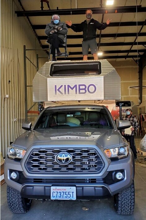

    One random question I've been thinking about...how confident do you feel standing or sitting on top of the Kimbo? Like, will I be able to just climb up there with a chair and chill out? Or will it feel like I'm gonna damage something? Climbing up and star gazing sounds like the coolest thing ever.

    Also not sure on the roof but in one of the videos, Mike gets on top and strolls around...so my kimbro Burny and I climbed up first thing

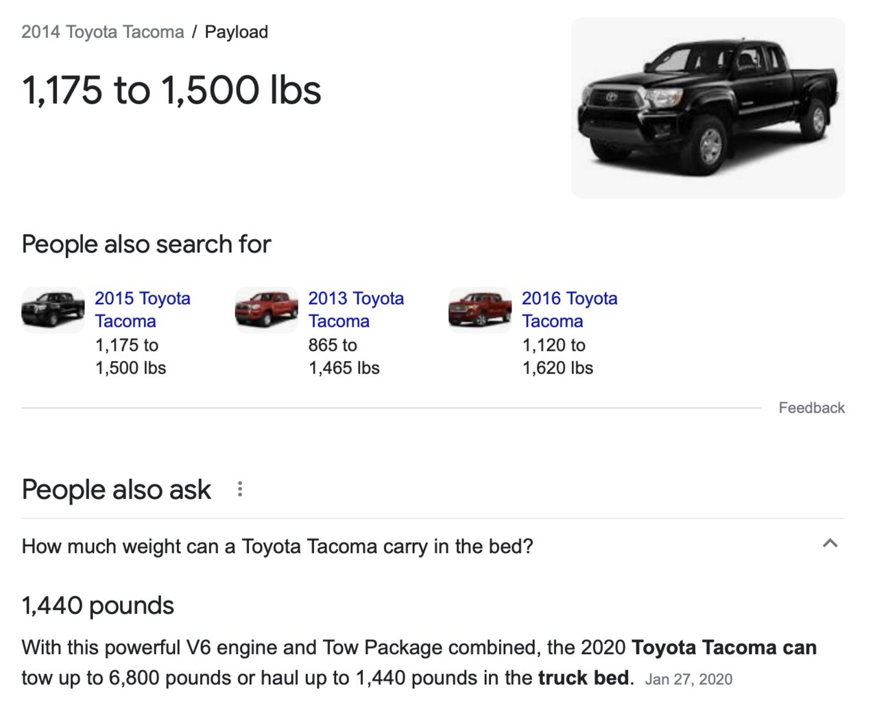

    As for payload...well, first, I'm assuming that most of us will be over the official payload capacity. But out of curiosity, what do your door jamb stickers say? Based on other reading I've done, it seems like most people's printed payloads are consistently quite a bit lower than whatever you find online for specs — even when those specs are based on you exact configurations. Mine says 1150lbs. I'm pretty sure that includes deductions for anything and everything the vehicle is equipped with out of the factory...which isn't super helpful since I don't know what the stock configurations were on mine.
    For short trips I'm not too worried. Though, for my first trip, it's a 1,700 mile drive from Bellingham back to Phoenix, so I'm obviously eyeing that number.

    Here are some various payloads for certain years.

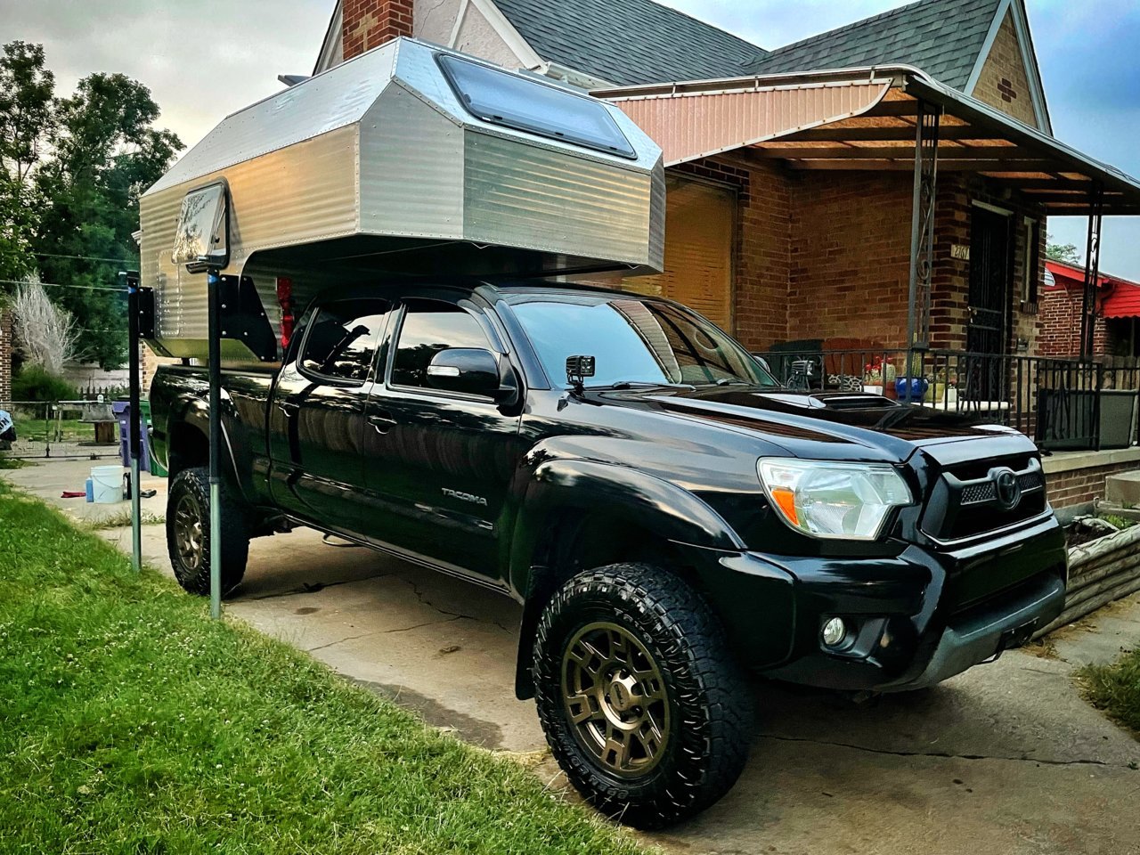

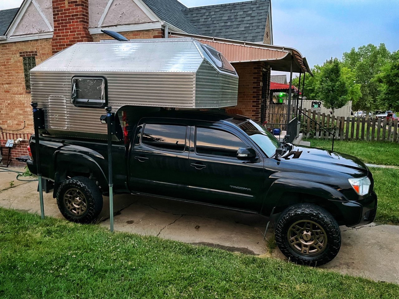

    A little truck wash before the next adventure. These Kimbos definitely look good on a clean Taco, and all the other trucks that chose wisely. I know @HomerTaco will be impressed with this top heavy angle on that first one. Hahaha, does look intimidating to me too.

    looking real good!!
    love to see this stuff - the Kimbo seems to work great with any color scheme.

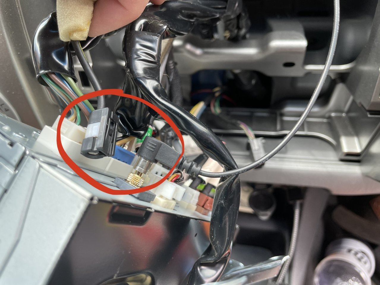

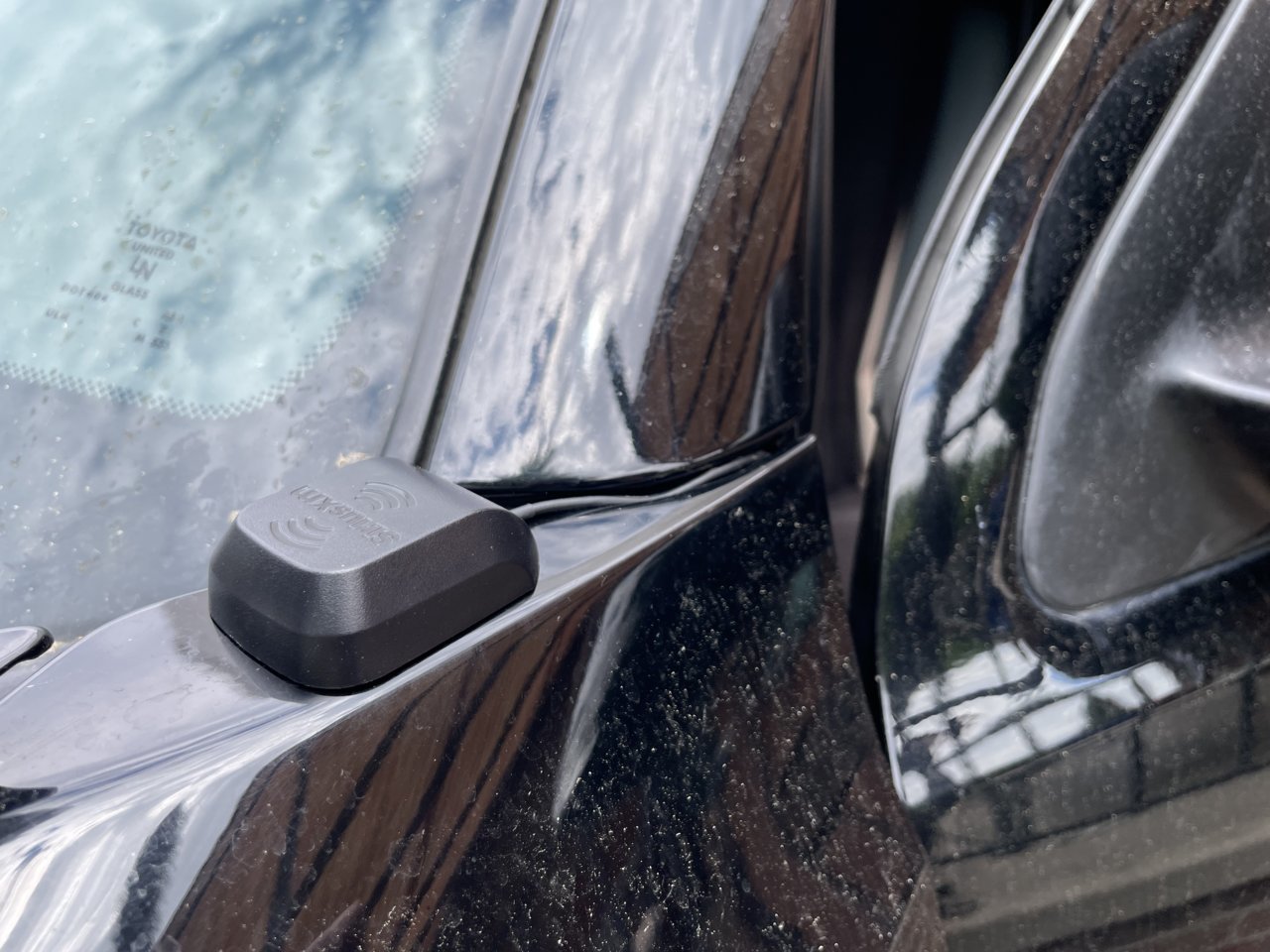

    Got my satellite radio back. Found this mod somewhere on the interwebs and worked out great and was fast. Just unplug the shark fin and plug in the new magnetic one. You’ll will need the adapter for it. Head unit was easy to take out too. Just have to remove 4 bolts after popping out the AC dash controls.
    By the way check to see how much you’re paying on the service if you have it. There is always a promotion that they will give you which brings it to about $4-$5 a month if you tell them you want to cancel.
    Parts:
    https://www.amazon.com/gp/product/B01H5D0I1A/ref=ppx_yo_dt_b_search_asin_title?ie=UTF8
    https://www.amazon.com/gp/product/B0083TX86S/ref=ppx_yo_dt_b_search_asin_title?ie=UTF8
    546134A7-B2B3-4CE8-BEB7-6172FCC9D7B0.jpg 940C5BFC-2C76-4ACA-B77E-8A9C0BEF04CA.jpg

    Door sticker is the final say on what your payload is - it takes into account everything on your specific build and can vary wildly.
