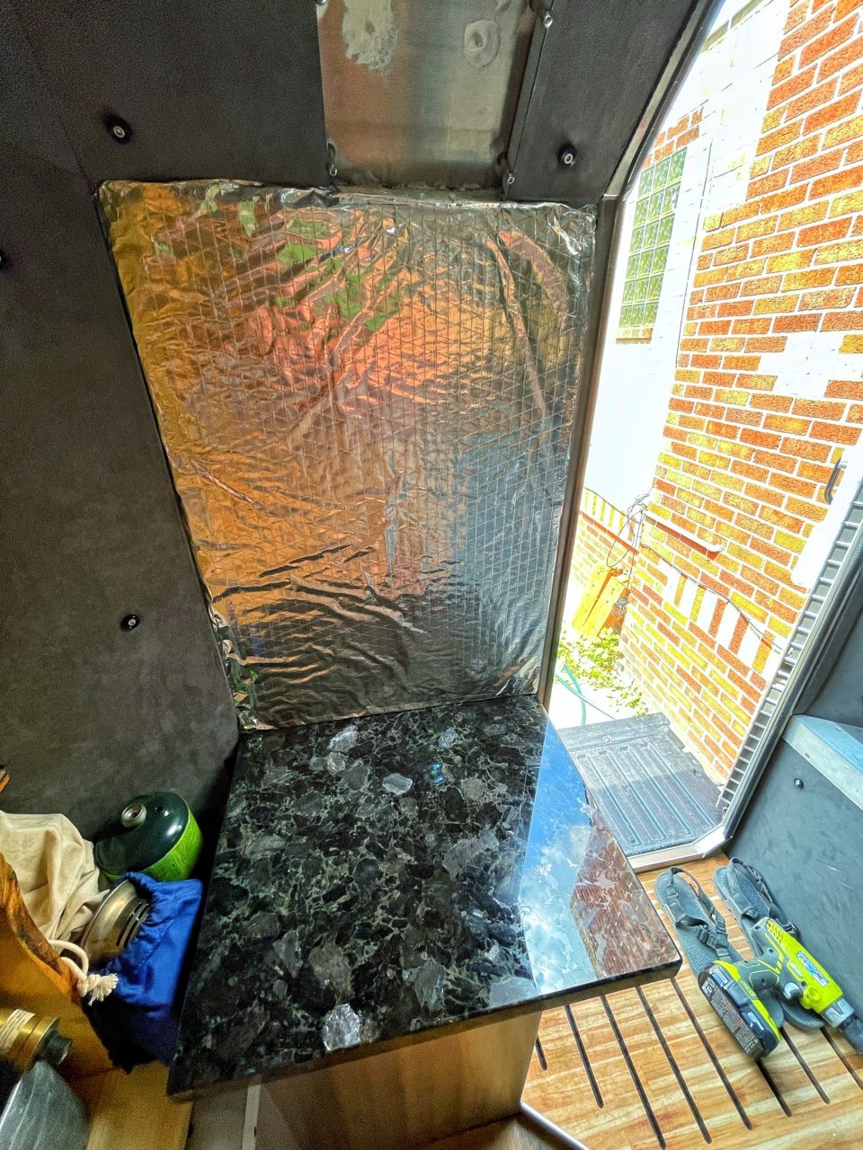

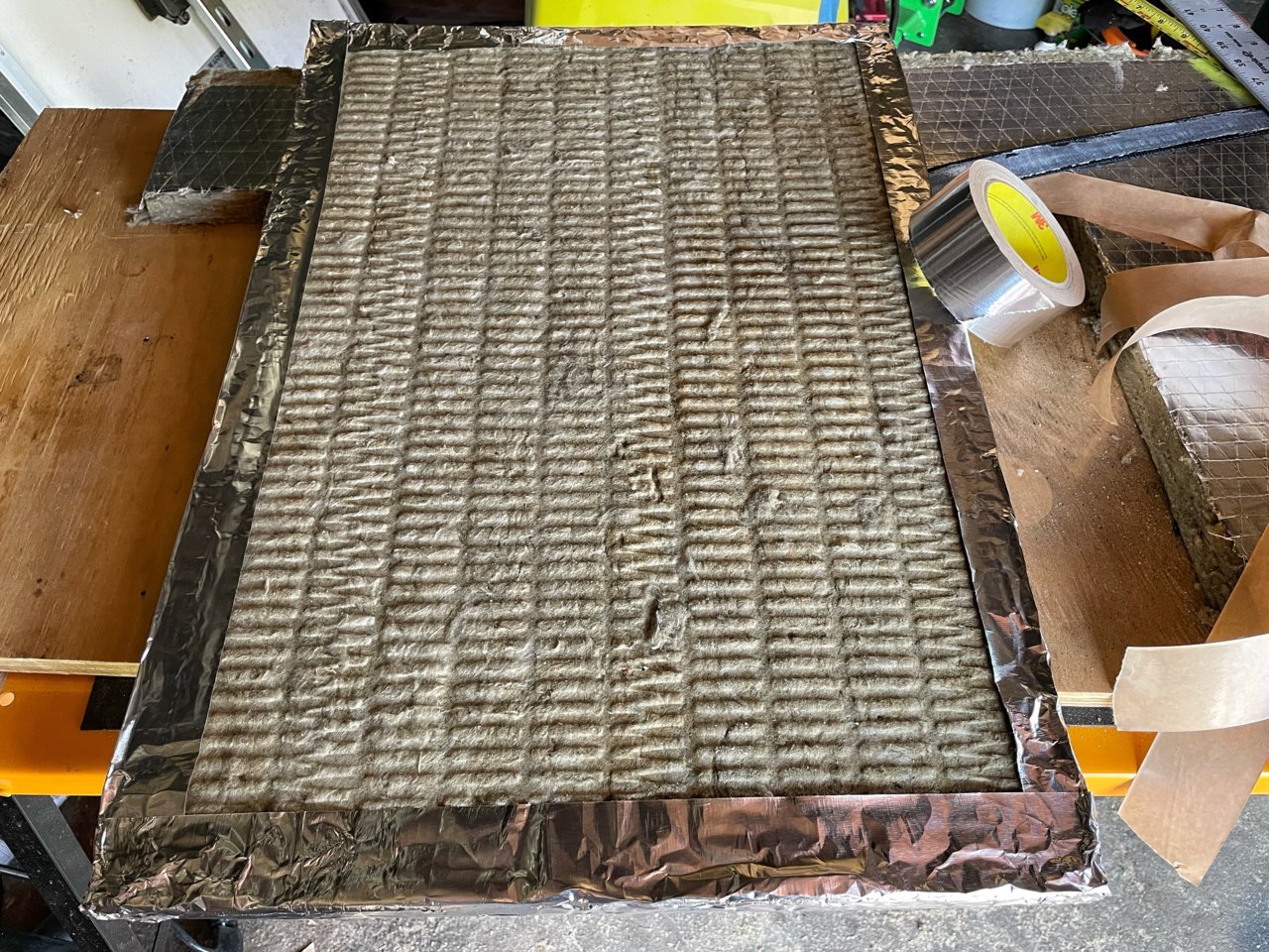

    Baby steps on the wood burning stove. Have the mineral wool and back plate installed. Added some extra aluminum to the edges and used brass thumb screws with the existing spacers. Will potential do the section above based on the amount of heat but it’s currently within clearances based on the stove specs. Will be securing the granite soon with Sikaflex and then drilling later this summer/fall. Thinking about using a high temp clear coat (500°) on the back plate but don’t know if it will release fumes or not. will do some research.

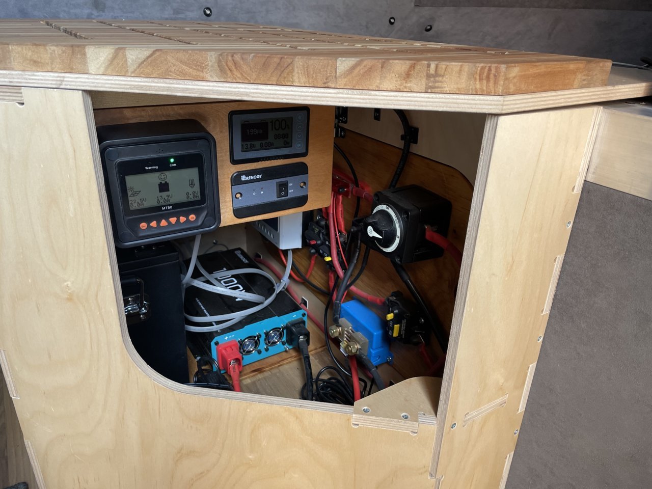

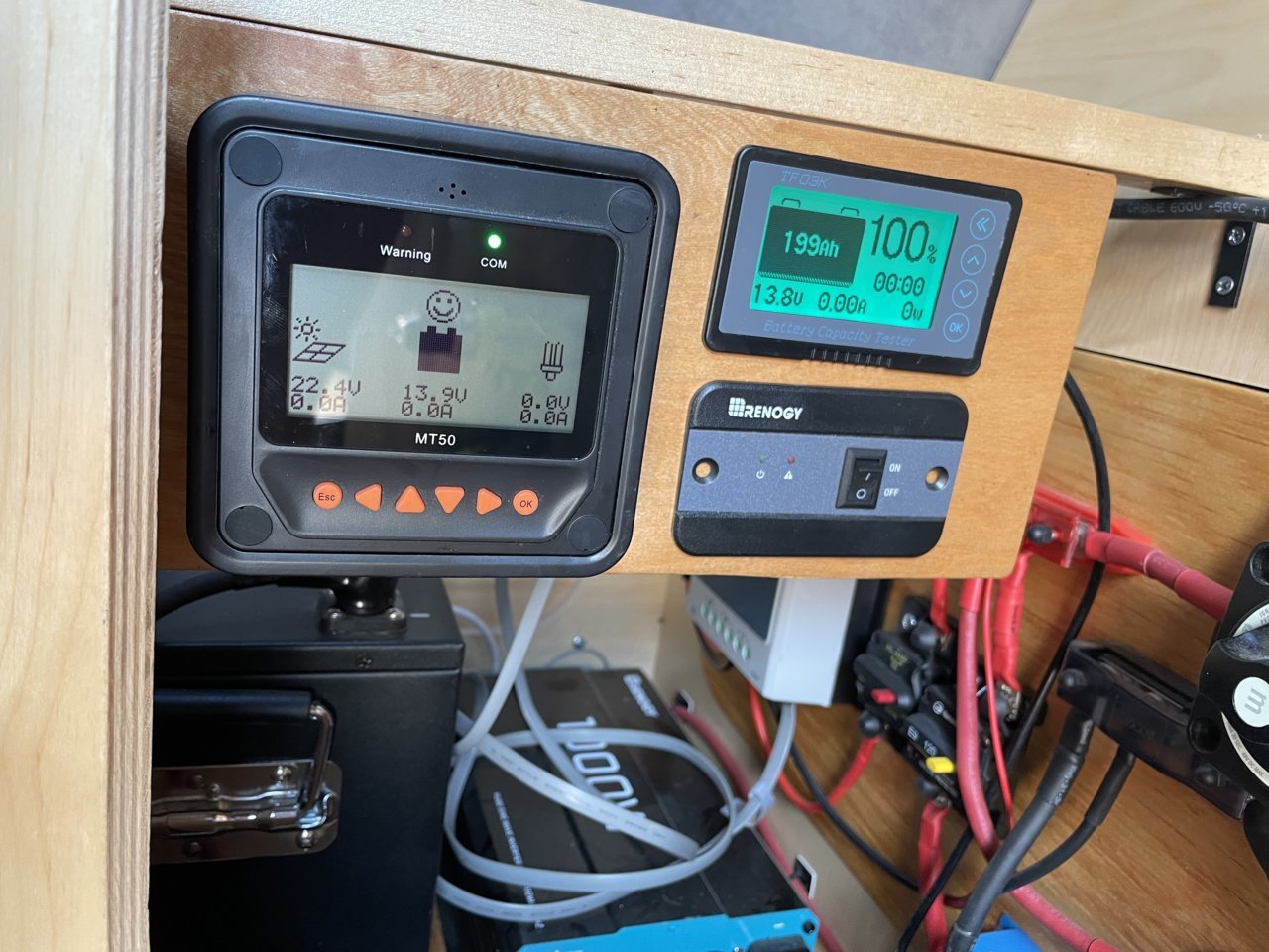

    A little control panel to keep the controls off the floor and open some space.

    Clean :cool:

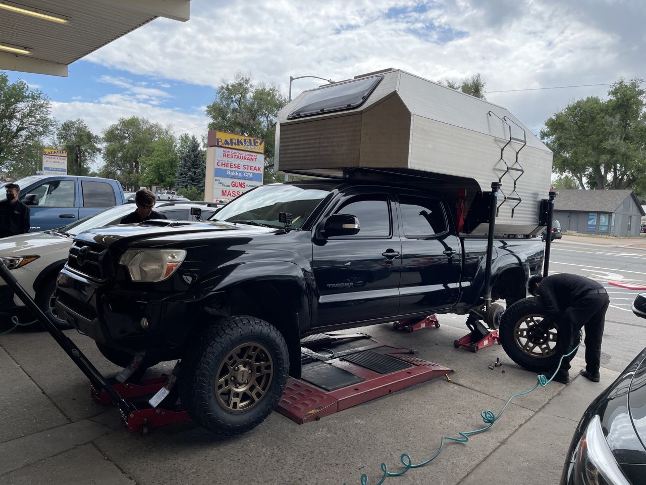

    Tire rotation today. Everything has been wearing evenly and flat. The passenger rear a tad more than the rest. Guessing due to the weight on that side, solar and kitchen. After about 7k miles wore about 2/32's Should get well over 50K with these. With my buildout/weight I'be been running 55psi up front / 65psi in the rear and 30psi in the bags. Obviously this is specific to tire size/brand and what you're hauling, but may be a starting point for some. Also, last trip to WY gave me about 12mpg average.
