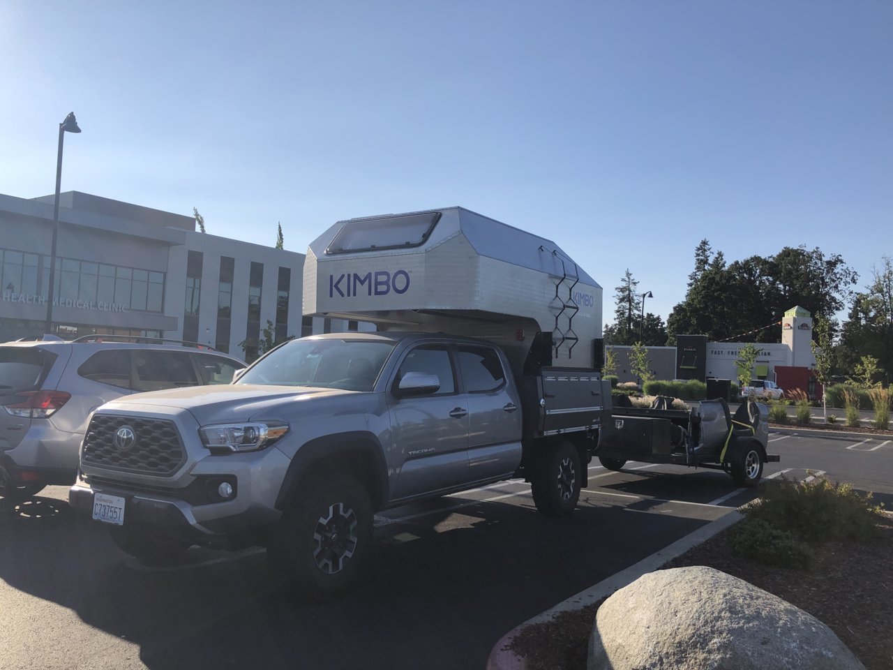

    From the drive home - borrowed the trailer from a buddy, it was a beast - way heavier than expected for such a small trailer but it got the bed home...10mpg DOH!!!

    The Sherptek looks awesome!!!

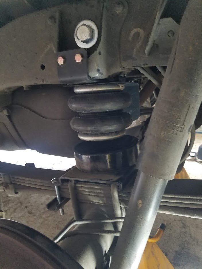

    Yeah the air bags are a solid option for these campers. These "bags" are way more burly than I imagined once I started down that path. For one thing, these things are built for loads up to 5,000 lbs. The hight and ride quality is adjustable depending on how much air you put in too. I roll with about 30-35psi but these things can hold up to 100psi I believe. I also have OME Dakar leafs in the back so that probably effects the psi I use. So all in all we are using only a small fraction of what they are capable of. Also, if you're worried about articulation of the rear suspension, they make a cradle system that doesn't require the system to be attached to both the axel and body of the truck, I went this route. With out the camper I keep minimal positive pressure in them, 5psi as recommended. They just hang out in there, not affecting anything until I need them again. I rarely check them once I have them set with the camper and it only takes a bike pump to fill them.
    Others can chime in, but I believe the only way to keep the truck level with and without the camper, since yours are already flattened, would be a custom leaf pack for 1,000lbs+ or Sumo Springs. The Sumo Springs look to act similar to an airbag system, but they are not adjustable, solid foam/rubber. Two options a 1400lbs and 1800lbs capacity at 50% compression. I'm not sure what the ride would be like but they are popular too.
    Hope this helps.

    Voltron you are a wealth of knowledge! I really appreciate you weighing in with plenty of real life experience with the camper. I actually saw the tundra again today in boulder but it didn’t look like Colorado plates. I couldn’t tell exactly. The lines of the kimbo look really good with the tundra though for sure.
    clearly I need to do more research on the cradle type airbags. That sounds like a win-win. also super cool to know that you can handle the airbags with a bike pump.

    No worries man. Here's a pic on a Tacoma with the Daystar Cradles if that helps.

    Oh damn those look super sturdy!
