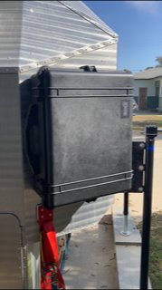

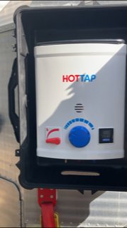

    Shower setup update. I took an idea out of spacerhover setup and added a personal touch. Found a used Pelican 1600 online, then added a Joolca mounting bracket, and mounted it to the back quarter panel of the Kimbo. I already have the the Joolca show setup setup. I run 5 gallon water jugs on the side of the truckbed.

    Looks great. Having that extra space on the sides really opens up some options like this. Would love to have this option at some point.

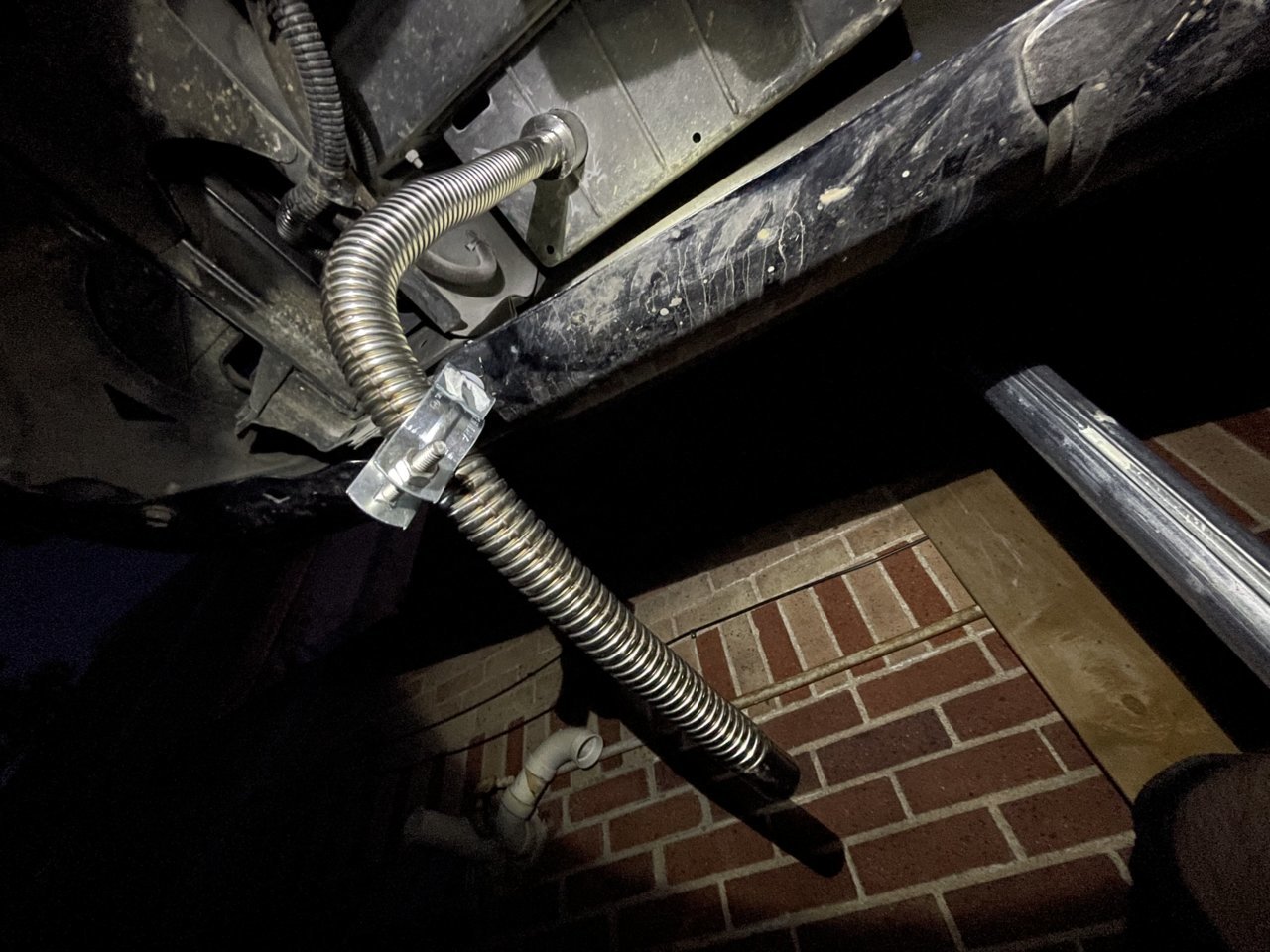

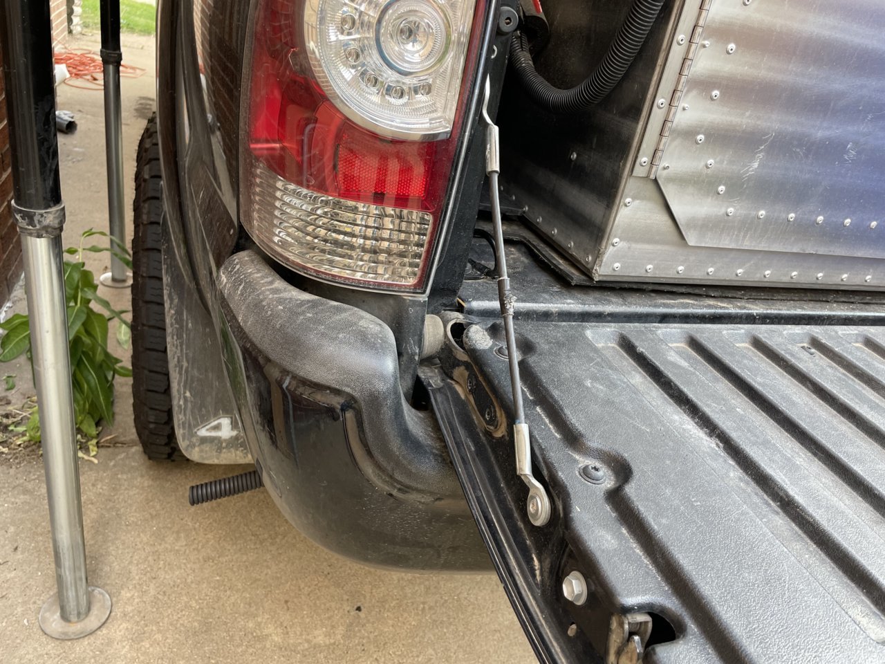

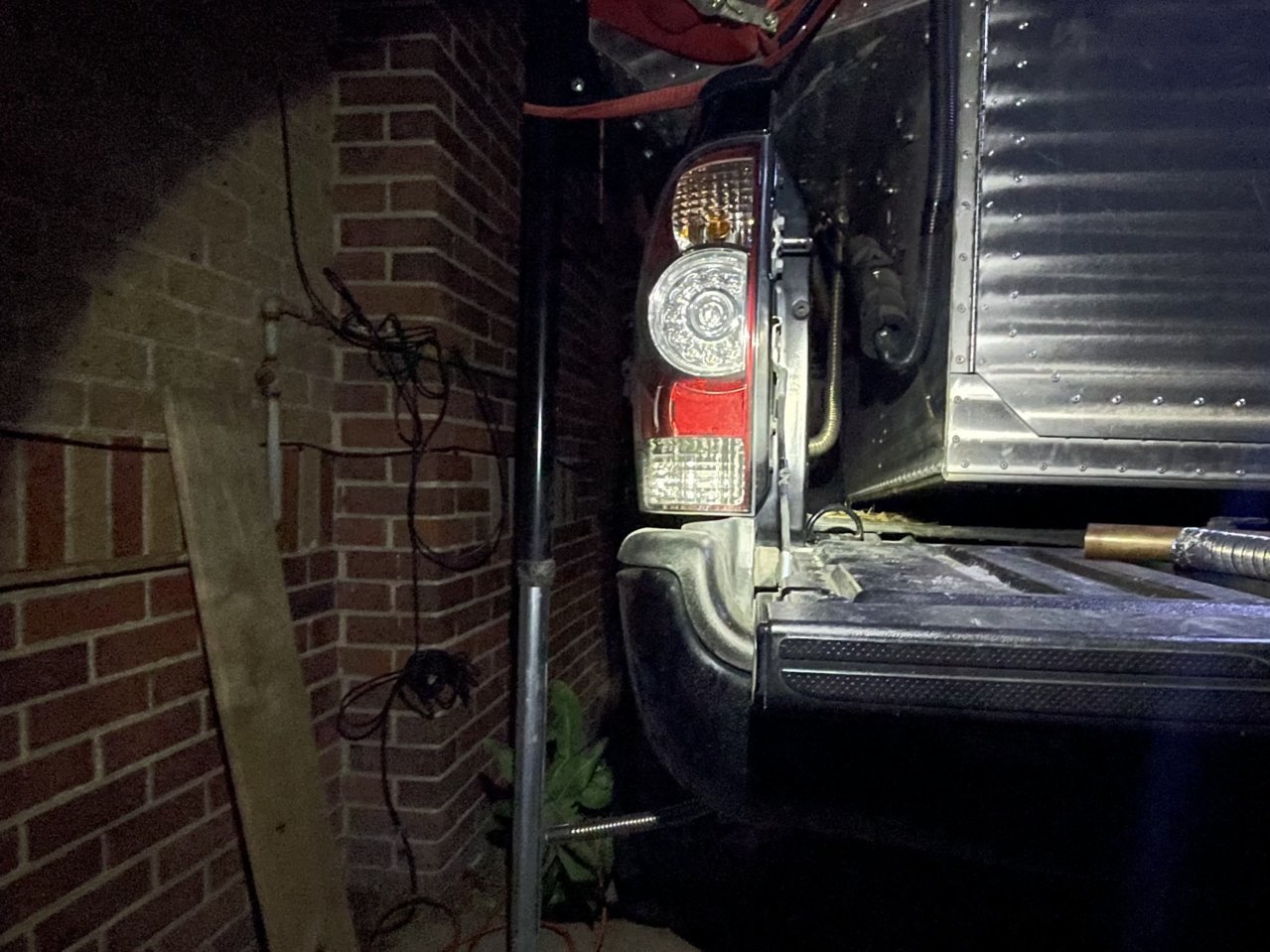

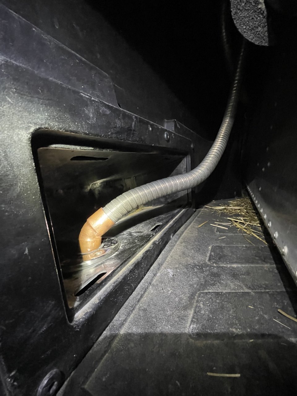

    Will have some better pictures when finished. Pretty happy with the fit and clearances. The exhaust is now further away from the back door and cleaner look. When not in use I can close up the storage. I have high temp silicone insulating the inside of the stainless steel exhaust fitting. I’ll shorten up the end of the pipe a little too. Will test it out this weekend.

    Nice route to keep from having to pop a hole in your bed!! Is the copper fitting a slip fit? Looks like a marine bulkhead fitting, love the look of those.

    Looks like you attached the exhaust to the bottom of your fender - can't remember if you have mud flaps, when you hit the snow/ice that area accumulates with large chunks of ice…

    Yeah after looking at if for awhile it’s much lower consequence that route if it doesn’t work. I can replace the cubby if I want. Only really worried about the length, hopefully not too long for the heater. The exhaust is the same diameter as the copper elbow so I had to make a slice to get it in. Will make permanent with some high temp JB Weld but probably doesn’t need it. The copper to the marine bull head is a tight fit. I have high temp silicone wrapped on the inside of the bulkhead. I have to apply a good about of force to get it in. The bulkhead does look neat. Wish I could have it in a cooler more visible spot. Have some fiberglass pipe wrap too add.
    I do have flaps but I still expect that to be a possible issue. It’s pretty flexible and simple on that side to reroute. There is an existing hole there on the lower fender I’m using with nylon washers on either side.

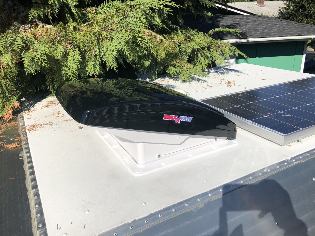

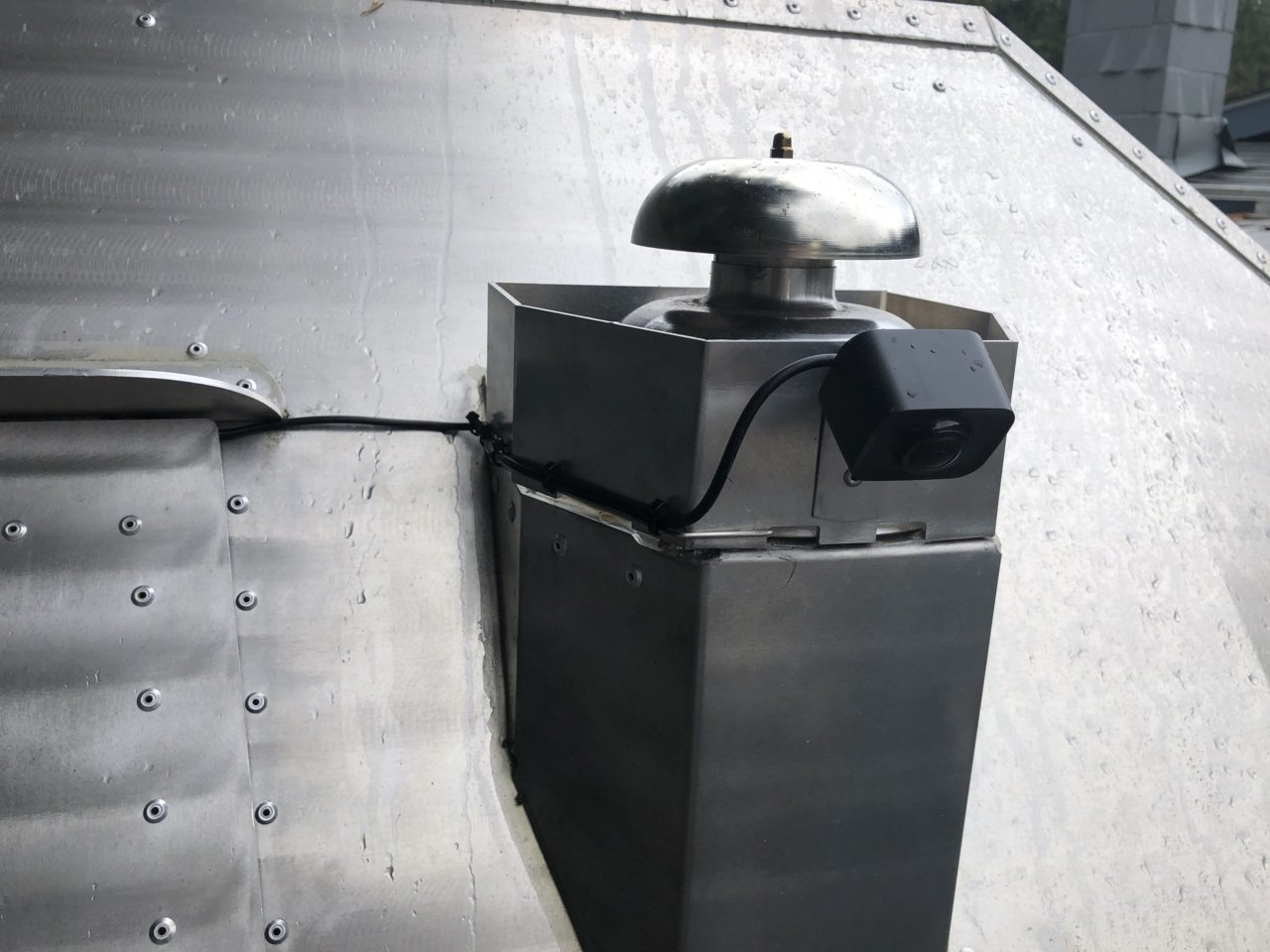

    Getting a major winter upgrade with the maxxfan installed (almost).
    There is a great post about the shortfalls of this fan
    https://m.youtube.com/watch?v=lkIDSVldJis
    but they are easily resolved. The biggest benefit it being able to keep the vent open in rain/snowy conditions.
    Also got the wireless reverse camera mounted and wired up.

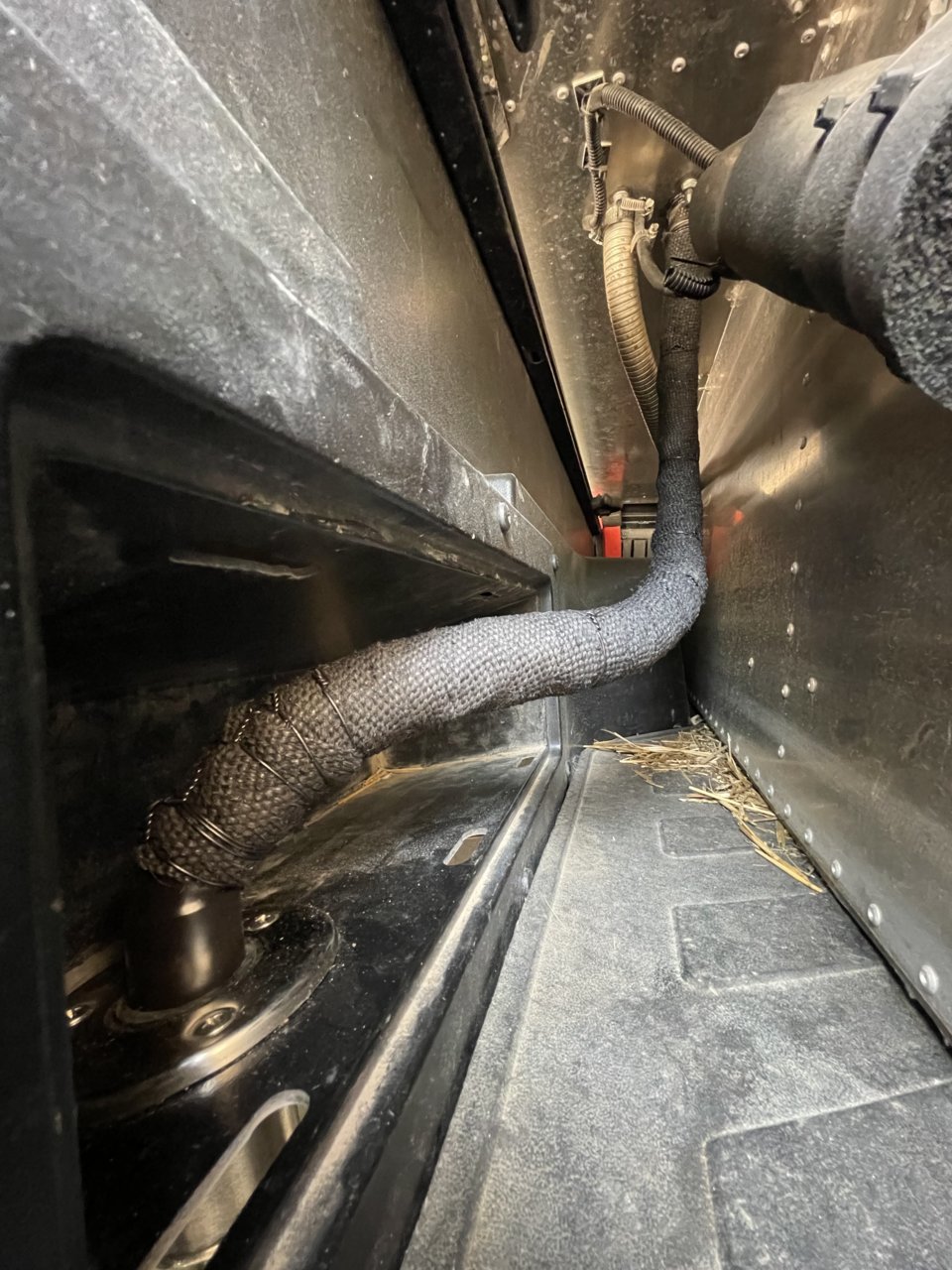

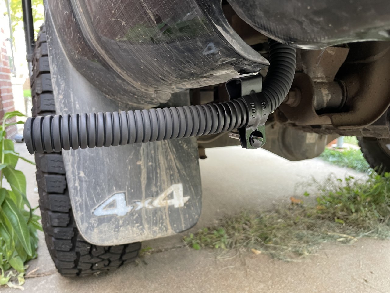

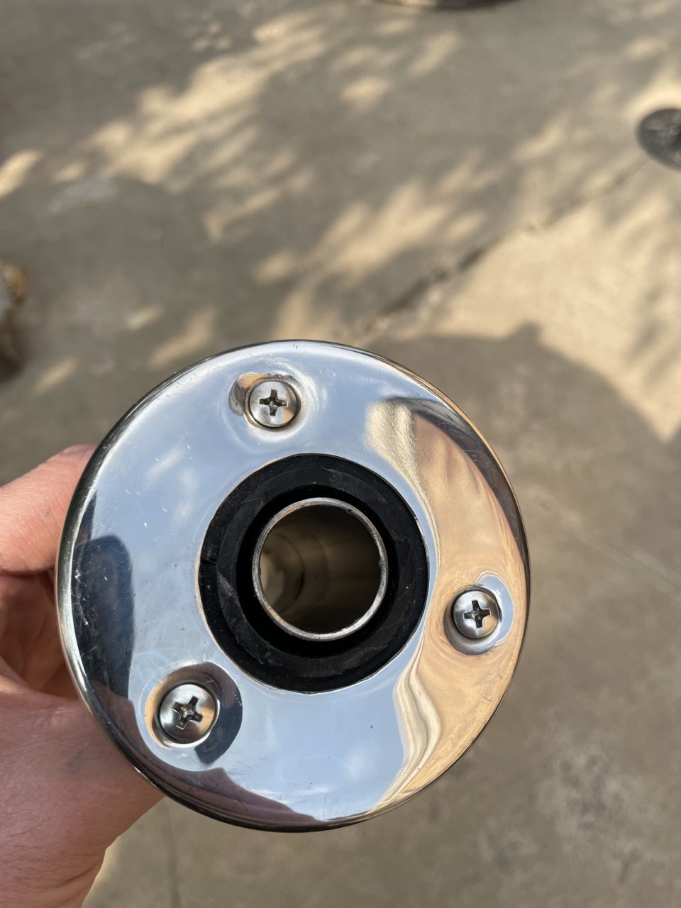

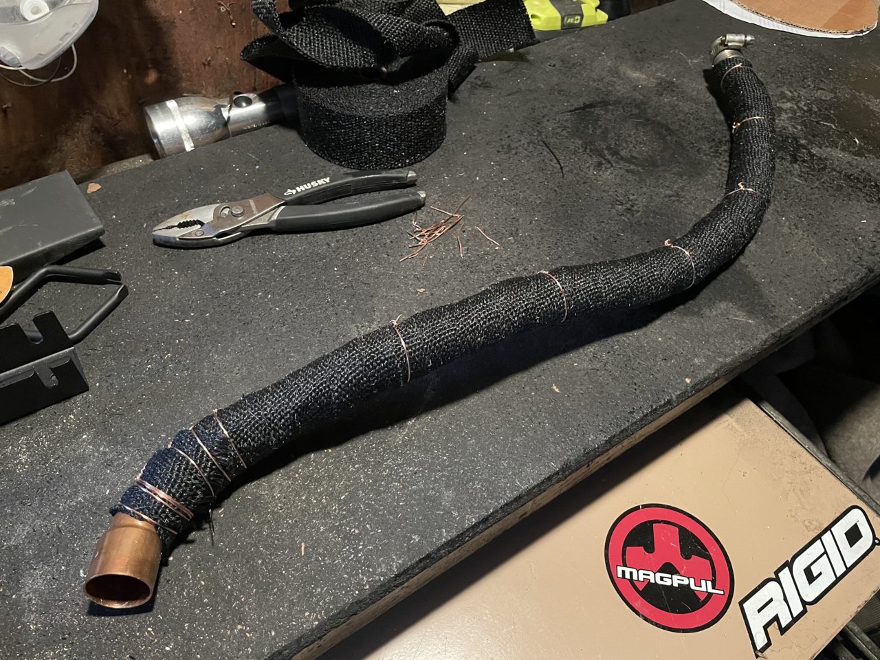

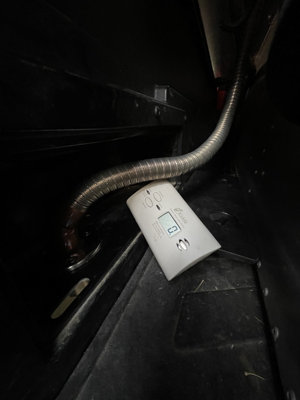

    Took care of the finishing touches for the heater exhaust re-route. I also have a picture showing how I modified the bulkhead. It is a slip fit but the high temp silicone and step down fitting, not shown, creates a solid fit. Diesel produces less carbon monoxide than gas but still nothing registered after 30min. I also used fiberglass wrap and high temp silicone spray to protect and bring down the surface temps. It may help with the sound. Bottom tail pipe was shortened and painted in high temp paint. We’ll see how it holds up. I may find an end cap for bad winter weather. It’s a cleaner, plug-in setup and safer with it off the to the side. During the summer it can be easily be taken down.

    That looks very hot rod with the exhaust tape and safety wire!!
    I'd think that being outside the Kimbo, the carbon monoxide would be a non-issue and even if you did have leak - it should roll out the tailgate like water - safety first (so I'm told).
