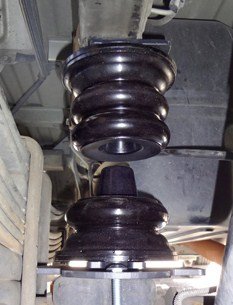

    Im no expert is probably not the best way to start. But, I believe the Sumo Springs would be a solid and dependable option if you're confident on the average load your camper will be weighing, water, gear, propane, etc., since they are not adjustable. If you get the right density they seem to be very durable.
    Just remember that stock leaf springs in Tacomas are not the strongest and can prematurely sag. I have upgraded with Old Man Emu Medium Duty Leaf Springs.

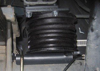

    The option I went with was the Firestone airbags and Daystar cradles. This gives me the same features as the Rebel Sumo Springs it seems, allows for unrestricted suspension usage when off road. Firestone plus the cradles put me pack $360. The Rebel Sumo springs come in a $400 from Etrailer.com. The ride will probably be the biggest difference since one will be on air and the other on closed cell urethane. Unfortunately I have no experience on either but I would imagine the Sumo springs would be a harder ride when fully loaded compared to the adjustable air bags. Maybe its Durability VS Ride Comfort though the Firestone Air bags do have a solid reputation.
    From ETrailer:
    SumoSprings provide progressive load control - the more you load them, the stiffer they become. With a lighter load, the springs will compress easily for soft engagement and a less bumpy ride. The springs can also compress by as much as 80 percent to support a heavy rear load and to help your factory suspension bear up under the load. This evens out the weight, which levels your vehicle and ensures that your front tires are making better contact with the road. A level ride means that you have improved driving control, ensures safe headlight aim, and helps to minimize sway. The springs also support your factory suspension, which helps prevent sagging and reduces bottoming out.

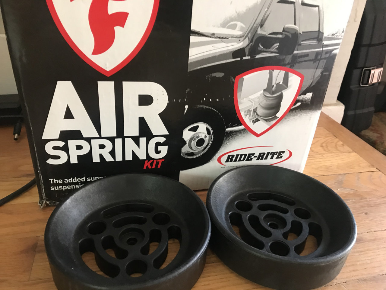

    Finished right before the snow comes tomorrow. Airbags and Daystar cradles installed for the Kimbo. It was a pain in the ass but went fairly smooth. Happy to share what I learned if your doing this yourself later. Stoked to see what the ride is like later.

    Edit: Just a heads up, I switch the T union for separate valves. I was told by a member that air could shift from one bag to the other causing more wobble. Made sense so switched it.

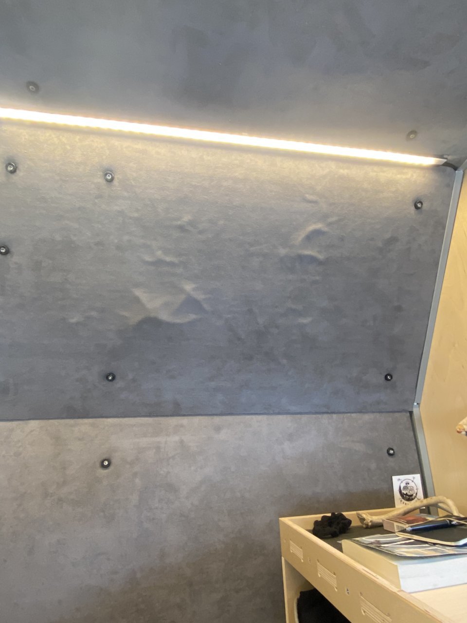

    D0BFE19F-872F-44B5-B308-98F951E1DC62.jpg What’s up guys, I’m curious if anyone has experienced separation of the felt from the R5 insulation on any of the indoor panels? This showed up roughly a week ago and it’s grown worse. Any ideas for a remedy? Thanks as always

    Is that directly on the insulation or on a panel? Curious what the layers are?

    Also, for a truck camper, I've always installed the airbags individually pressurized, so they are not linked. This way you prevent the rocking back-and-forth in the corners. It makes a world of difference. They go over it here. :cheers:

    the separation is from the felt that is directly adhered to the insulation.
