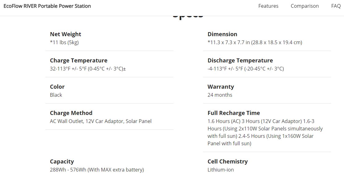

    The Ecoflo River is Lithium so you should be fine to charge and use it in below freezing temps. It's the sealed lead acid that you have to be more careful with. Lithium you are also able to use 100% of the capacity vs 50% of lead acid to maintain a healthy battery. Hope that helps.
    Edit: Read the spec sheet wrong. Will not charge below freezing but will discharge below freezing.

    Looks like I read the EcoFlow River spec sheet wrong. I saw the +/- and thought -5 degrees. It will definitely stop charging below freezing.

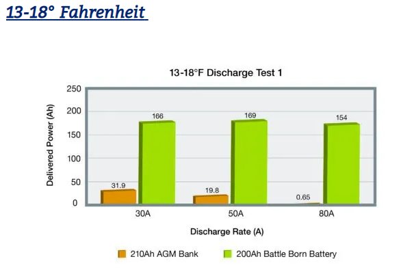

    Some more info on AGM vs Lithium. Battle Born is at the top of the list when it comes to quality,(and price) lithium batteries, so their BMS can be trusted to safely turn off at 25 degrees and turn back on at 32F. The BMS will decrease the charge current until shut off. As far as discharge the lithium will outperform the AGM across the board in cold weather. The BMS will shutdown the charging but the battery is still able to be used. I'm not sure of the quality of the AGM batteries used in the test, so a Goal Zero may have better results.
    "At 25° F, a Battle Born battery will no longer accept a charge. This is to preserve the cells in the battery, and the internal BMS will allow a recharge when the temperature is above 32° F. Every single battery that we assemble has this intelligent internal BMS.
    Lead acid AGM batteries do not have an internal BMS, meaning they may operate at colder temperatures for a bit, but you risk damaging the entire battery and losing power for good. Damaging a lead acid battery can be very dangerous for you and your rig and should be avoided."
    I imagine the Goal Zeros do have a BMS built in their system do to the all-in-one design and remain safe in freezing temperatures.
    https://battlebornbatteries.com/lead-is-dead-white-paper-study/

    I certainly don't want to damage the Kimbo with a lead acid battery, but I still don't understand how car/truck batteries do fine in sub zero temps. They use lead acid batteries in the engine bay and they are recharging as soon as the vehicle starts running of gas/diesel. Are we saying that my lead acid Yeti 400 is going to explode inside my Kimbo in the winter?
