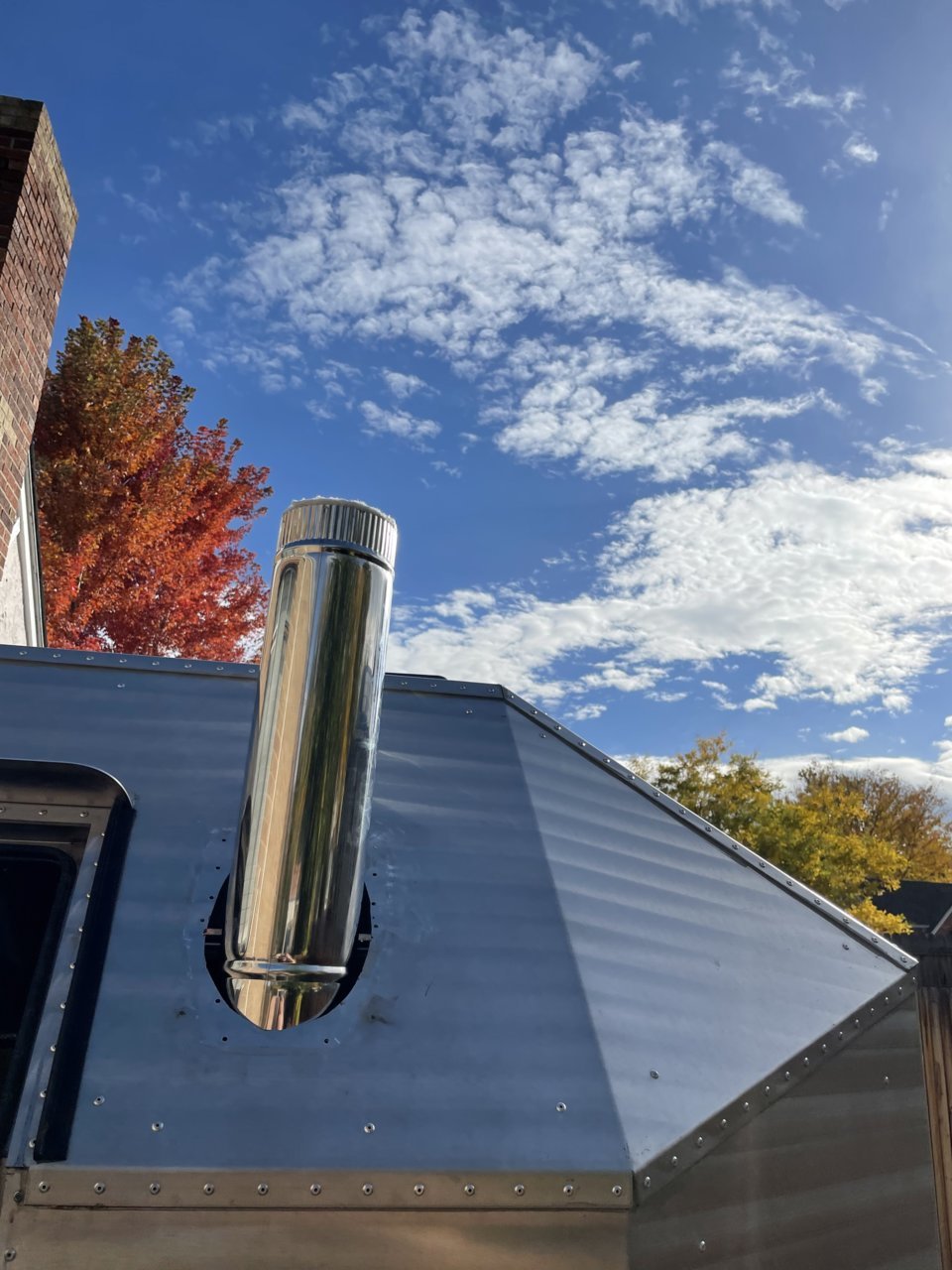

    Well made some progress this weekend and cut a larger hole in the Kimbo. Measured and remeasured several times. Would have been way easier going through a flat roof but I have it fitting well with all my clearances. She looks good. Can’t wait to get the first fire going.

    Looks good, and tall enough to give a decent draft. Do you put a flashing down over the pipe? Is the pipe set up like a gas pipe where it pulls in outside combustion air from one layer and the exhaust goes out the other layer?

    I have one more 20in section that will connect to this one so draft should be great. Happy with this drive height, sits below the fan height. I do have a high temp silicone flashing for it too. There are two vents on the stove, one main vent and a second one underneath the stove. That second one allows for a secondary burn inside the stove. Just like when we run the diesel heater we’ll have some windows cracked due to how well the Kimbo is insulated.

    Cracking a window makes sense, that's why I was asking about the combustion air . If your vent terminates above the roof it should be even better draft so that will be excellent. Probably only need a match box full of wood to heat up the whole camper!

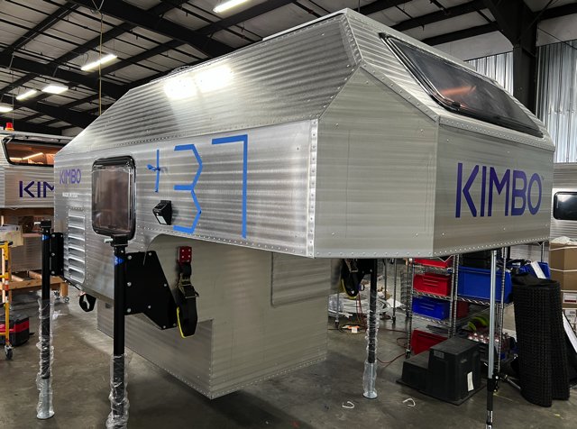

    #137, in theaters (ahem, my driveway) this Friday! Anything y'all would recommend doing/bringing to prepare for pickup? Or any questions to ask?
    I'll be custom building the kitchen, but it'll be a while before I cut any @Voltron4x4-sized holes.

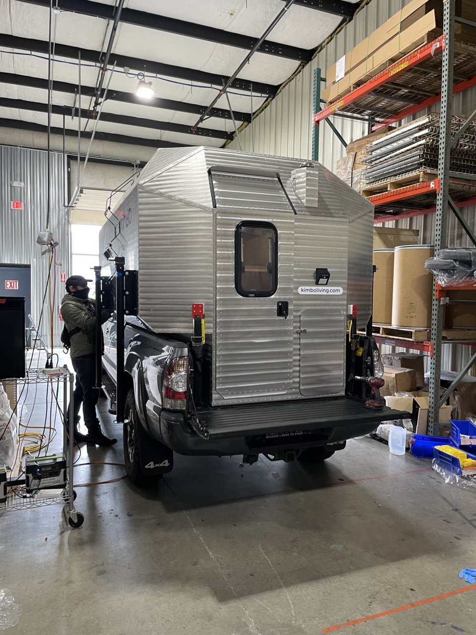

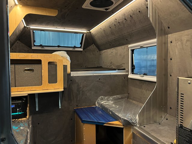

    Yesterday was the day! Antonio gave me the rundown and was super helpful. I ordered the maxxfan, 100w solar, propane fireplace, the storage/desk combo, and c-channel roof tracks for yet-to-be installed Yakima crossbars.
    Extremely satisfied so far! The build quality is truly incredible. I was surprised at how fast the fireplace heats up the space, and the fit and finish overall is wonderful. The airbags helped a ton with the load and it was smooth sailing back to Seattle.

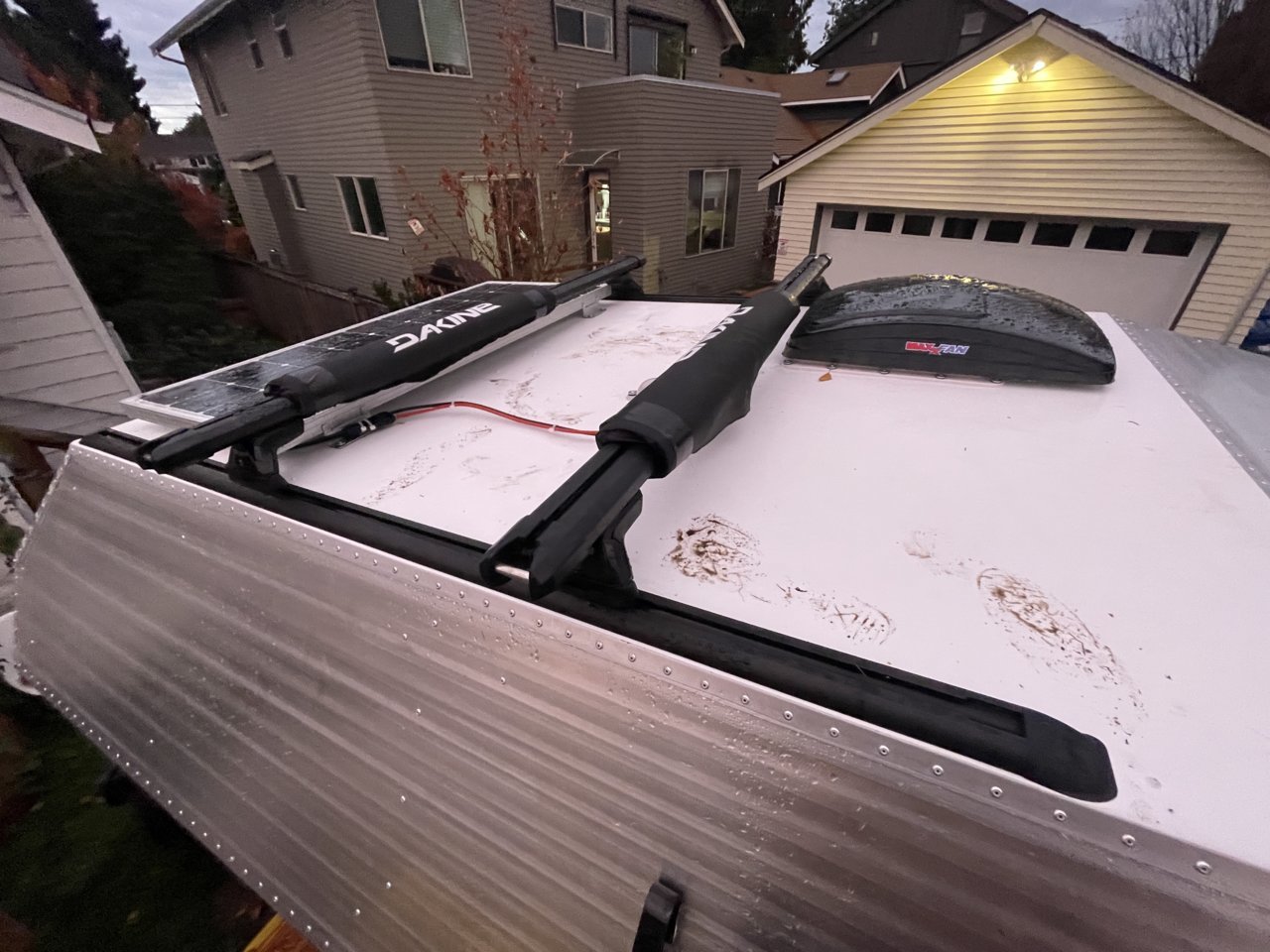

    They are indeed ... that's definitely on the list to remove! Happy to keep the rear and side decals, but the front is a bit much.

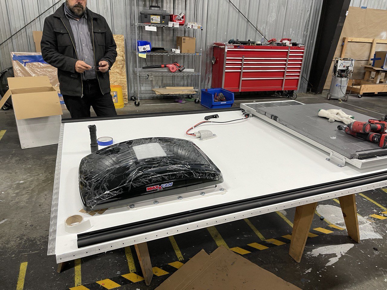

    Here's a pic from the factory on my particular kimbo — They reach the very front of the roof and maybe 12" or so from the rear of the roof — They don't overlap into the aluminum skin on the rear.
    This is with crossbars installed. Mounted a bit close for my taste, but should be fine.
    Jim and the team were really responsive towards the end of the build, as I asked for the roof tracks and maxxfan about a month and a half before my pickup date. There was some finessing needed, as the fan and solar panels mean there's not a lot of room up there — I'm fine with that, as the only thing I'll have up there are 2 surfboards in bags.

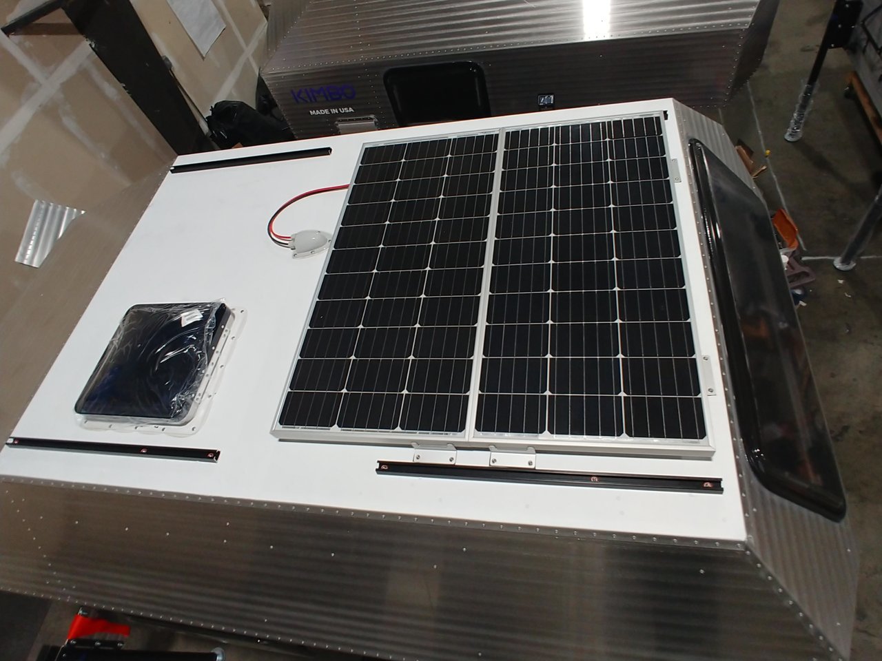

    When I initially asked about adding roof tracks, they sent me this image as an example of previous mounts they've done. I'm sure with some finessing one could mount higher towers and reach over the solar panels, but mine (Yakima Streamline/Skyline) were about 1/8" too low.
    Overall they seem very sturdy, but the main concern is more likely having the weight up top impacting handling vs. what the structure can handle.
