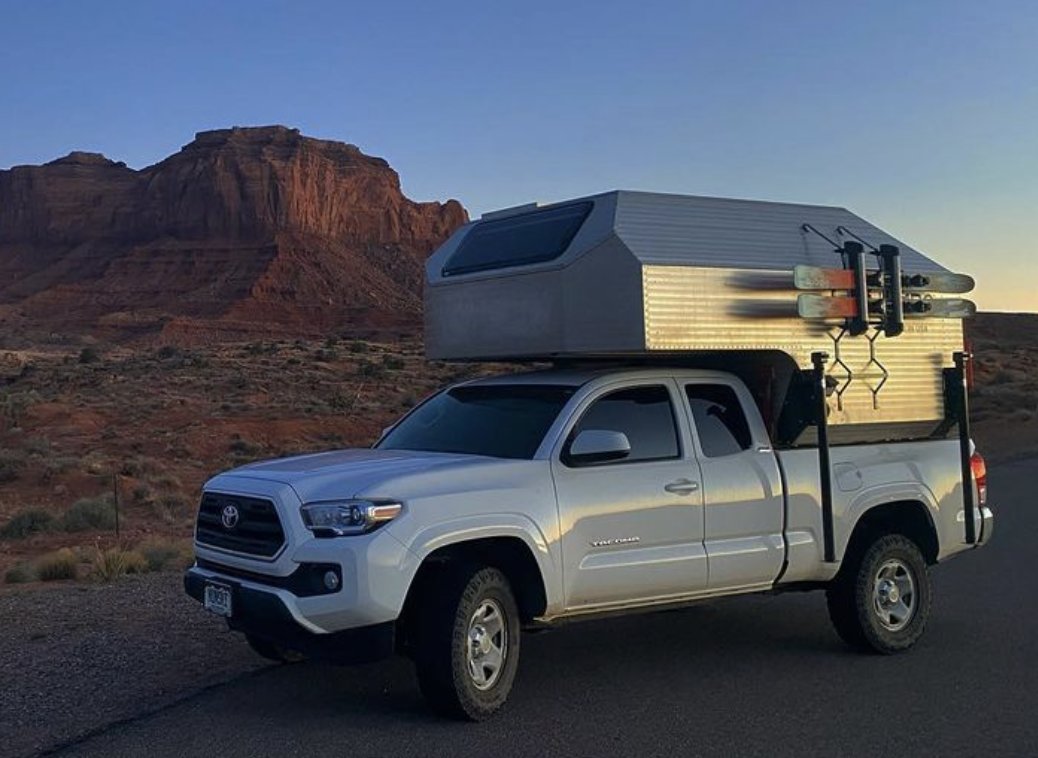

    Another option for a snowboard rack is off the ladder. I was able to find a Thule 3 ski rack on Craigs List in great condition for $30 vs $270 depending on which brand you go with. No drill option and removable in the summer. May be a little awkward loading.
    Eventually I would like to get a simple L shape hitch fabricated and mount the rack on top flat. Similar to this but with smaller steel box bar and raised above the tailgate. It would work with my swing out.

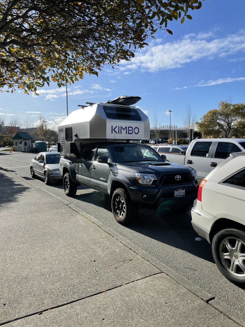

    Took the thing on a ferry to the Oly peninsula this weekend. Roof racks held my 8'10" board just fine — a bit harder to load/unload than on my old canopy, but easy enough even in the rain.
    Waking up to the view from above is just so cool.
    And an aside — My Iceco VL35 fit the kitchen area nice and snug. The lid works as a bit of a kitchen counter for the time being, but looking forward to building a proper baltic birch counter around it. My initial slide-out fridge idea won't work with this fridge as it doesn't clear the rivets on the propane cubby, but thinking I'll need quite a few more trips to really figure out my needs.
