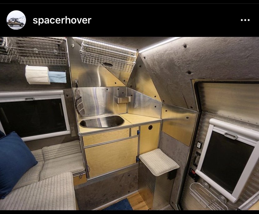

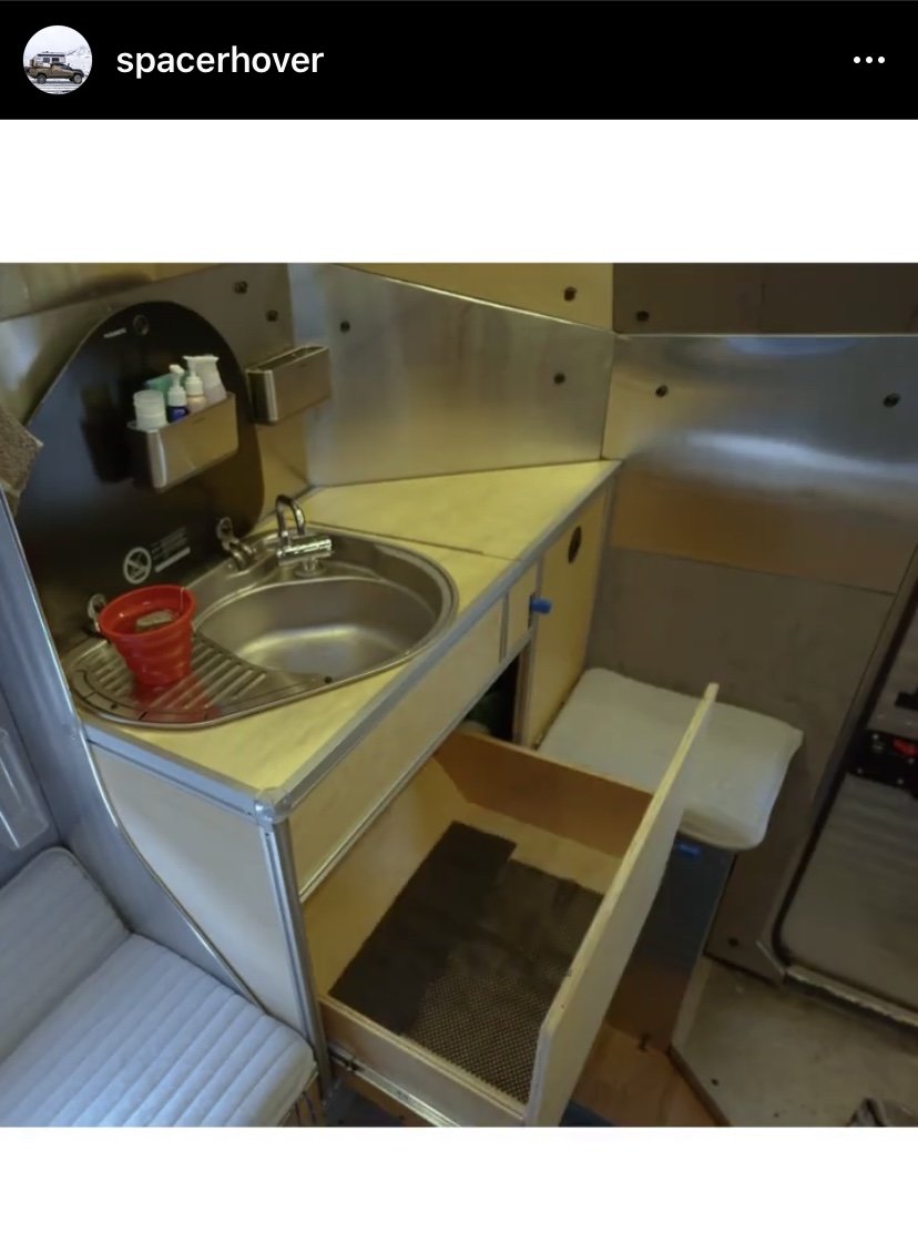

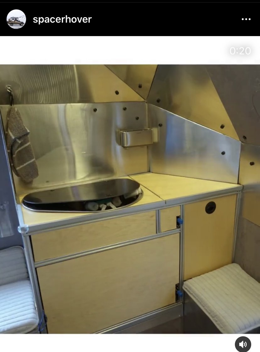

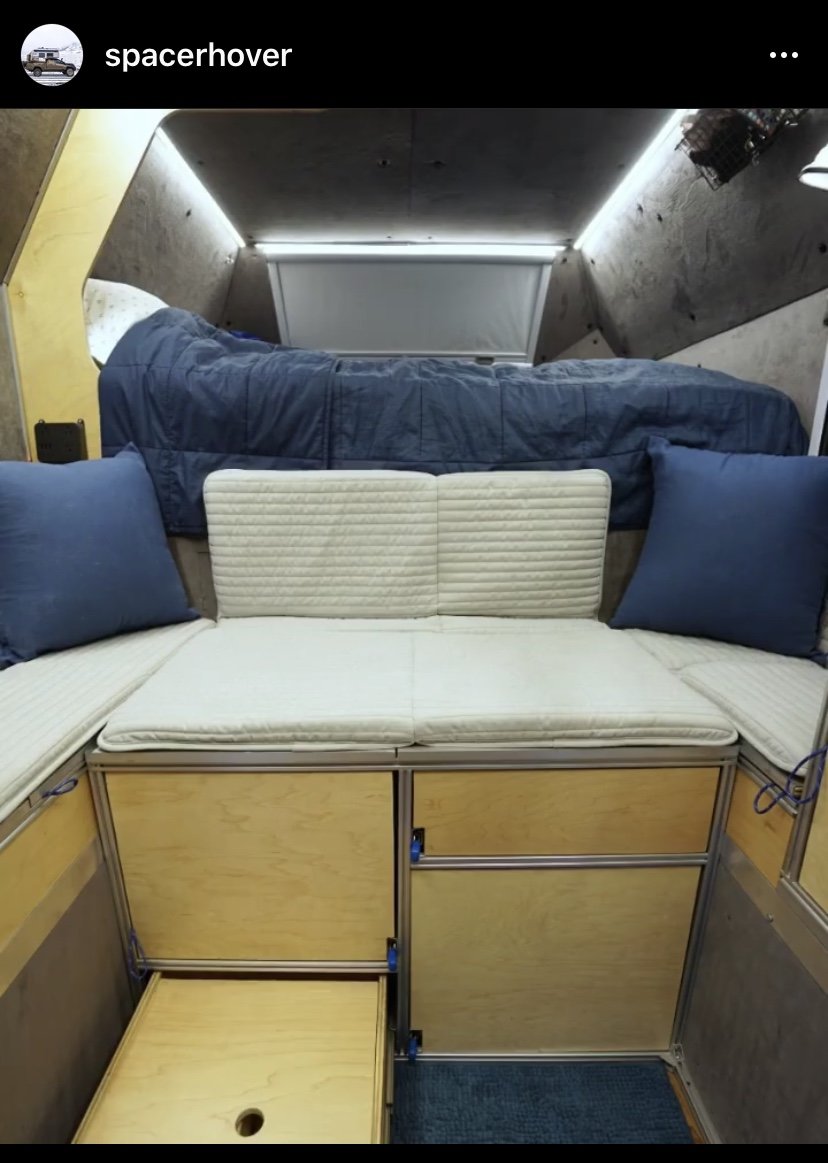

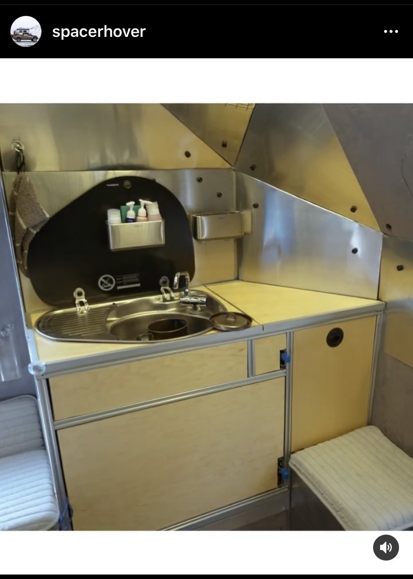

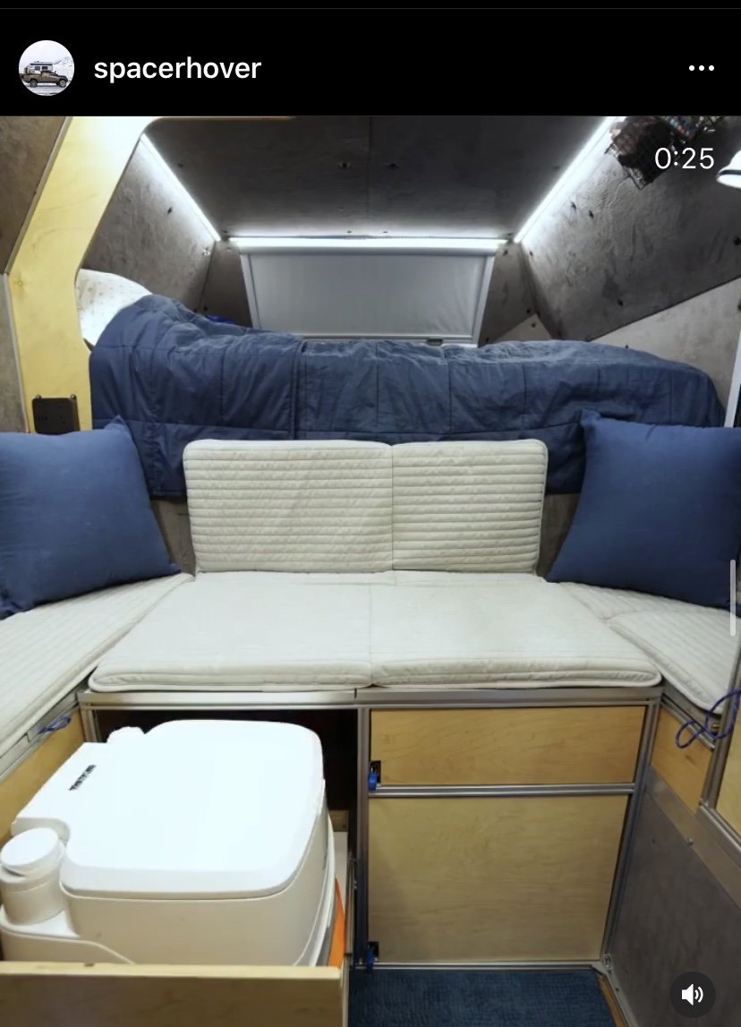

    I snagged some images off of the Instagram spacerhover account listed earlier in the thread. The person redesigned the interior and as someone debating purchasing one for full time the interior design is spot on for comfort for extended use. I just wanted to share some of the possibilities. He also included one of those RV tables that is hidden on a swivel behind the drawer set up. If Kimbo utilized this design or something in line I feel that it would draw a larger market.
    YodaTacoTuesday likes this.

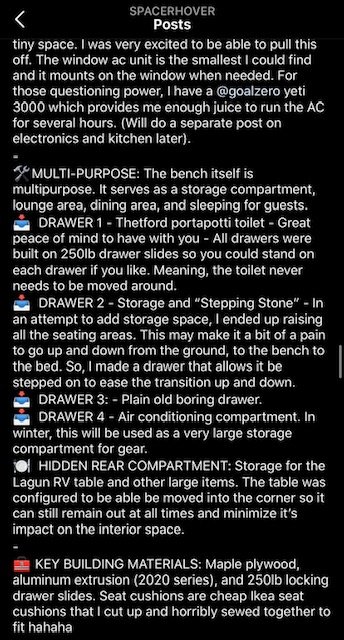

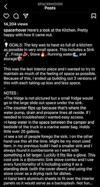

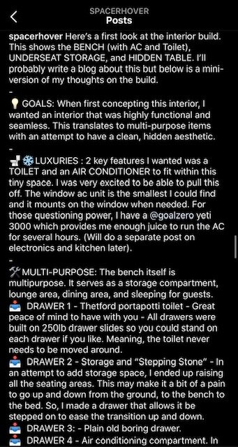

    This was the instagram account from the post earlier in the thread. Additionally, I have include the text from the persons post regarding the interior design which I found to be interesting. Kimbo really should take note on the design process. It will never be perfect for everyone and I understand that but it is a cleaner design.

    Yeah his account is great. I’ve talked to him a few times for questions about his build. He definitely got it dialed in but does miss some floor space with that design he says. We are getting a base model and building it out too which allows me to add my wood stove the way I want. Kimbo is in the process of designing more modules for the interior but yeah more options would be great. But honestly I probably would still like to design and bullied my own.
    edit: I do remember him saying he definitely carries a lot of extra weight when we are talking tires.

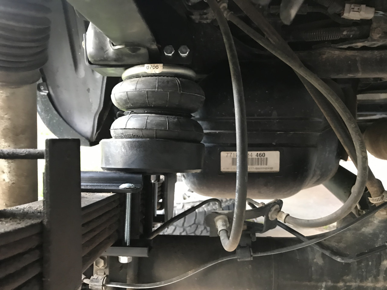

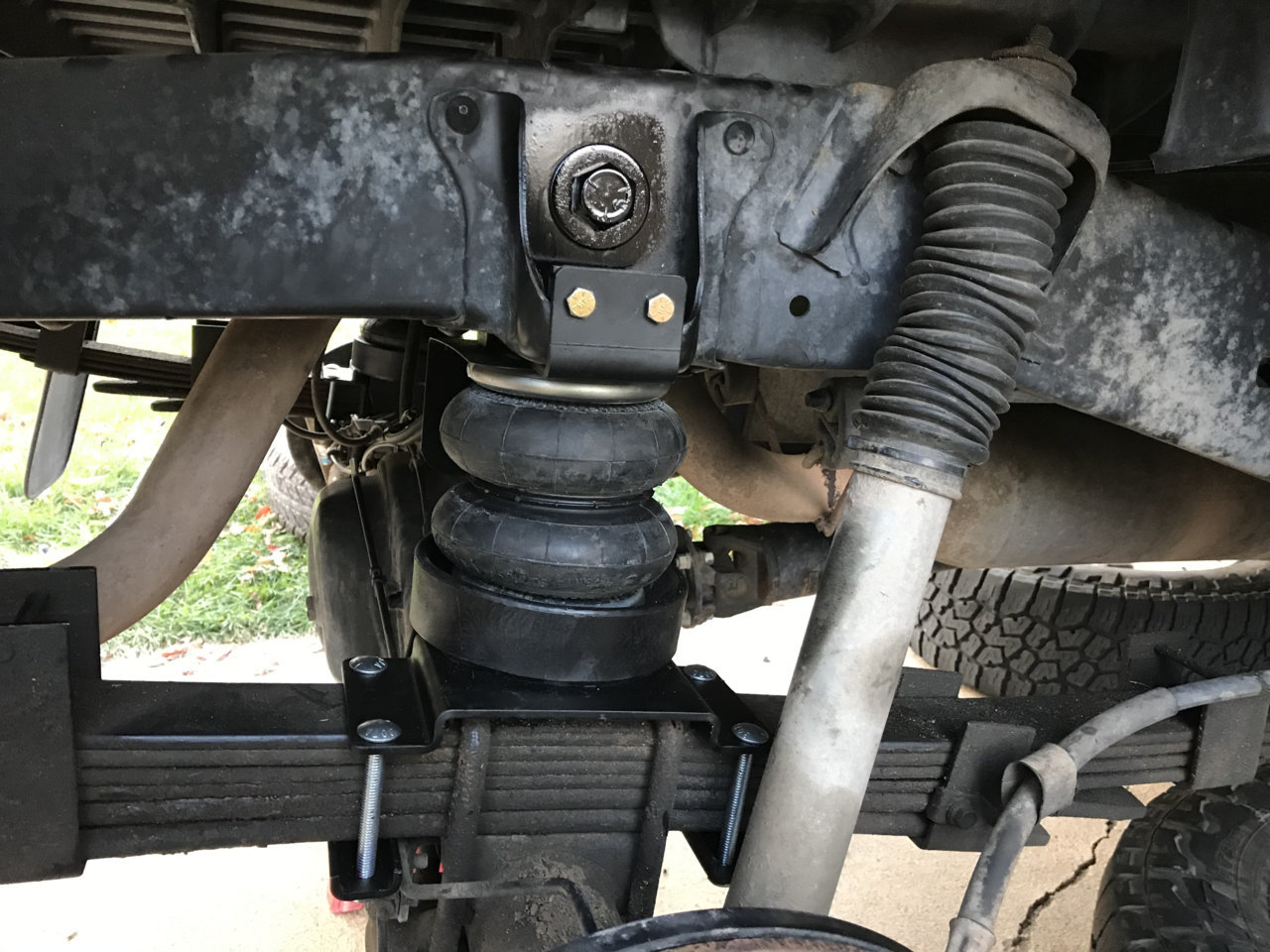

    Just a heads up, I switch the T union for separate valves. I was told by a member that air could shift from one bag to the other causing more wobble. Made sense so switched it.

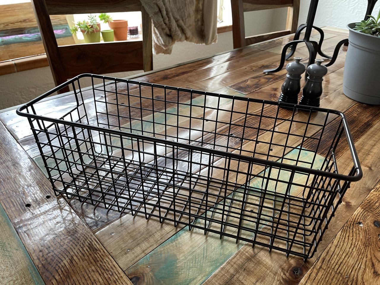

    Baskets for Camper:
    I just received these baskets and I believe are the same or similar ones used in the Kimbo. If you are building out a base model and decide you want baskets for storage or different colors and sizes, here they are. I ordered them in bronze and it looks to be of very good quality, almost black in low light. Counted the squares to be sure. :) I went with these since there looks to be mounting spots that are the same in all campers and these would fit the same. There are other styles to choose from. We will be bringing these with us for the return trip back to CO to have some storage available easily.

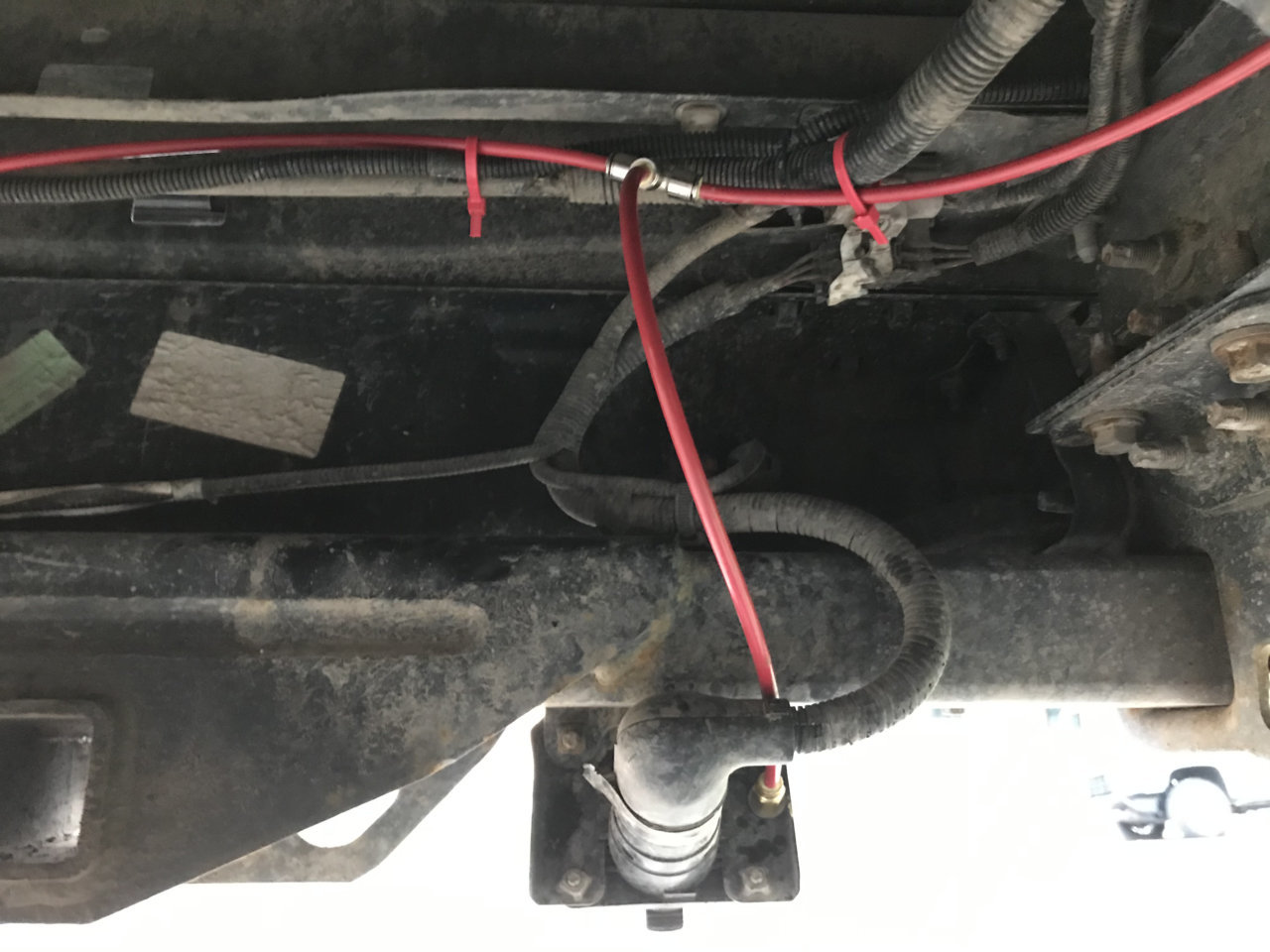

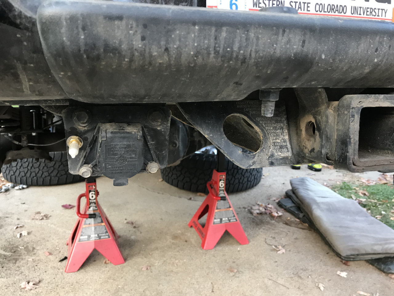

    If you are getting airbags, I would carry this as part of your SHTF kit. One of my connectors didn't seal properly so I used this silicone tape that's good for over 900psi/500 degrees until its warm enough to redo the line. I'll probably back-up all the connections with this stuff since its so easy to work with.
