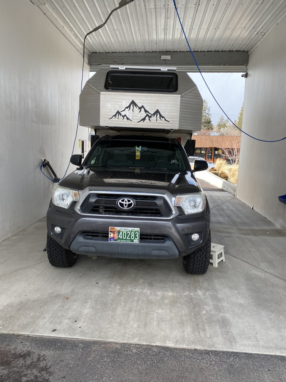

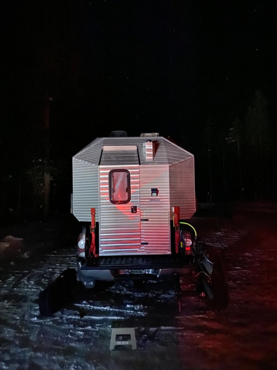

    Put the Kimbo to the test fresh out of the box this weekend! We camped in the national forest right outside of our local ski resort and temps were V cold. The first night we had a low of 1 degree and the second night the low was about 15. We had no condensation other than the door (which froze completely), and the AC steel box WITHOUT A WINDOW CRACKED. We also live in Central Oregon though so the climate is dry.
    Super satisfied with how warm and cozy the kimbo kept us, and also how quiet it is on the inside due to the insulation! We camped in a snowpark that is very popular for snowmobiling apparently and woke up surrounded by about 20 sleds and we had no idea they were that close to us lol.
    A few hiccups along the way:
    1. The demotic fantastic fan wouldn’t start because the sensor was frozen / cold. Collin from Kimbo is sending over some lube to prevent that from happening. Once the Heater was running for about an hour, it started right up though.
    2. My Grey water pipe froze which could have been my bad lol. I don’t know if it was angled enough for all water to Drip out or if it froze instantly while traveling down while washing dishes. It’s still frozen so I’ll pull it through from the inside tomorrow and see if I can melt the water.
    Massive storm just hit Central Oregon so I’m thinking of “camping” up there again on Wednesday night if I can get internet installed by then! Wish us luck, the mountains getting about 60 inches from now until then lol.

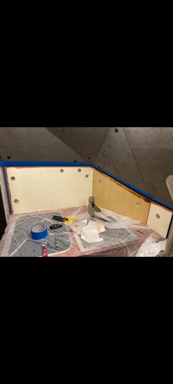

    Hello!

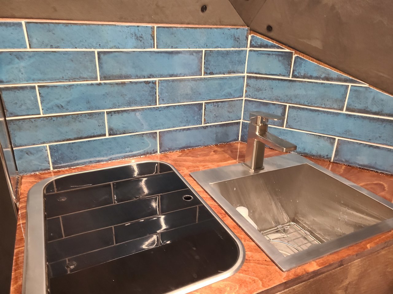

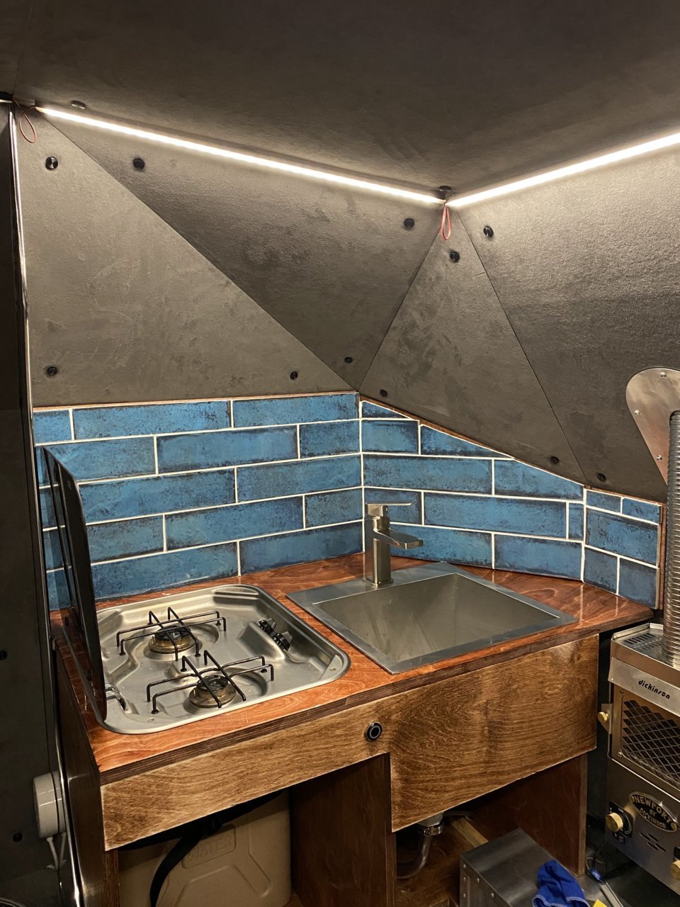

    Colorado Kimbo #111 here. I wanted to share my kitchen. Camping means cooking. There were a lot of firsts for me during construction. I was inspired by the space rover's clean cut kitchen but needed more utility. I found the stove from an Airbus that was being refurbished, which I thought was real fitting. I can hold 5 or 10 gallons of fresh and I drain grey. I still need to get around to those cabinet doors.
  9. Jan 3, 2022 at 9:24 PM
    #1009
    Voltron4x4
    Voltron4x4 [OP] Well-Known Member
    May 2, 2017
    #217975
    2,078
    Denver, Colorado
    2014 Black Trail Limo
    This and that...
    Damn that looks good! What did you attach the tiles to? Nice work.
  10. Jan 4, 2022 at 7:56 AM
    #1010
    Flashmax1235
    Flashmax1235 New Member
    Jan 3, 2022
    #386282
    3
    Thanks! I used some 0.5 plywood and stained the edges to get it a warm barrier. I also used the threaded rivots there already to hold the board in place, but most of the weight goes on the counter top. From there, I glued the tile using some semi flexible adhesive and generic grout. No cracking so far from being on the road.

    That looks great! I like the way you fit everything into that corner but is still a decent size - with a cover on the sink most of the counter is still useable too.

    Oh yeah, meant to mention to take your time on the doors - in the winter you'll definitely want the heat to get under there and keep your water from freezing...just a consideration.
    lakeswimmer likes this.
  14. Jan 4, 2022 at 8:37 AM
    #1014
    Flashmax1235
    Jan 3, 2022
    #386282
    3
    Oh good point. Maybe a tiny computer fan can pull air back there.

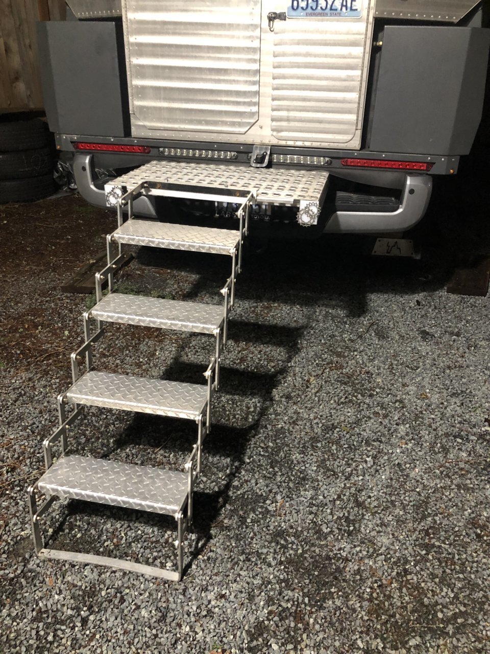

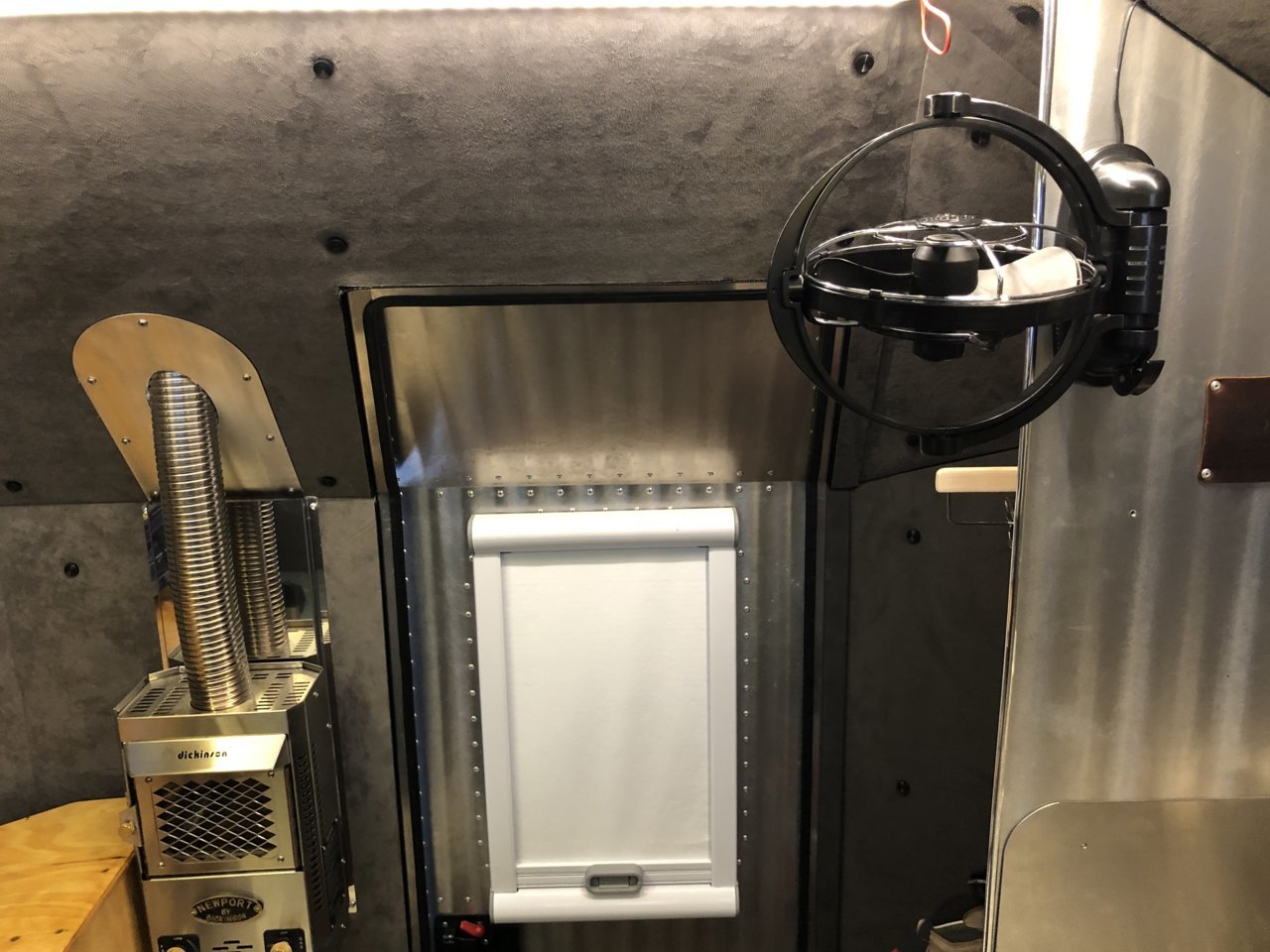

    RideRite airbags
    Couple updates on projects - porch 1.0.
    This is still a work in progress but the addition of a cross member has stiffened the porch up significantly. Added some test endcaps that might look fun with some LEDs mounted behind them, offerup clapped out stairs were rebuilt with new nuts/bolts/washers and all the corrosion removed.IMG_3074.jpg
    Extra sleeping platform/bench seat, table, and fan are in and working great!

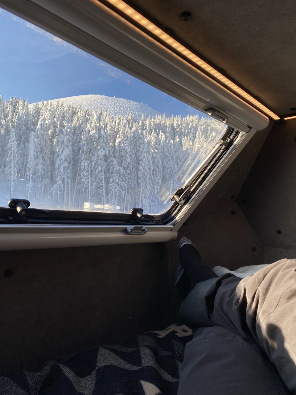

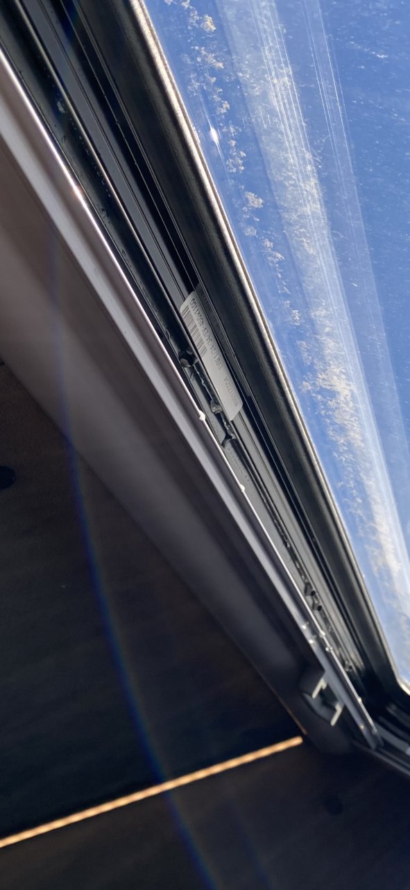

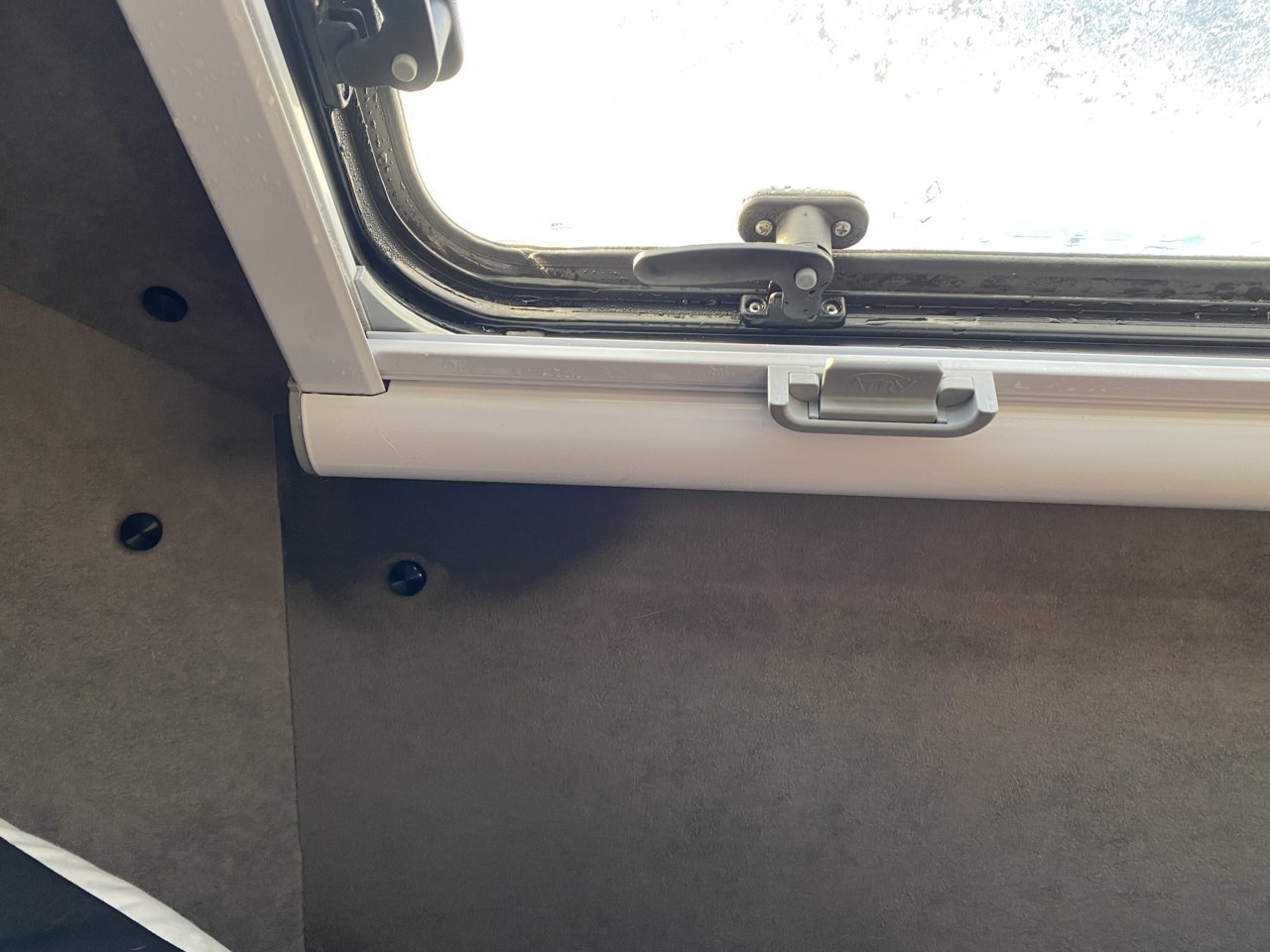

    Spent the weekend up at the mountain again for an awesome bluebird weekend. In the morning, our front large arctic window was dripping water pretty bad from the ice melting (also from the fantastic fan as well). Do you guys think this is bound to happen, or should I investigate a potential leak in the seal? Once it unthaws for about 15 minutes it stops dripping.

    It's likely frost melting from the moisture you produce inside - but keep an eye on it, if it produces moisture when raining - you have a leak...otherwise, it's a venting issue. More heat and more ventilation is needed...we cranked up the heat and added another fan to help with the heat stratification/moisture/condensation and we're creeping up on a solution (for our climate...).
