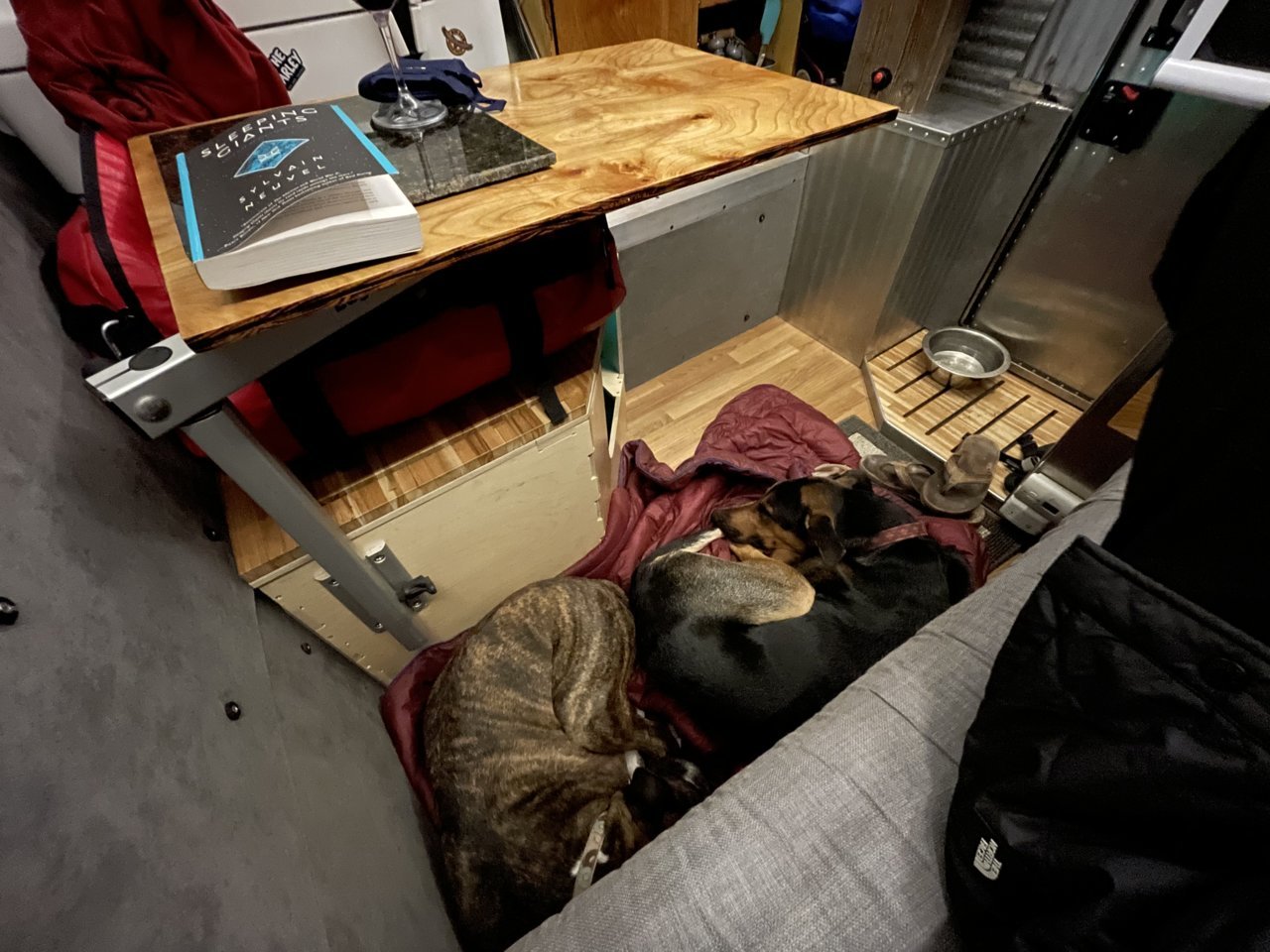

    Good question. I’m currently fitting my girlfriend and two dogs in it as well. We are getting along very nicely, but no plans for kids though. Short answer, you can make it work. Will you be happier in something bigger with a kid/newborn, most likely yes.
    The seasons or weather you camp in will have the biggest impact. In the spring, summer, and fall, we are outside most of the time and only need the camper for sleeping and sheltering during a little bad weather. Winter on the other hand you'll be spending more time inside with the shorter days and wanting to stay warm. How you camp and how active you are can have an impact on the amount of comfortable space you need. I would try and imagine some of the scenarios mentioned above such as changing, eating, cooking, feeding dogs,etc. Will you do these things inside or outside. Then see if you or more importantly your GF would be happy in a Kimbo or something larger. With a newborn, that brings in a lot of other scenarios but don't know what that timeline is like. Those things can fit just about anywhere right? Storage unit could be a playpen...
    For reference, below is the space with 2 medium-ish dogs, around 60-70lbs each, on the floor with cooler and duffel on the other side. No issues when eating or relaxing inside during the mild months. I have yet to winter camp with them all longer than a couple of nights. That went well too but longer would be interesting. Hope this helps think it through.

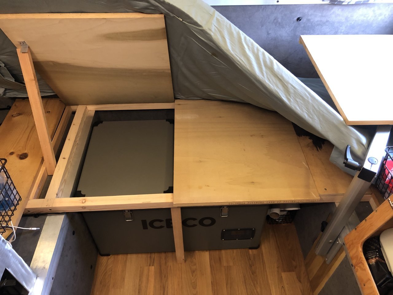

    For the winter campers out there - working on a warm door cover (basically a warm window cover for the door - using the special quilted and foil lined fabric) solution to keep the thermal bridging at bay on the door. We noticed that when we direct the fan towards the door to keep it from freezing up, the door cools the air significantly and then the furnace has to be turned up to compensate. We're hoping that a warm door cover that snaps on to the inside of the door (with a cut out for the handle and a flap for the window) will help mitigate a healthy portion of the heat loss. The plan is to install two snaps at the top of the door and a couple going down the door to hold the cover in place so it won't catch in the door seal or flap around when going in/out of the Kimbo. Should have a version 1.0 in the next week or so, looking for a decent outer pattern at the moment.

    Super rad. I really need to get on that second platform too. Yours looks great for lounging. That porch is solid too. Nice work.

    Thanks, I stressed quite a bit about how to build the platform and ended up throwing something together due to a trip to Idaho next week...it's built with 1x2 and 2x2's with 3/4" scrap plywood top and some piano hinges to allow fridge access. My mother-in-law is a seamstress so she's working on the warm door cover and the mattress cover for the bench (right now there's just a sheet over it). The span across the top of the fridge is pretty far and I wanted to get fancy with a seat/back that slid down to expand for a sleeping area and compress for a sitting area but I was over complicating what we needed, so keeping it simple until we figure out what needs to change (if anything).
    With that solar cubby you have, there is a much shorter span to deal with - should allow for quite a bit more options...I have the cover and cubby from ours that is just taking up space in the garage if that's something you can use to integrate there.
    Hopefully the additional parts for the porch will be found soon - ideally it will only stick out a couple inches and pull out to be twice as long when finished. Want to be able to put a bike rack and bikes in the hitch while still being able to enter the Kimbo on the porch with the stairs attached on the side...we'll see how that ends up.

    I think you went the right route with your setup and can make finishing touches to the platform it if needed. The width looks good. Maybe add a pop up back rest for the laying length wise. It could hinge and just rest on the left wall, like a little ramp.
    I think I'm going to go for something I can store under the bed and pull out when I want the lounge/sleep platform. I may have to use that second table mount for when the platform is down. I appreciate the cubby offer but I don't believe it would fit opposite, but that would be nice.

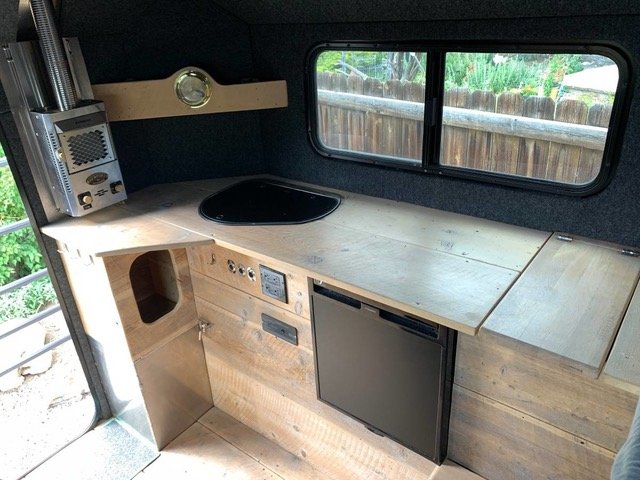

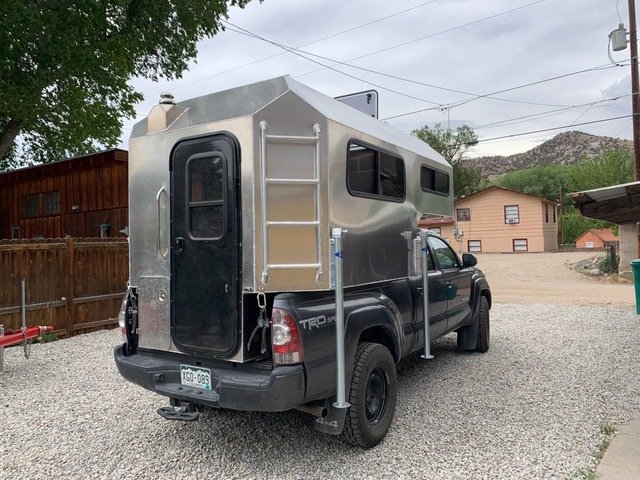

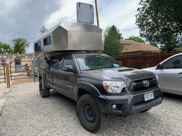

    Forgot to mention that when I was in Gunnison, CO I pulled up next to the owner of this custom "Kimbo." We gave a little wave and I pulled in to get some coffee. Was hoping he would circle back. Maybe next time.
