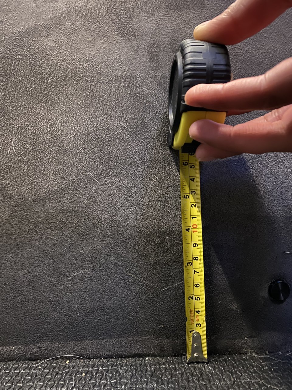

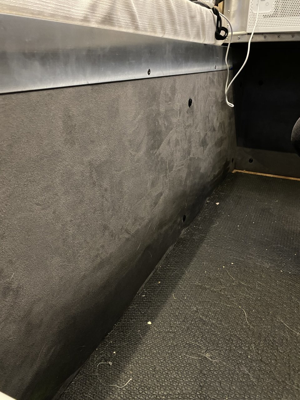

    1. The bottom suede got damp all the way around from frequent change in temps (top stayed dry and cozy so didn’t bother me much). Cole from Kimbo is doing a pressure test on Tuesday to make sure I don’t have a leak.

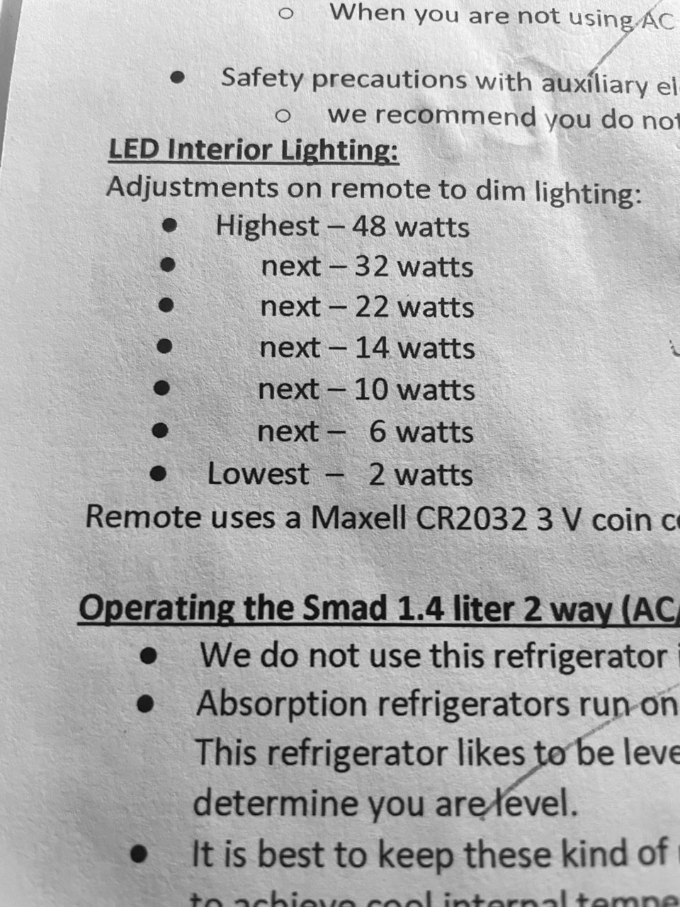

    Sounds like some cold temps! If you don't mind a few questions...
    1. did you experience any interior ice other than the AC unit? pics of THAT would be awesome
    2. do you happen to know how many amps those lights pull at the brightest setting?

    Bottom of the suede got damp all the way around? the entire panel or was it wicking up on the lower edge that touches the floor? or??

    hey @RT395, also had some pretty bad moisture / ice around the bottom of the Kimbo. I am getting a pressure test done tomorrow to make sure there are no leaks in mine (fingers crossed). pics attached.

    the bottom suede all the way around. I’m getting a pressure test done again. Might have a leak unfortunately.

    I have this from the check out at Kimbo. I’m guessing the lights haven’t changed. Hope this helps.
    48 watts / 12V = 4 amps
