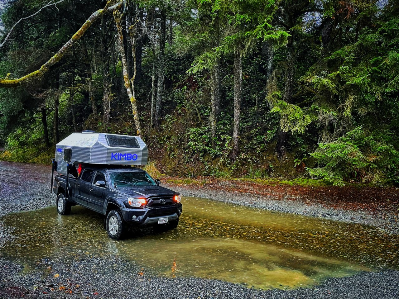

    DC7B75FA-FC4D-4FAE-8270-0E1FA7C5AAF3.jpg C39484A3-198F-4D02-B03D-E18C44E1BDA6.jpg C45392F1-D8CC-42A8-B5C2-B462F6FA2321.jpg E69A4795-5C77-45B0-A475-33CEB3932F70.jpg
    Traveled down the Oregon coast and camping at in the Redwood State Park in CA for Christmas. Loving this camper.
    The pick up went great and was able to load up inside since it was dumping outside. Had all my questions answered but definitely have a few more when it comes to modifying mine. Collin showed me all around and explained how everything is sealed, all top grade materials. This Kimbo is crazy airtight. If you have a window open with the blinds down, the ceiling fan will totally suck them in, one of the warnings during the walk through. We ordered a pretty basic build, but were surprised that they still wired multiple 12v wires for accessories normally meant for the fridge and fan for the propane heater.
    The first night we stopped at a Lowe’s and picked up what we needed for the baskets and they are working out well. Looking forward to building out the rest.
    The truck has been handling the camper very well. One full tank came in at 13-14mpg averaging about 60-65 mph. On some decent steep grades the Tacoma is holding 2500rpm and cruising up at 50 in some cases in the slow lane. Do take the turns slow. If it says 45, your max should be 45. Slow and steady is the name of the game. Navigating in the city and town is exactly what we wanted, simple. Already parallel parked it a couple of times.
    Will try to check in and answer any questions the next couple of days but won’t be back home till Thursday I think. This camper is exactly what I expected and then some. Excited to get it to its full potential.

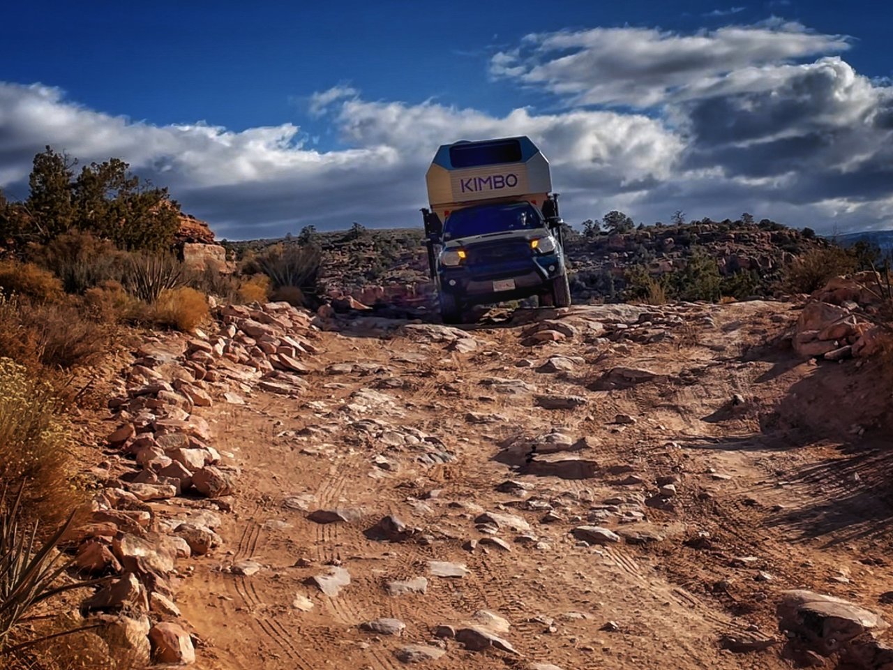

    Well definitely a solid test of the camper on the way home, 4,000 miles done. Finished with a trip to the edge of the Grand Canyon over some good high clearance obstacles. The only issue was stretching the tie downs in the bed. Will be adding some metal to that to reinforce but don’t see myself taking it over any like that again anytime soon. With good dry heat the camper is incredibly comfortable and after 10 nights on the road we are feeling refreshed each morning. Looking forward to not having to push so hard to to get home. Back in CO now and looking forward to the build out.
    80F3D27B-F65B-4C93-8E3D-581FC536383C.jpg 2283CB47-ADC5-41A8-BED3-733E783AD392.jpg 3AF56171-F036-4E91-A4E8-9D6C3D95B9D1.jpg 6AD5FA4C-E6EE-46CC-BC5B-C3AEAC366EA4.jpg

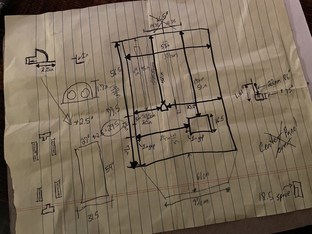

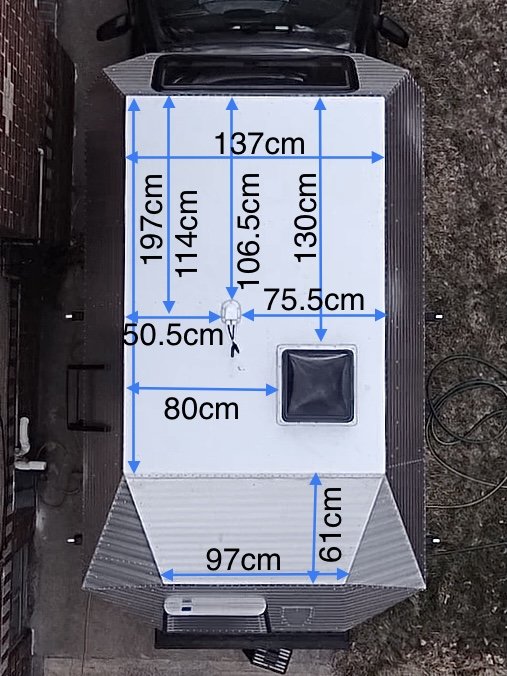

    Here are some measurements of you are planning to do your own solar or other rack system. I’ll be going the no drill method using VHB permanent tape and Sikaflex adhesive. Looking at using a combination of 14g superstrut and no drill solar mounts as backup. With the superstrut, the panel will not sit flat on the no drill solar mounts but there will be a enough of a lip to still hold in place. Will add specifics after I confirm the fit. Looking at the Rich Solar 200 watt. Lots of measuring and getting creative going on the last several days. Measuring twice, cutting once and no drilling in the roof for me.

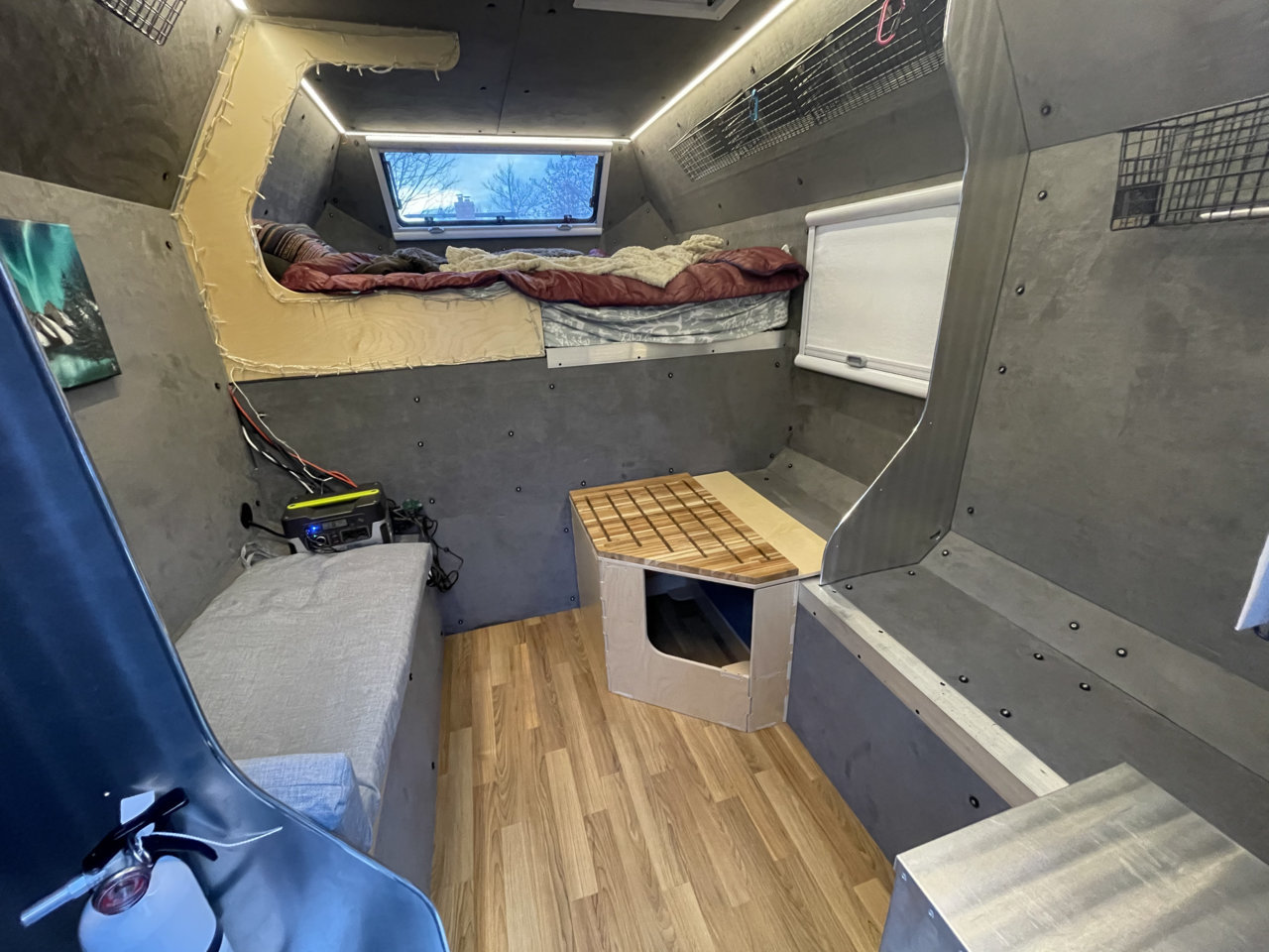

    Denver, Colorado
    2014 Black Trail Limo
    This and that...
    Interior all cleaned up. A good look at the base build for your own build out. The solar wiring has been added on top of the base with propane door on the outside. Baskets added ourselves.
