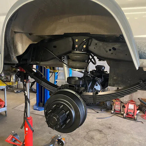

    You can off road without any issues with the airbags as long as you have cradles instead of attaching both ends of the airbags. This allows full articulation of your suspension. As long as you don't plan on rock crawling with the Kimbo, you should be fine. If your concerned about having airbags on the trails you'll be traveling, you'll probably want to upgrade the stock suspension anyway. There are more than a couple of combinations to decide on. The airbags do give a good amount of adjustability depending on your own custom buildout and weight. You can always add more support if need it later.

    Got it. Check to see if they mean with or with out the Daystar cradles. I have about 2.75 of lift with OME medium duty leafs in the rear and extended length 5100's. I can go full droop and not worry about the airbags. Granted if Im in that situation with the Kimbo I'd be in trouble. I've taken it down some 4 low trails to the point of stretching the rear bed anchors, which I then reinforced. I believe those would give out first or you would roll the Tacoma before the airbags would beak. Below are the cradles in use. There are definitely other options. You could get the Sumo springs or heavy duty leafs. With my medium duty leafs I'm just below level in the rear. Any lift though, you'll probably want to change out the shocks. Hope that helps.
