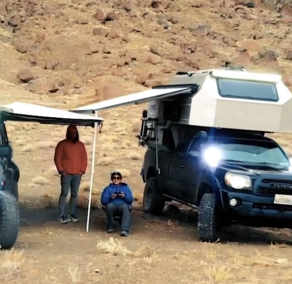

    Congratulations man! Looking forward to seeing that setup out there. @spacerhover on IG bolted one to the side.

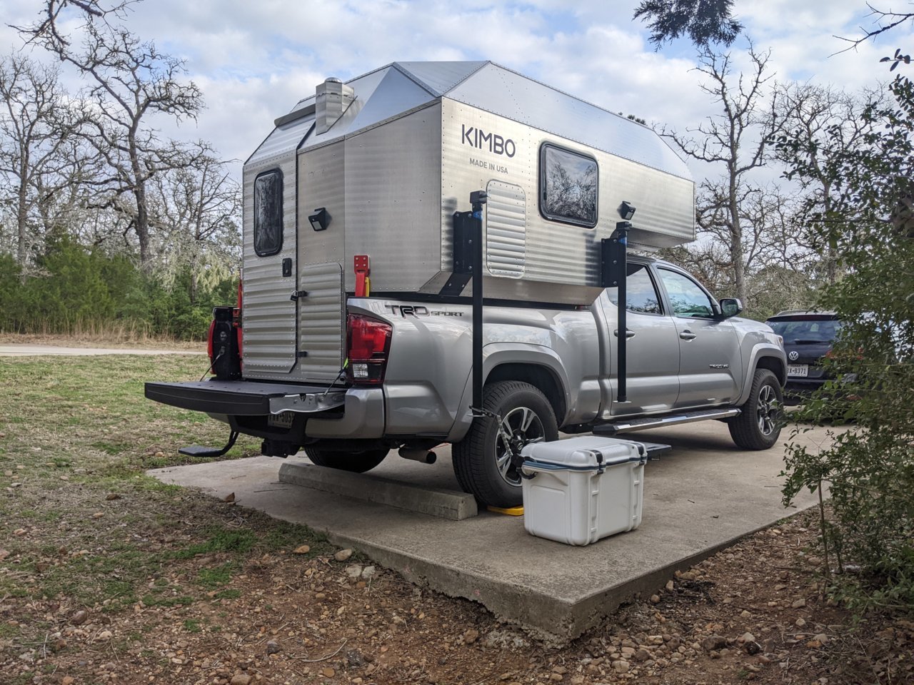

    received_686790482370632.jpg Just returned from the first trip with my new Kimbo. Very impressed with how it performed with the temperature swings. First night was in the 80's so we were running the AC and it worked very well. Subsequent nights were in the 40's and 30's so we were running the heater quite a bit. Keeping it on low with the fan on medium kept it between 60 and 70 inside while keeping the roof vent and windows cracked to manage moisture. After 5 cold nights we only used 1.5 lbs of propane! Very efficient. Looking at adding a splitter so we can also use the propane for cooking with a single burner stove and maybe leaving the canister powered stove that came with the shower module at home. Did try a shower in the Kimbo to test it out and it worked well. Was able to prop the water canister up on the AC cabinet and run the house through one of the clips to keep the nozzle overhead. Used the extra water to rinse the soap off the shower curtain and basin then left everything to dry before packing it up.

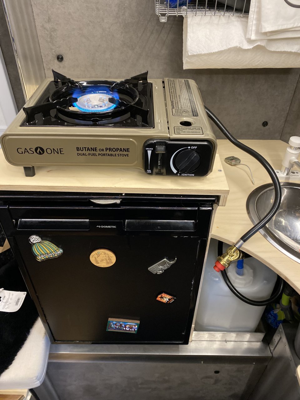

    I haven't been on this thread for a while, but thought I'd share what I've done so far in the Kimbo.
    Priority #1 was building a low tech kitchen, since we ordered our Kimbo with nothing but the fireplace and a few baskets.
    We opted for a cooler because the majority of our trips are weekend excursions, and even when they are longer, we're on the move a lot and inevitably driving by places where we can get ice if we need it — but rarely do. We're not typically packing much meat, so the temperature is rarely a concern anyways. So far it's worked great. It's a little on the small side, but hasn't been an issue, and is pretty much the largest I could fit into the kitchen design I wanted.
    Countertop is entirely bamboo, and anything else visible is 1/2" baltic birth covered in adhesive backed black wallpaper.
    Backsplash is aluminum panels cut to size and drilled to utilize some of the existing standoffs. I found the tiles on Amazon and those are peel-and-stick.
    Fresh water is fed from an easily removable Rotopax container. I used an extremely convenient, after market vent cap that just threaded in, which helps prevent a vacuum. On benefit of how I'm utilizing the Rotopax is that if functions exactly like a toe-kick in a regular kitchen; since it's mounted a few inches off the ground, your foot can comfortably slide under it. Practically speaking, it doesn't get in the way at all, so it feels like zero space is lost even though it visually consumes that space.
    Faucet is just one of those cheap battery powered water pumps. I made a little donut-shaped receiver for it. The faucet tension-fits onto that and stays put, but is extremely easy to remove.
    Finding something for the grey water was a bigger challenge. I ended up using a collapsable water container from REI, and so far it's working just fine. There's absolutely nothing else I could find that fit the space very well. Since it's collapsable, it's really easy to finagle in and out of the space. Took a while to figure out how to retrofit it into the drain, but I got it to work and haven't had any issues.
    For attachment points, I wanted something that'd give me flexibility in the future. Rather than attaching any part of the kitchen directly to the Kimbo shell, I opted to attach 1" 80/20 directly instead. The 80/20 is bolted to the shell, with a 1/4" layer of rubber between it and the Kimbo. Conveniently, this combination (1" 80/20 + 1/4" rubber) is nearly perfectly flush with the existing aluminum trim pieces, so the only modification that was required was cutting away the insulation foam. It certainly would've been easier to just slap things in with some self tapping screws, but I'm very happy with how this is working out for me.
    The last thing for the kitchen will be figuring a little more storage and baskets and whatnot.
