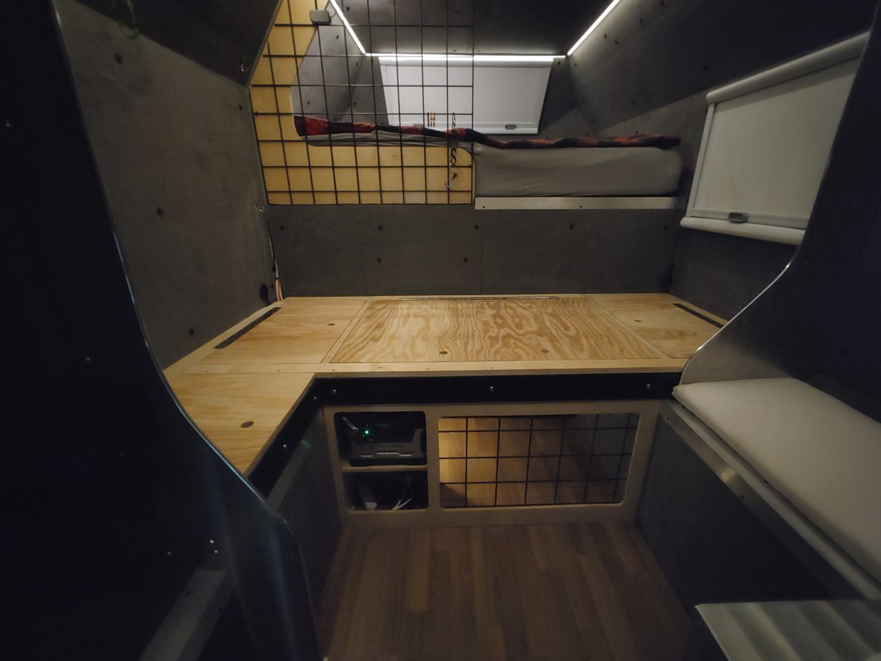

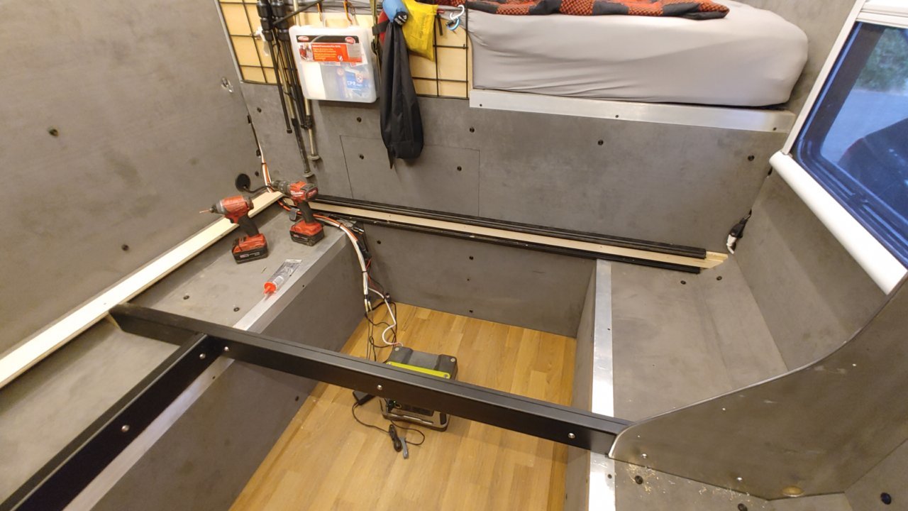

    DYI rear seat delete, under hood compressor, Falcon towing and Hauling shocks.
    Some before and after of a DIY Storage bench/electrical cabinet/2nd bunk. Wanted to build this entire thing out of t-slot aluminum but couldn't get any in a reasonable amount of time so had to improvise. I used Aluminum deck railing cap that I had left over from a job and some strips of light weight plywood to create the frame. Just used some ACX plywood for the top and finished it with a coat of Benite and 2 coats of Daly's Ben-Matte finish. Found a memory foam mattress that was 74"x30"x2" which fit perfectly (Not pictured).

    Profloundering Well-Known Member
    Jan 22, 2021
    #353585
    553
    2020 DCLBOR
    RideRite airbags
    Looks great! I happen to run into the same issue, so it turned into a proof of concept and hope to move to the 80/20 at some point when the refinements slow down. Can't wait to see how you finish it out.

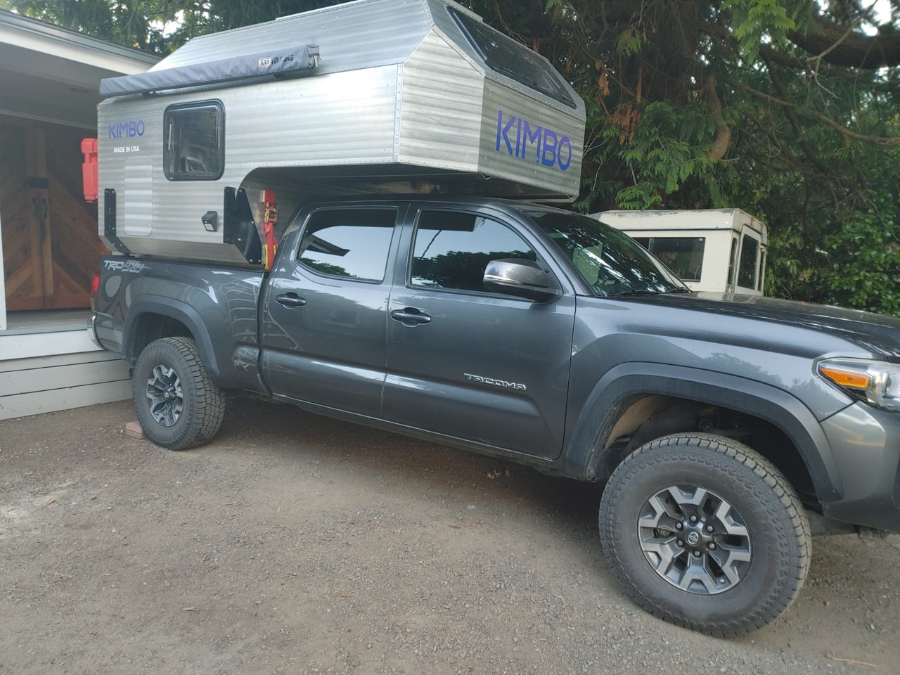

    Here is how I installed my awning. I purchased the standard awning brackets for an ARB awning. I had them modified so that when mounted on the sloped portion of the Kimbo roof, the awning side of the bracket would remain in a vertical position. I also made some backing plates out of aluminum to match the Kimbo. Did some calculations as to where would be best to mount the brackets. Drilled and mounted the brackets and then mounted the awning to the brackets. I did this job solo but would recommend having a helper. I used a healthy amount of marine sealant under the bracket and on the threads of the bolts. It has not leaked or moved at all in the 8 months since I installed it. Definitely a little worried about snagging it on a branch etc but so far hasn't happened.
    Standard Bracket.
    Modified Bracket and Backing Plates
    Drilling for the Bracket Install
    Done
