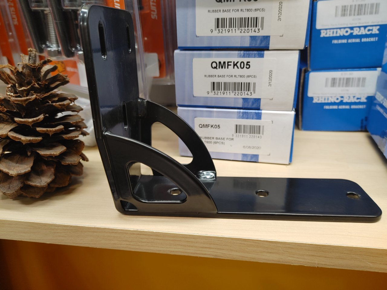

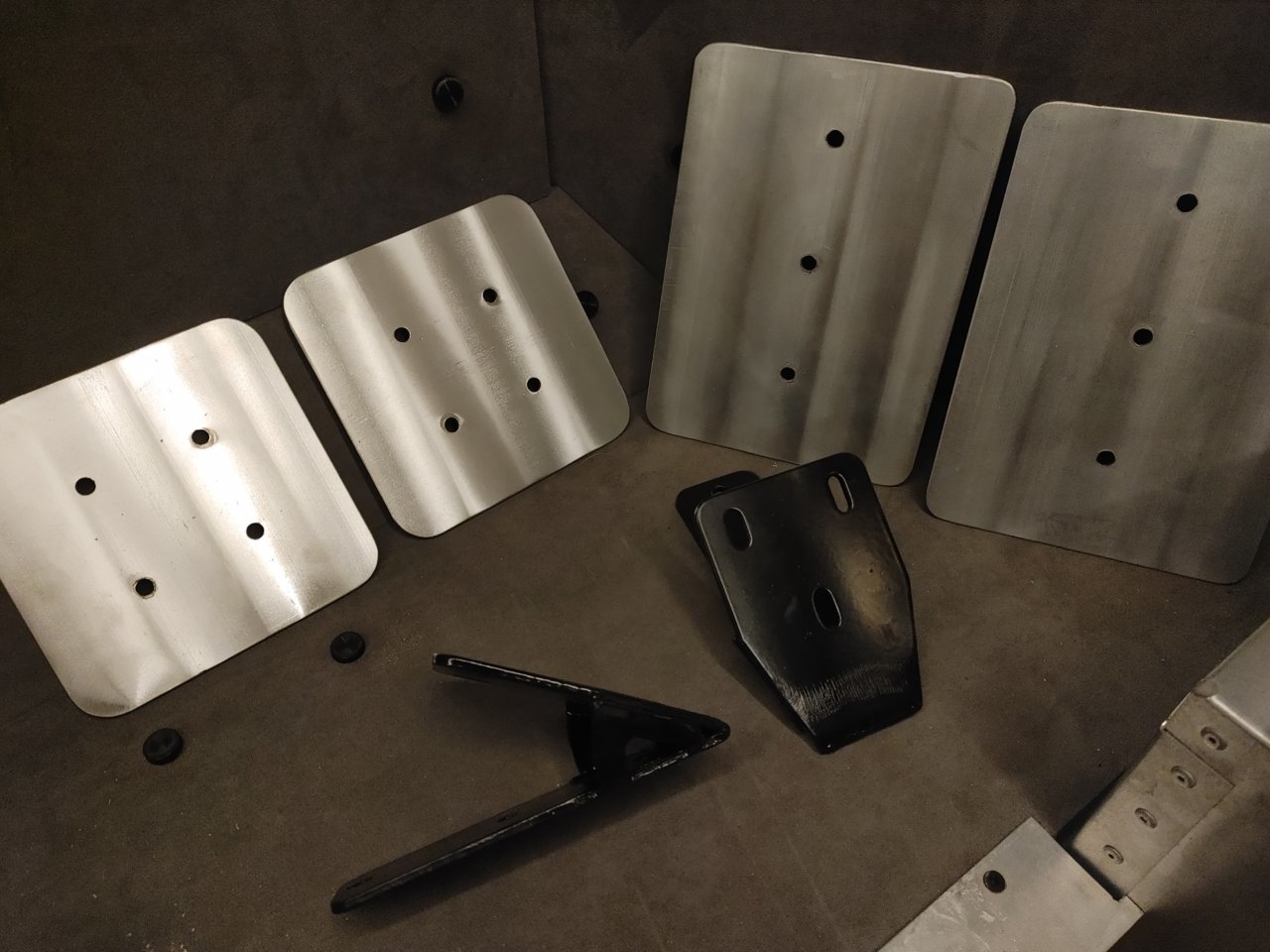

    Great idea to reinforce with large plates behind the brackets.
    How did you finish the aluminum to get the Kimbo scrub effect on the backing plates?

    I took an angle grinder with a wire wheel on it and gave it a light once over to create the look. Not perfect but close enough. One note on the backing plates, the longer plates with 3 holes in them were for the awning and the square ones with 4 holes in it were for the rotopax I have on the back.

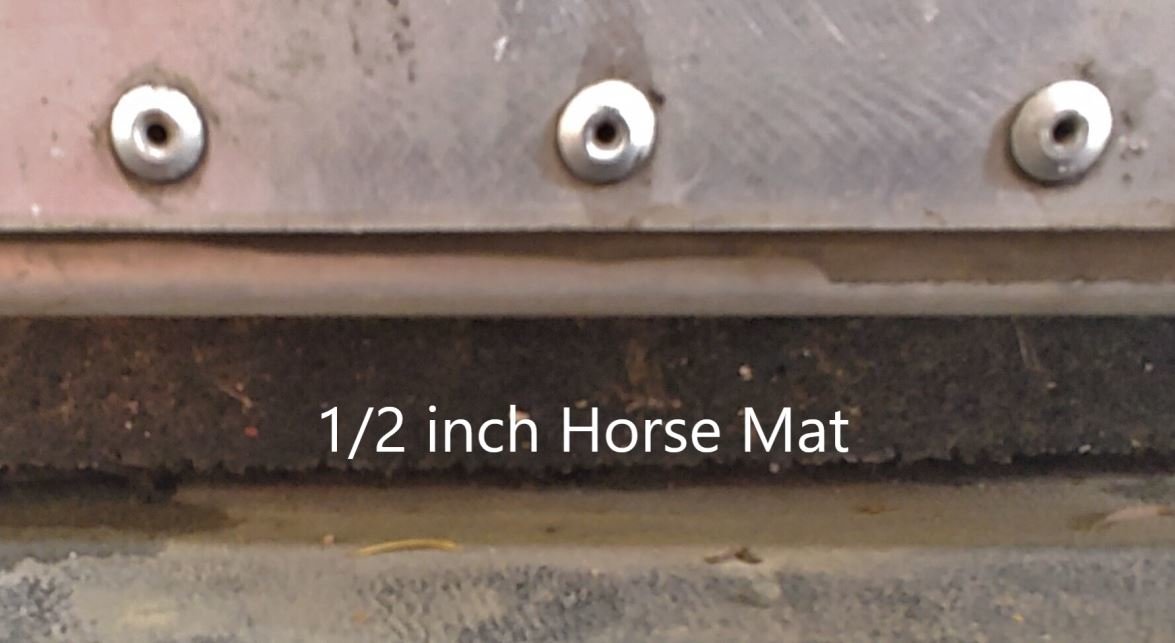

    I purchased a horse mat from a local horse supply place and cut it to the exact dimension of the bottom of the Kimbo. It's about 1/2 an inch of dense rubber. Prior to that, I had the Kimbo just sitting on the bed of the truck. The horse mat adds a little rvalue to the floor and cuts down on any rubbing caused by vibration when driving, to both the bottom of the camper and the truck bed. Works great.

    Was wondering about the 4 hole ones. Didn’t know where to source the metal so went with HDPE sheets.

    I got a horse mat for under the Kimbo to prevent it from sliding around as much. Might consider getting one at a local farm store and trimming it up for your rig. Congrats!

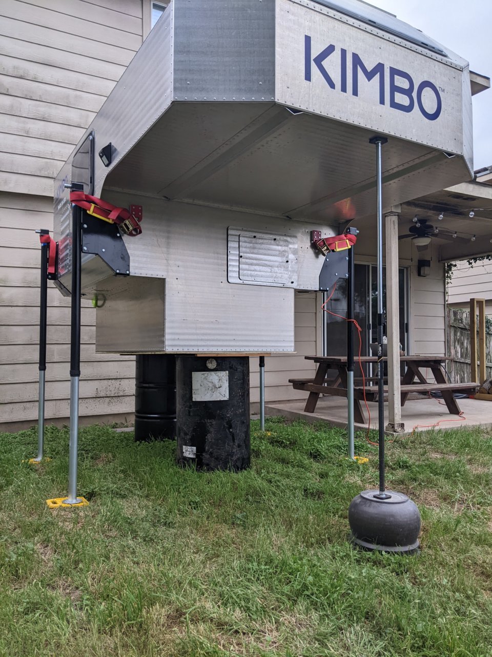

    Made a platform out of a couple barrels and some plywood to support the Kimbo at the same height that I need it to be for loading in the truck. Mostly just for stabilization when cleaning and loading gear when it's off the truck. Working on a sun shade for it next.

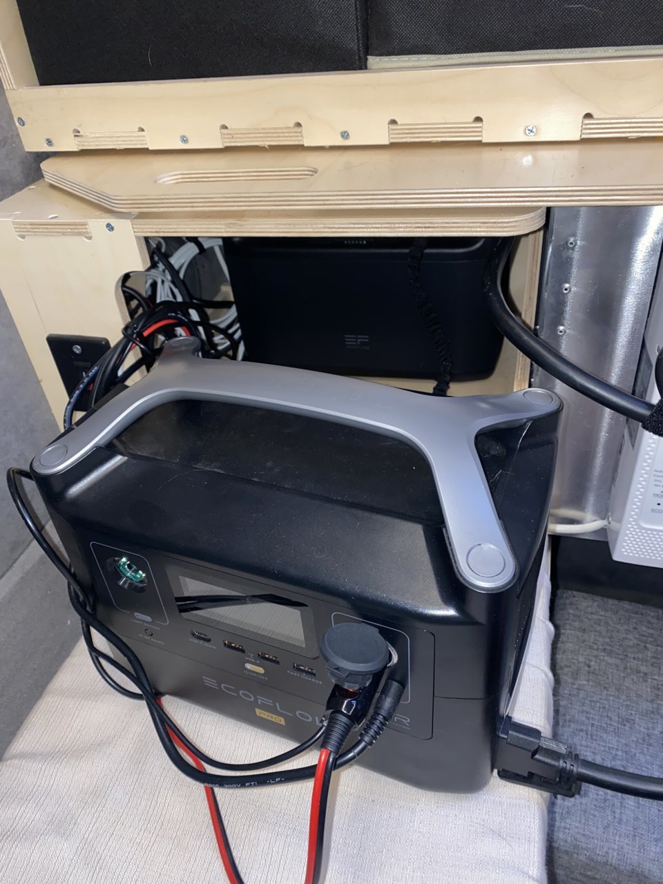

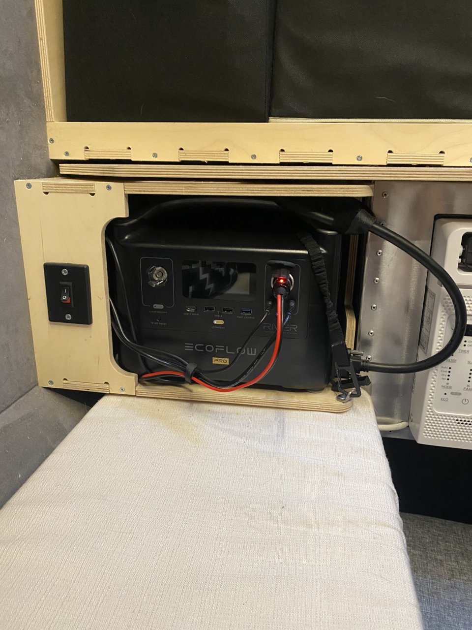

    Unrelated but has anyone gotten the new dual battery option? Curious as to where they place the additional battery, doesn't look like it would fit in the battery compartment without some modification.

    The extra Ecoflow battery is placed directly behind the main unit.
