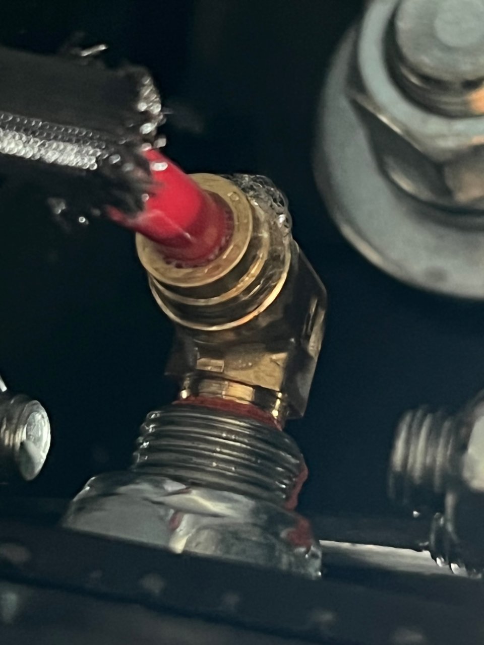

    OK--so the spray bottle immediately revealed the problem--connection right at the airline where it exits the airbag through a brass fitting. Probably an end that I cut--carefully, with a razor knife--that somehow didn't seat properly. There is no way to get to this easily without jacking up the rig and removing the tire. Do I dare do it with the factory jack and the camper on? Or better to remove the camper? I mean, it's conceivable I'll have to jack it up at some point with the camper on, right?

    Lemme tell ya, practice is always a healthy option - at some point you'll need to practice removing the tire with the Kimbo on but what you're working on requires access to the top of the bag and tucking the axle up there might complicate things a bit with no pressure in the bag to keep the axle out of the way. Maybe you can throw some air in the bag to give you some space to reach in and shove the hose into the fitting a bit more? It'd be ideal to remove the Kimbo while working under there, when removing a tire you aren't (usually) under the truck...also - USE JACK STANDS please...don't need anyone on this site having an estate sale.

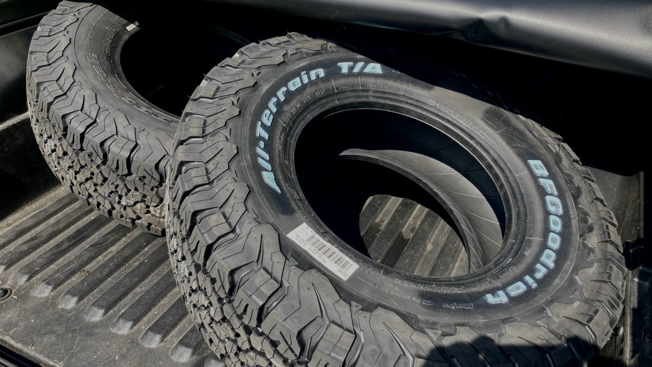

    Getting truck ready for my Kimbo, which I will be picking up at the end of this month. First up, new tires. KO2 All-Terrain E-Rated. I'm having them put on this Tuesday. Poll question for owners and wannabe-owners. White letters outside or inside? I've seen maybe three vehicles in South Florida recently with white letters on the outside and I lean toward being a non-conformist, so there's that. Feedback welcome.

    Blackwall out. White letters don't hold up well and only look good when new. Easy to damage if they rub the curb or a rock on the trail so I always recommend blackwall out.

    I agree with @Enoch. That's a good practical reason for blackwall out. Plus I just prefer more black on the truck.

    YES--planning to use jack stands. And my nervousness comes from needing to be under there for a bit mucking around with the hose connection. Probably safer to take the camper off, but, geez, I've got the camper jacks off and everything. Oh well, suppose I need practice removing and installing the camper, too. I'll let folks know which route I go!

    Geez--any tips on how to get the damn air line out of the brass fitting? Pushing in on the fitting with an 8mm wrench on either side of the line. Will not budge. The videos make it look so easy...hah!

    Just helped my install her airbags for the truck to be Kimbo ready. We had a leak in the brass threads to the bag side. The factory sealant seems pretty lacking.
    We had to disconnect the hose a couple of times from the other end. You have to press pretty hard with a crescent wrench or something similar while pulling on the hose. Before reinstalling I recut the end for a fresh end.
    For our leak on the bag end we just used some blue loctite. If that doesn’t work we’ll get something more air hose related.

    THANKS--I was thinking that I might have a leak around the brass thread, but luckily it was just the air hose connection. The key to getting the thing off seemed to be draining ALL, and I mean absolutely ALL of the air out of the system. I even had to push up on the airbag to push out the residual air. Then it came off with pressure applied to the brass ring with a wrench, but still not real willingly. Naturally, the only local hardware store open on Sunday did not have an air hose cutter, so I tried again with a fresh razor knife and it appears to have worked--NO BUBBLES. Hooray! Now to mount the camper again.

    Yep razor blade works just as well. Good to hear.
