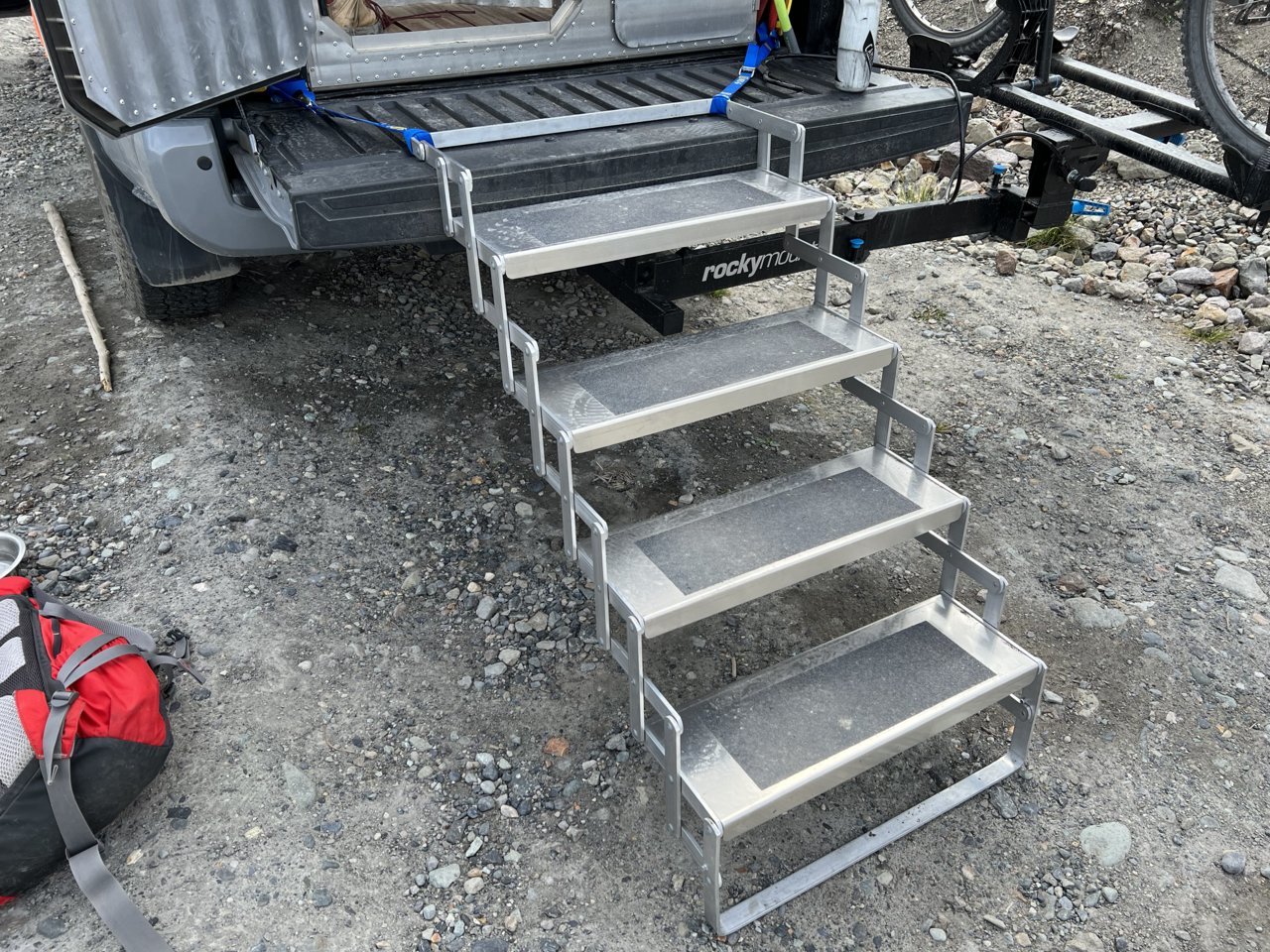

    After a long battle with a faulty airbag connector, I finally got our Alaska-based #108 on a 2021 Tacoma out for a road trip to McCarthy. This involves a 60 mile stretch of unpaved road. The rig handled beautifully. Also very pleased with the Brophy scissor steps we got from etrailer. Thought I would need the mounting bracket, but a couple of NRS straps are working just fine to secure the steps in place.

    Looks fantastic!! I also used the straps to hold the scissor steps to the tailgate, works slick.

    How do you tuck away the stairs when not in use? Do you attach and detach them each time you set up?

    Yes, they are unattached each time, folded and stowed inside the camper. For quick use, the straps aren’t really necessary as the steps sit partly on the tailgate and are very stable on their own.

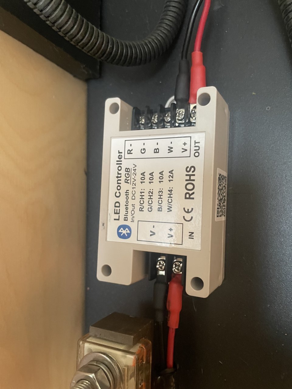

    Welp, I may be the first to completely lose the remote for the lights. After our last short trip I went ahead and installed the Bluetooth module below. It’s works great and automatically connected. Now we will be using our phones to control the lights. Hopefully I won’t be loosing that anytime soon. I’m sure that now this is installed the remote will turn up. :facepalm:
    EPBOWPT RGB/RGBW LED Strip Light Bluetooth Controller Phone APP Control for 5050 3528 RGB LED Strip Lights (Suitable for iOS & Android System)

    Super! that's the first part, now we just need to find a reasonably priced lower consumption alternative to the strip lights. At some point I'm planning to split the run with a "T" where the power connects to the one long string to see if two shorter strings may provide less draw.

    Would be nice to have the bed and living area on two different systems.

    Ooooh, that's a great idea...since it'll already be split - that would be the time to put a controller by the door for the main area and another remote controlling the upper/bed area on the wooden spar. We have the controller velcro'd to the side of the propane box as we enter but I don't know how many times I've forgotten to take it up to the bed area only to get comfortable and have to get down and grab the controller, or vice-versa where I've left it in the upper area and be heading out the door and then realize I have to go back and find the controller to shut the lights off before leaving...this seems easy but we try to keep the shoes off in the Kimbo, so if I'm heading out then my shoes are already on and there is no way to get the controller without taking them back off. Definitely like the idea of having two remotes. That should also cut the electrical draw in half when we're only using the main area or in bed!

    Oh yeah, I’ve done some crazy stretches like the floor is hot lava to reach the remote up by the bed. Don’t know if the app for my module allows for more than one but my home lights do. There might be a product that is able to connect multiple modules.

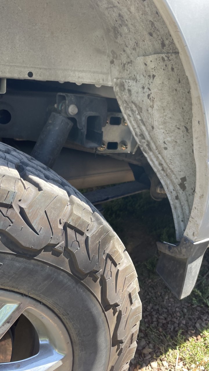

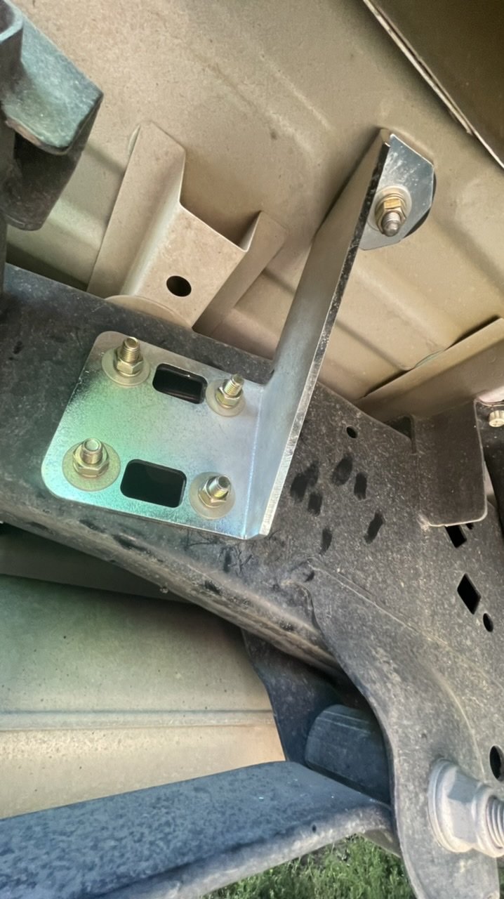

    Installed the mounts from mule expeditions
  18. Aug 16, 2022 at 1:10 PM
    #1618
    akpfeiff
    akpfeiff Active Member
    Apr 12, 2022
    #394891
    28
    Dang, that looks beefy! I take it that is a Tacoma specific bracket under the bed?

    35
    Ford F150 6.5 box, KIMBO #248
    F150 specific - I think the concern was the aluminum beds
