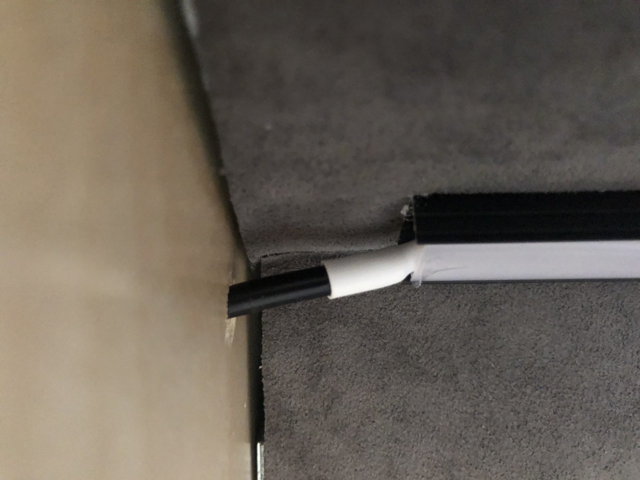

    RideRite airbags

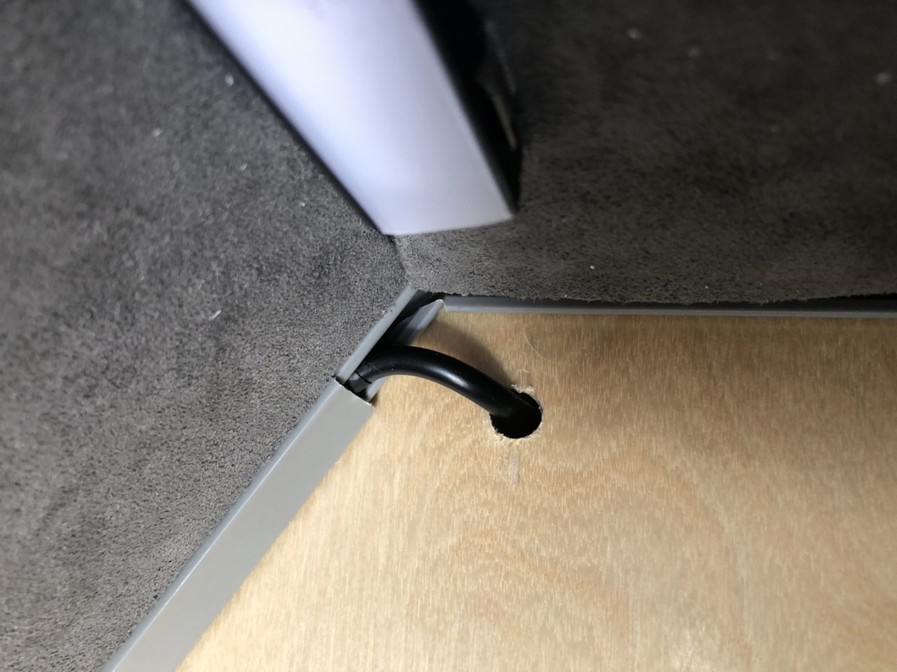

    Ok, got the second controller installed...I'm amazed at the difference in brightness - I'll likely replace the the old controller also and the front LED strips because I've had nothing but problems with the first two connectors.
    The replacement roll of LED lighting comes with a short power cord and plug soldered to the strip - I cut off the plug and soldered the power wire from my new controller to the short power cord.
    The way I split the LED string is by bringing the second controller up the wire channel to the top of the wooden strut and drilled a hole through the strut for the wire to pass through - I decided to do some pre work because I wanted to have the connector to the first strip soldered up and shrink tubed so I wasn't fussing with it inside the Kimbo.
    I removed the last LED strip from the channel and replaced with the new power cord strip and then cut the strip just above the window so there would be a zone of LED's for the bed area and another zone in the kitchen/entry area.
    There are two things to take into consideration when splitting it this way:
    1. the direction of the strip starting on the other side of the wooden strut changes the positive/negative wire relationship with the other strips (I only replaced the first strip going clockwise from the power source). I know that positive/negative usually doesn't matter with LED stuff but I wanted to be consistent with the power so I wasn't introducing problems. To resolve this, I cut one connectors in the corner and just cut/switched and spliced the wires...there is no way to just swap the leads because of the way the connectors are manufactured.
    2. When the strip is cut, I bent over the connections at the cut - placed a strip of electrical tape in the channel so they wouldn't make contact with the aluminum channel and then taped the ends also to keep them folded over.
    Looking forward to using the new setup this weekend.

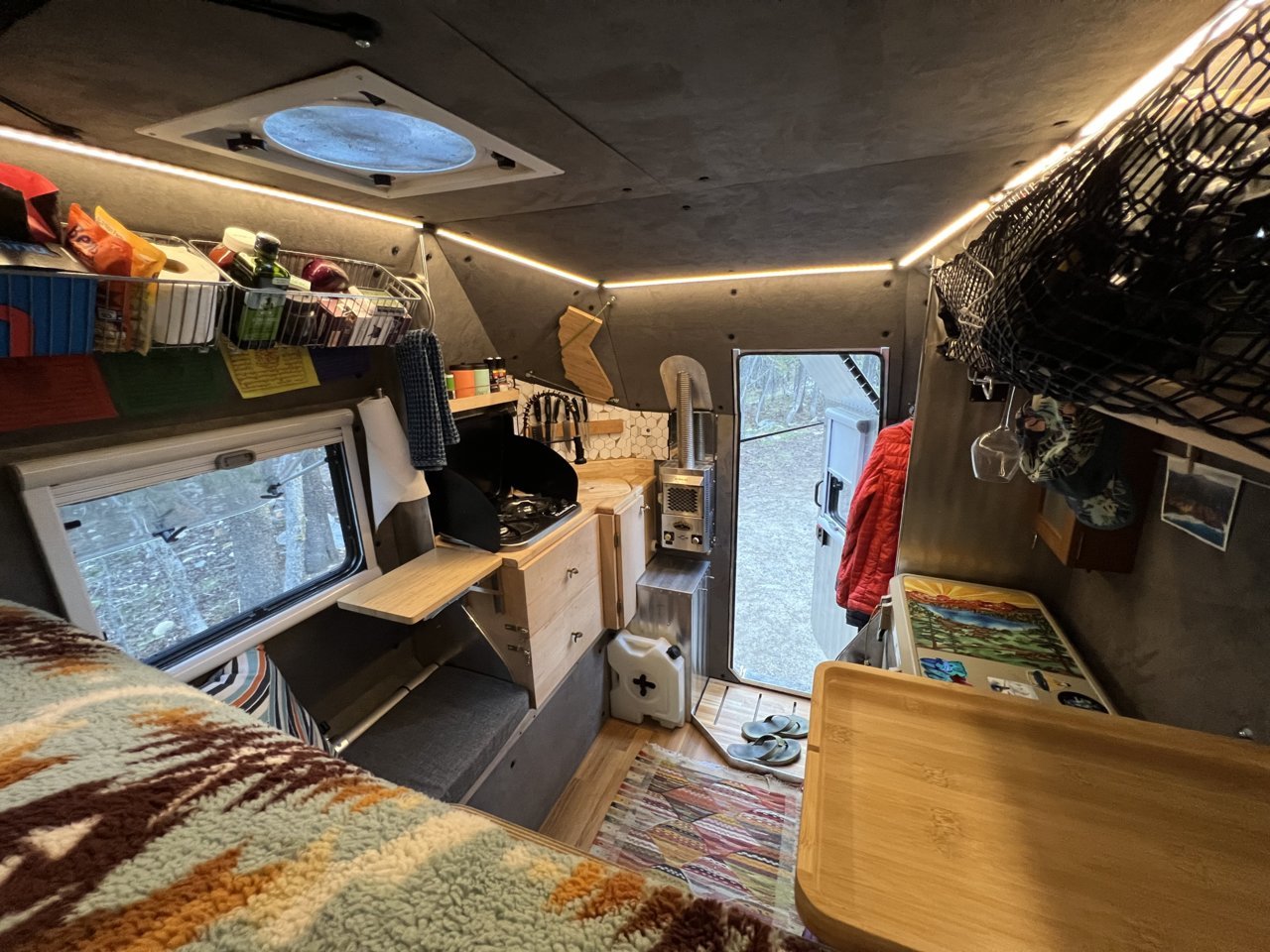

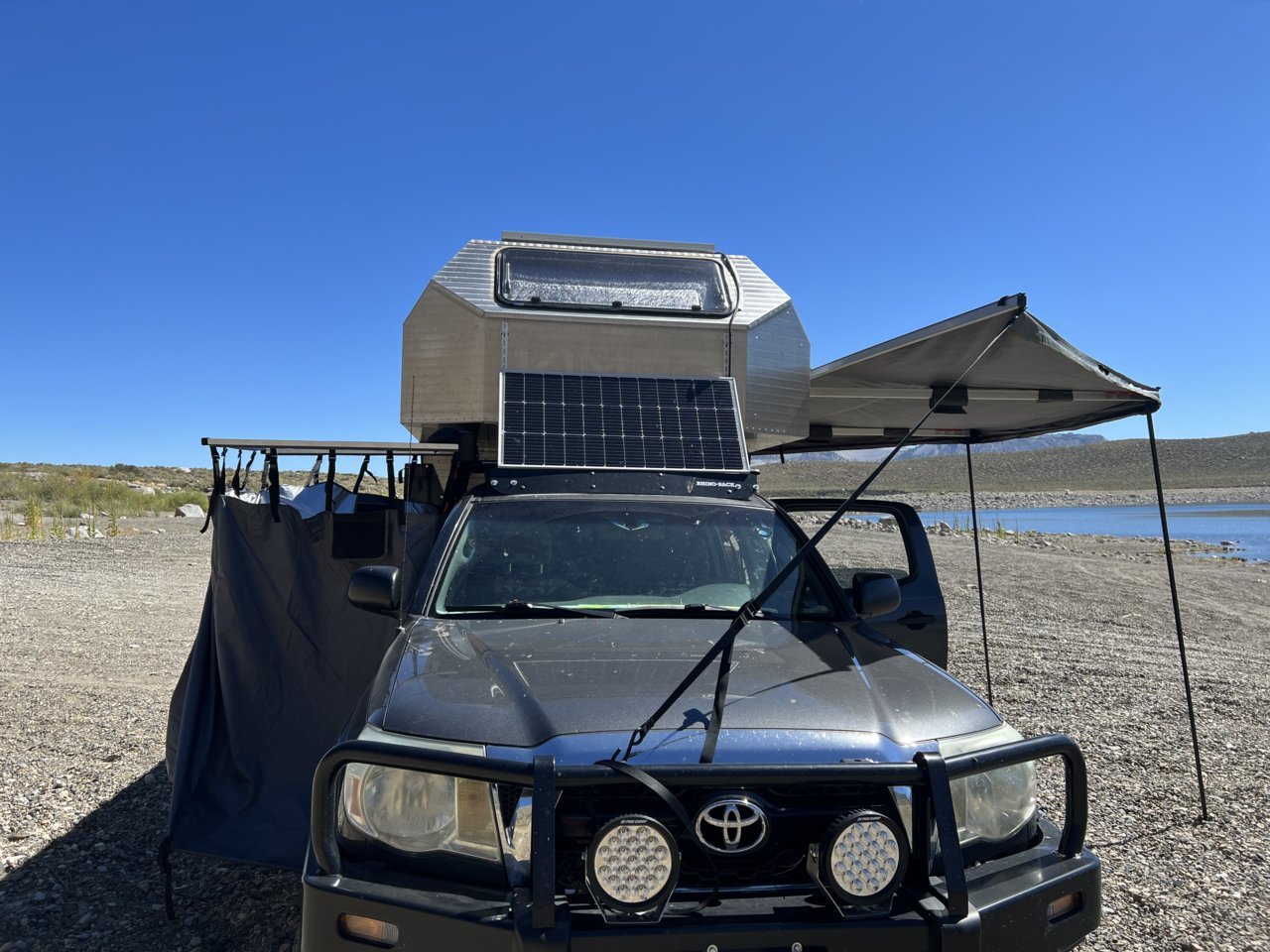

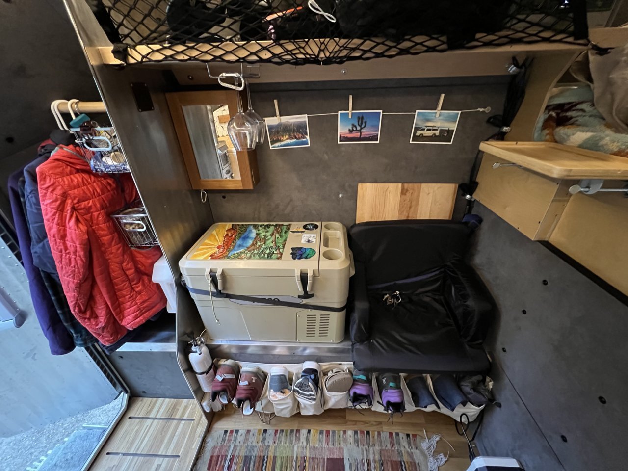

    Joby1
    Joby1 Member
    Mar 21, 2021
    #360082
    16
    2011 Tacoma

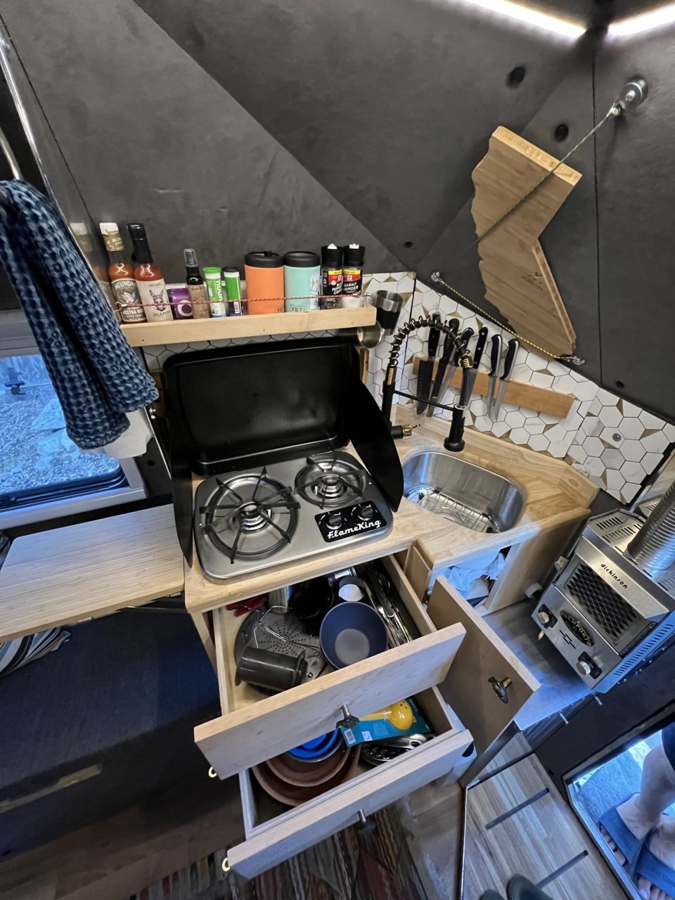

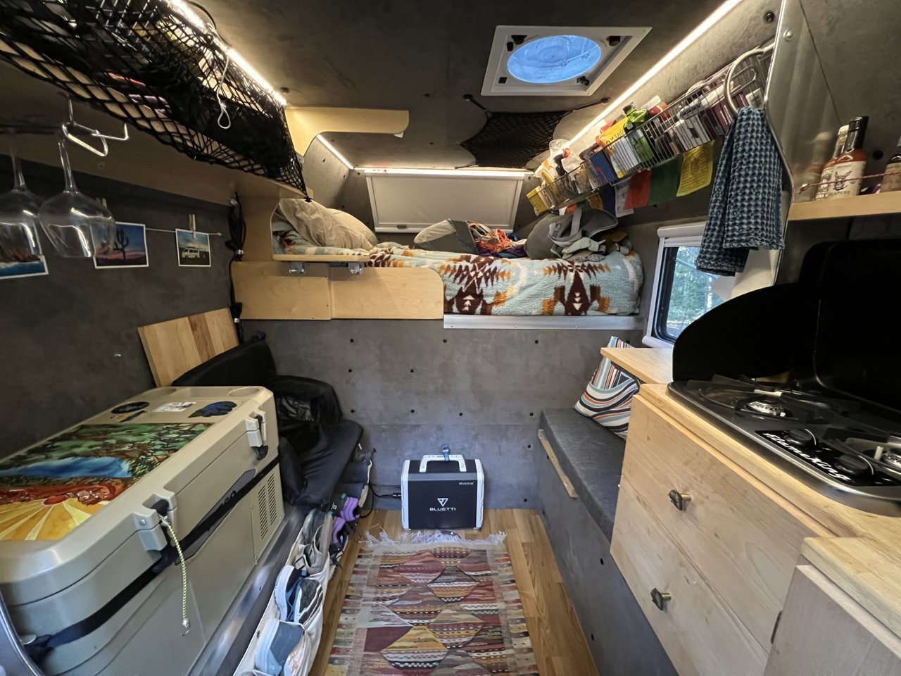

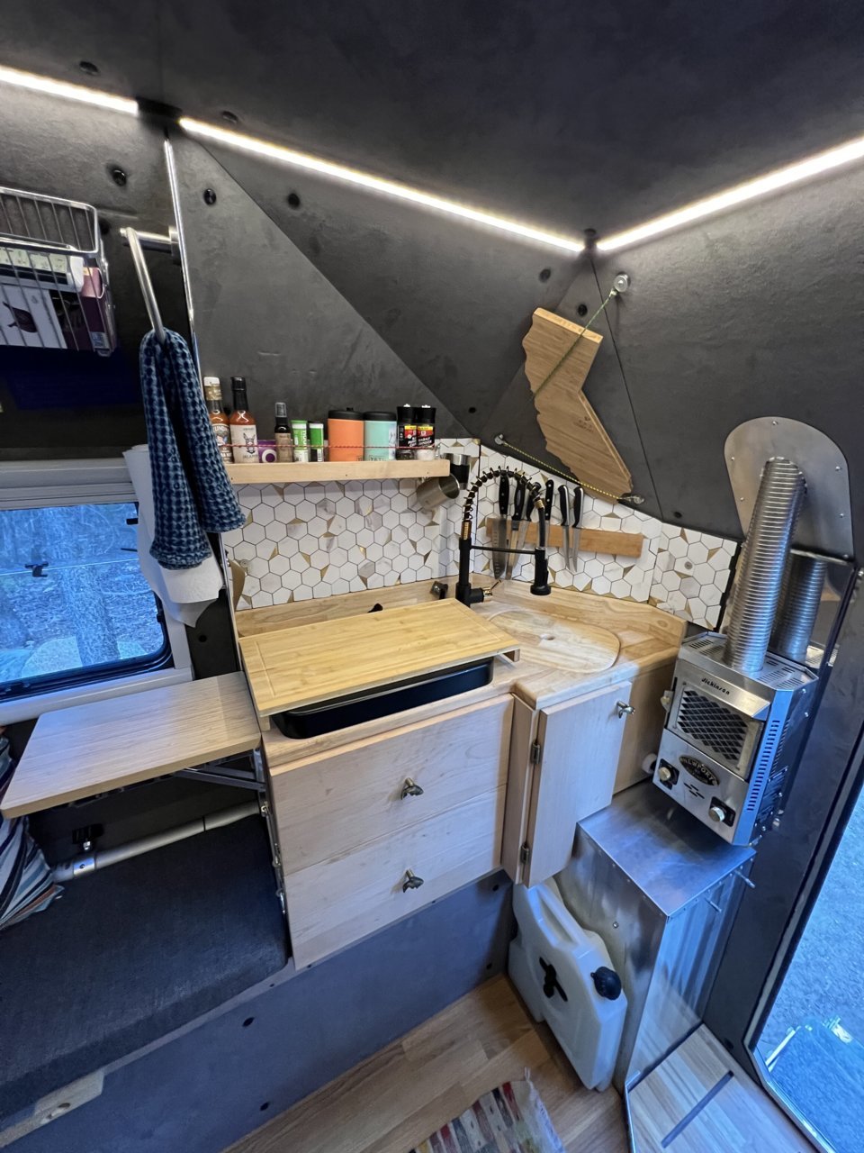

    Howdy folks. It’s been awhile since I’ve posted, been a busy summer with projects and trips! Smoke free so it’s been a blessing. Since my last post, I’ve added an addition solar panel on the front to improve power & wind resistance while driving. Which I believe has improved my mpg to 14-14.5mpg. I’ve also added the OVS 180 awning on the side and the OVS outdoor shower/pooper privacy. Inside I added an additional fold out counter space, spice shelf, and backsplash tile. It’s been a fun project!

    looks great!

    Love the cutting board - tell us you’re from California without telling us you’re from California
    might use the little door with the cutout idea, that’s cool too!
    Voltron4x4[OP] and Joby1[QUOTED] like this.

    Joby, this work is top notch!!
    I am especially a huge fan of how you did the shelves + net. I don't think it violates the "see everything" premise of the baskets, but in my mind it is more versatile! I am definitely inspired!
