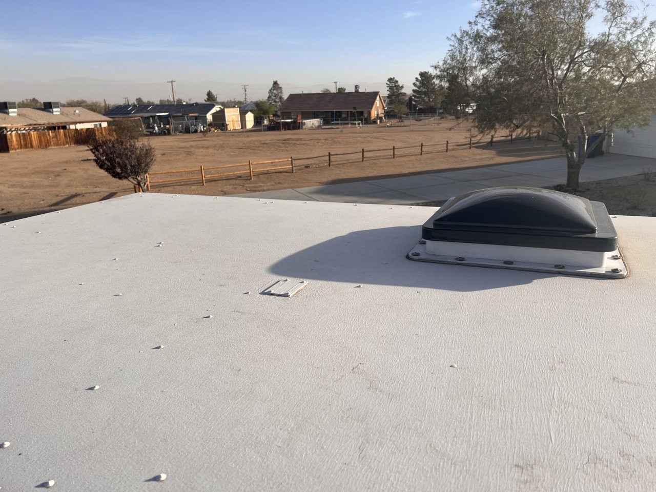

    A question to anyone who has installed solar panels on the roof of their Kimbo. I see there is a rectangular patch near the center of the roof that measures approx. 2"x3" -- I wonder if this is where the entry gland would have gone if I opted for the factory solar... it makes sense since my camper has cut-outs and holes for all the other options that I opted out of. If anyone knows or has a picture of where the wires enter the camper that would be great! Thanks in advance.

    I believe that’s about where mine comes in.

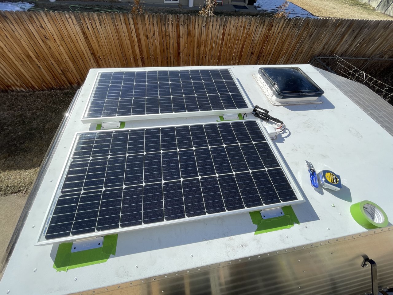

    Voltron, which panels are pictured here?

  8. Nov 6, 2022 at 12:19 PM
    #1748
    Voltron4x4
    Voltron4x4 [OP] Well-Known Member
    May 2, 2017
    #217975
    2,078
    Denver, Colorado
    2014 Black Trail Limo
    This and that...

    That does look like the spot where the solar wiring passes through the roof.

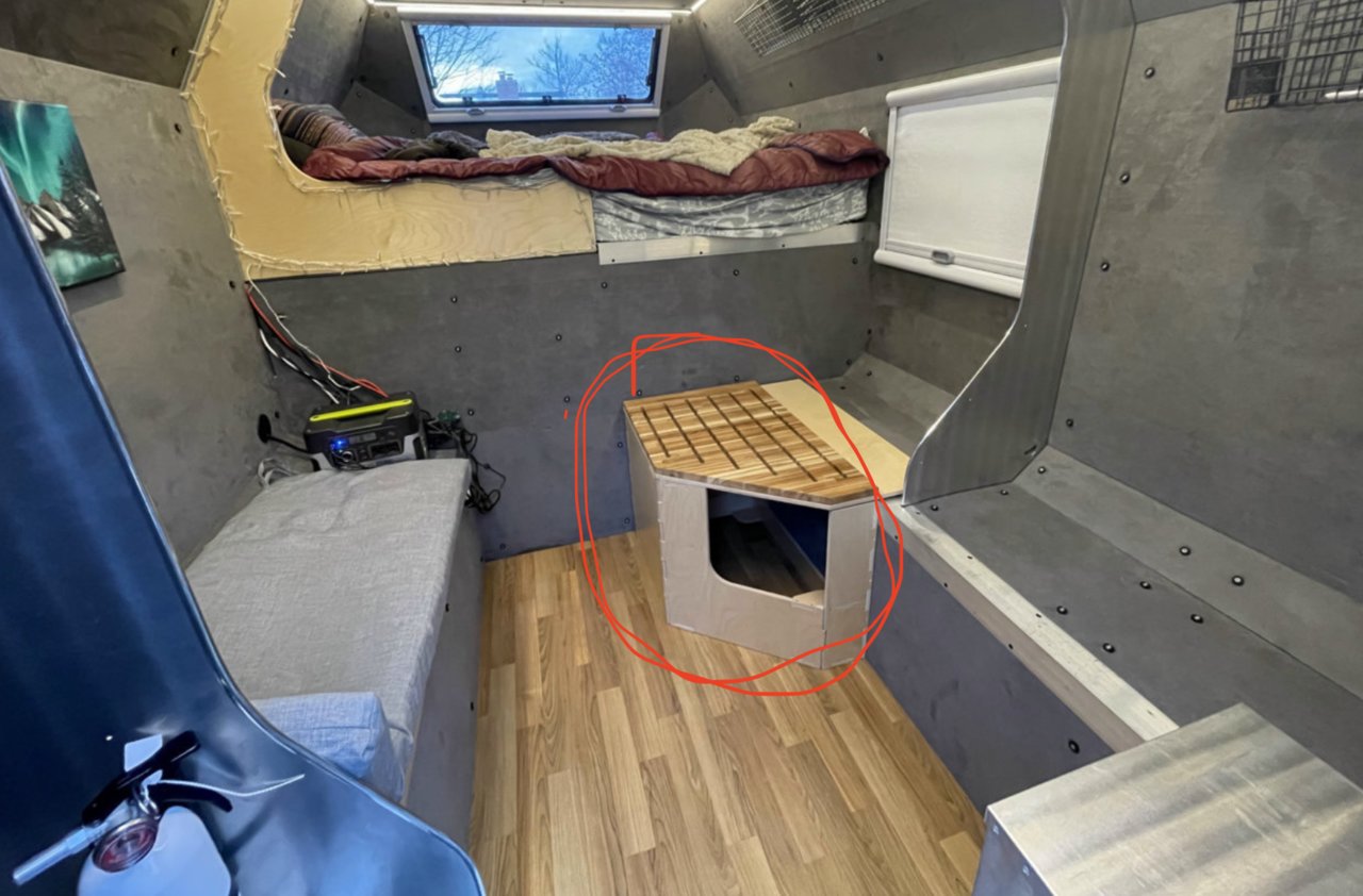

    Hi Voltron, did this storage piece circled come standard as part of your shell model? I am trying to understand if that box comes standard or if you only get that storage piece when purchasing the shower module.Screen Shot 2022-11-12 at 7.09.04 AM.jpg
  16. Nov 12, 2022 at 8:45 AM
    #1756
    Knotar
    Knotar Member
    Jun 20, 2022
    #399760
    11
    That storage did come with my unit that was pretty much the base model with only the Fan upgraded.

    Yep, it's standard. The shower option requires additional fabrication to the storage area.
