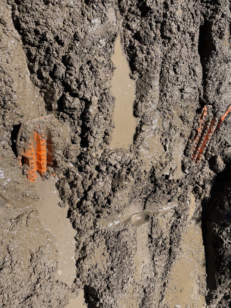

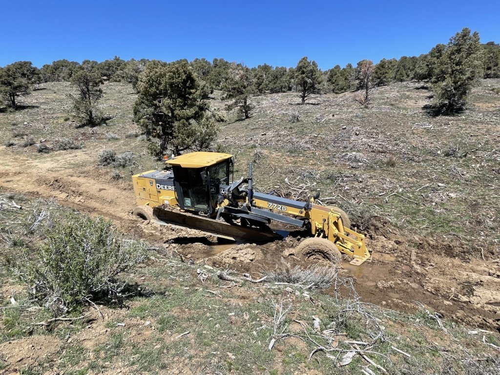

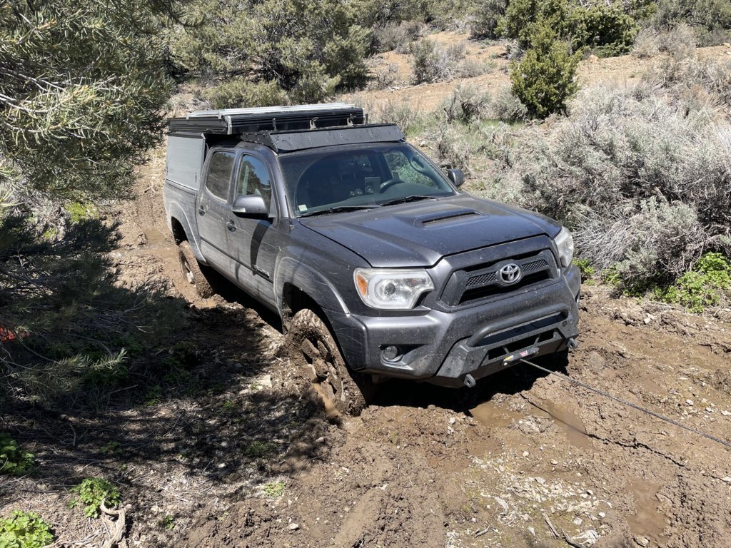

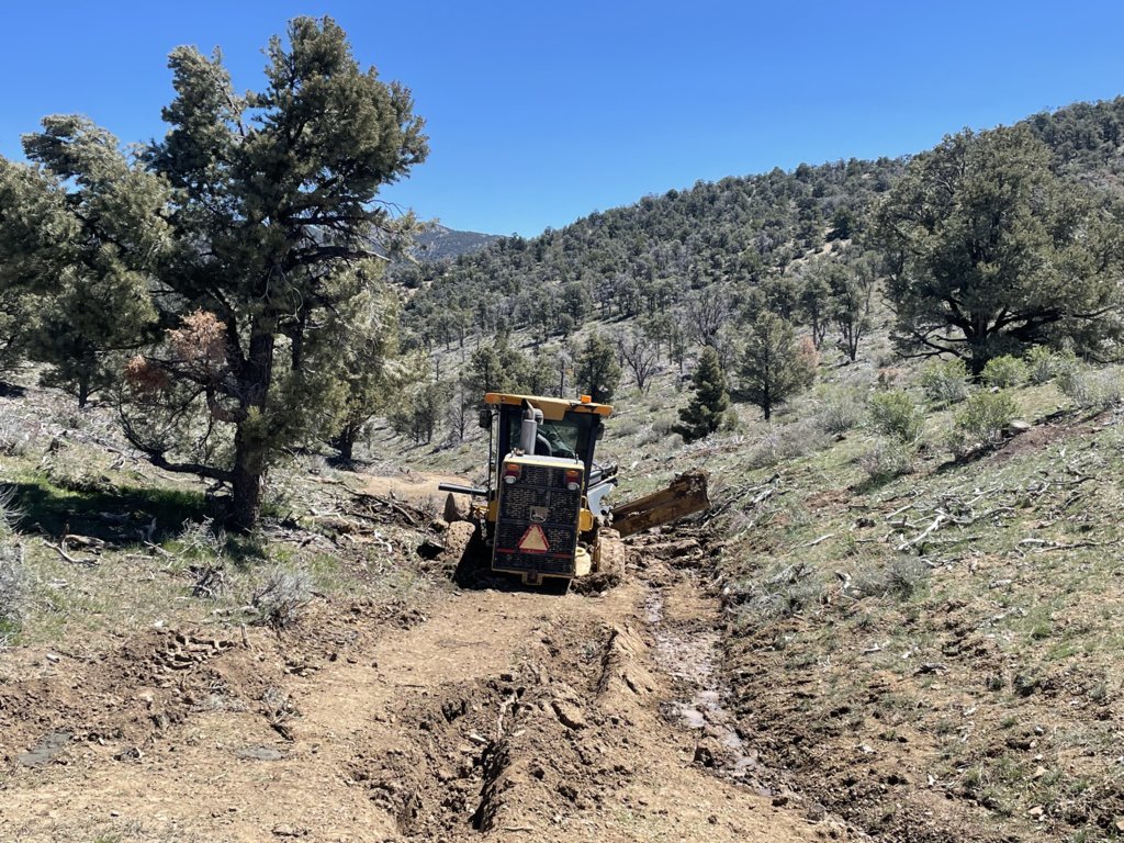

    If you are off-roading solo a shovel, traction boards and winch with proper accessories are needed. And a satellite communication device with rescue service.
    I had already dug out around the tires, used winch with traction boards. Tip, always use your straps on the traction boards, not sure I would have got them both out of the mud without the straps.
    As mentioned earlier, make sure you know how to safely use your winch. I attended a class at overland expo the prior year so put the training into practice.
    This was solo on the NVBDR from Oatman, AZ to Elko, NV.
    bjohn041 and YF_Ryan like this.

    Don't you love having to dig out Maxtrax? We ended up using a snow probe out at the dunes one day. A set had gone vertical straight down, lol. took way too long to find them!
  11. Oct 1, 2024 at 11:52 AM

    They have dummy straps that you can attach to them to prevent losing them in the sand…or in this case mud.

    It was a bitch, seriously debated leaving one there. The suction of that mud was something else.
    Bypassing this is what led to me getting stuck.
    YF_Ryan and bjohn041 like this.

    Yes, that's why I mentioned to always use the straps in the post.
