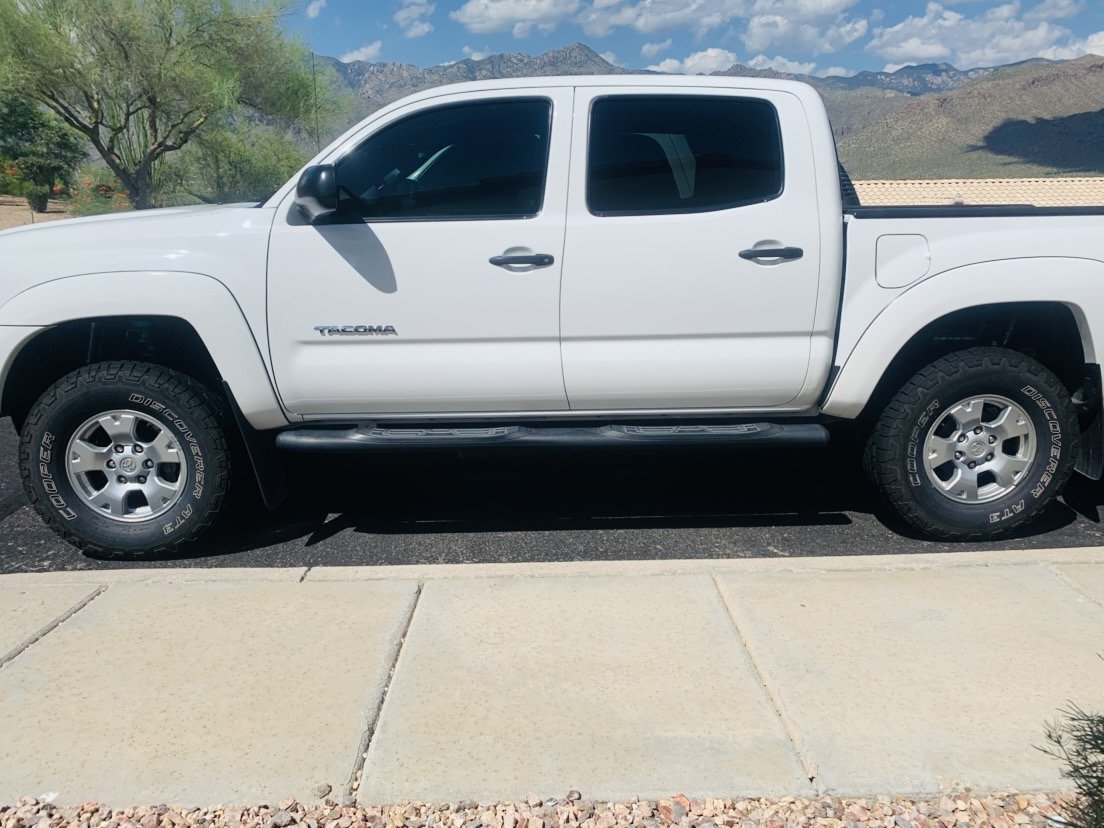

    Factory level meaning your standard leveling kit. No rake. Front level with factory height rear.
    So I measured top hat to center lower shock bolt and it came to 21.5
    The rear is factory pack with Icon aal progressive. Overload removed

    Measured from center hub to fender is 22.5

    It should be good then, you're truck doesn't look like it's excessively lifted.
    Have you inspected for interference? There's been a few cases reported on here where folks received parts that weren't properly set up for their use (wrong rod end misalignment spacers, wrong lower coil seat) and components were hitting each other during travel or steering.
    Also, did you order the extended Coilovers? Those are supposed to only be used with aftermarket UCAs. I *think* if they are used with OEM UCAs either the ball joint will bind or the UCA hits the coilover, not sure which.

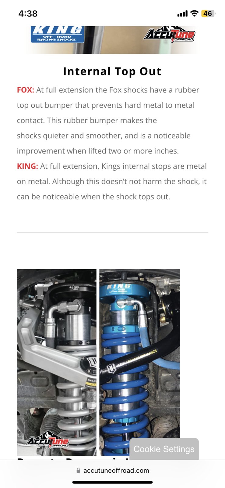

    This is the problem. Had that same issue on my 14 DCSB, hated the kings until I welded limit straps which solved the problem.
    main reason why I went with Fox on my 23 tacoma.

    I believe King is making changes to newer shocks which include a similar internal top out bumper. I will keep an eye out in back and snap some photos if I see it.

    Hopefully they do change it. When I had the issue I was so surprised I didn’t find much info on it with so many people having kings on their Tacomas
