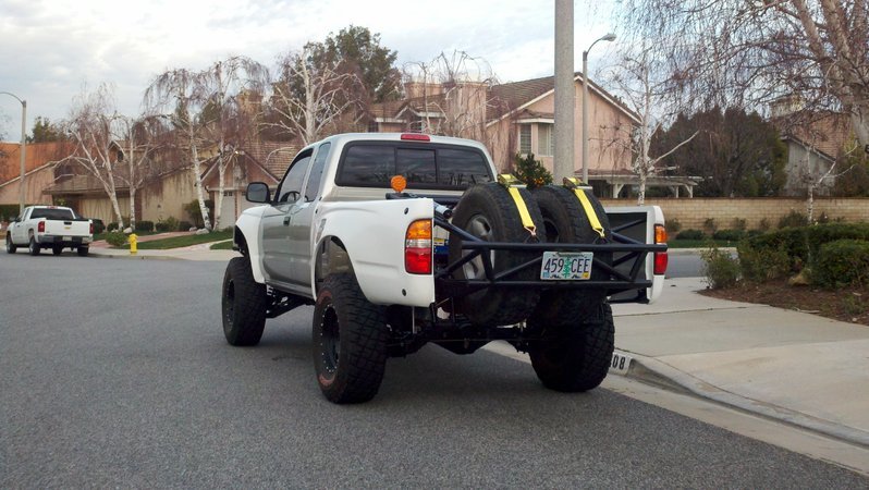

    IMO you should just save up for a long travel setup
    I started with mid travel and ended up with long travel, I could of saved a lot of money if I skipped mid travel.

    Yeah, that's kind of my thought too. Helps a bit budget wise that I can do my own fab work for the bed cage (will probably go flatbed at the same time) and gusset work. Are you running a bypass up front?

    Yes
