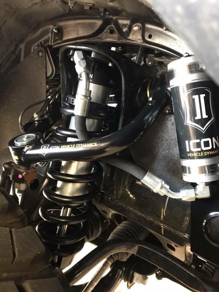

    The reason i chose the Icon was because I liked how reservoirs looked. After looking on forums (rather than reading), I really liked the Icons and I ordered them. I actually almost cancelled my order for Fox shocks because I started to read more but the restock fee kept me from doing it so on the Icons went. The Icons felt great on smooth roads. With the Icons I feel like I can take turns pretty aggressively without much body roll on the streets. When I did some quicker off roading the suspension shined as well again. I was pretty with my Icon setup for a while, however I recently moved to another island and now the roads terrible, and there is no where to do quicker off roading. There is also a speed bump in my apartment parking lot that just sends a jolt through the entire truck and it was just too much.
    Pros: Reasonably priced mid level suspension, great on road handling(handling not comfort), great higher speed off road.

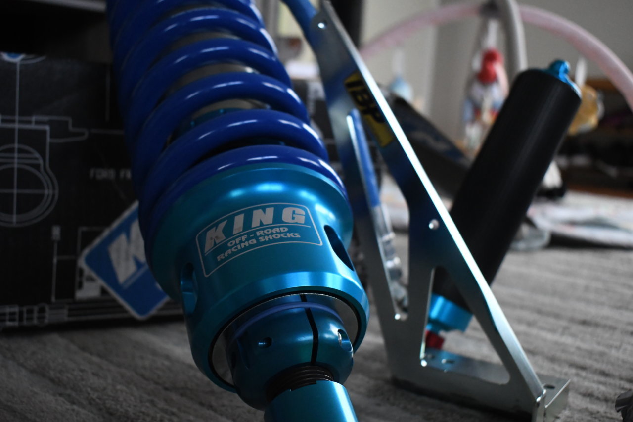

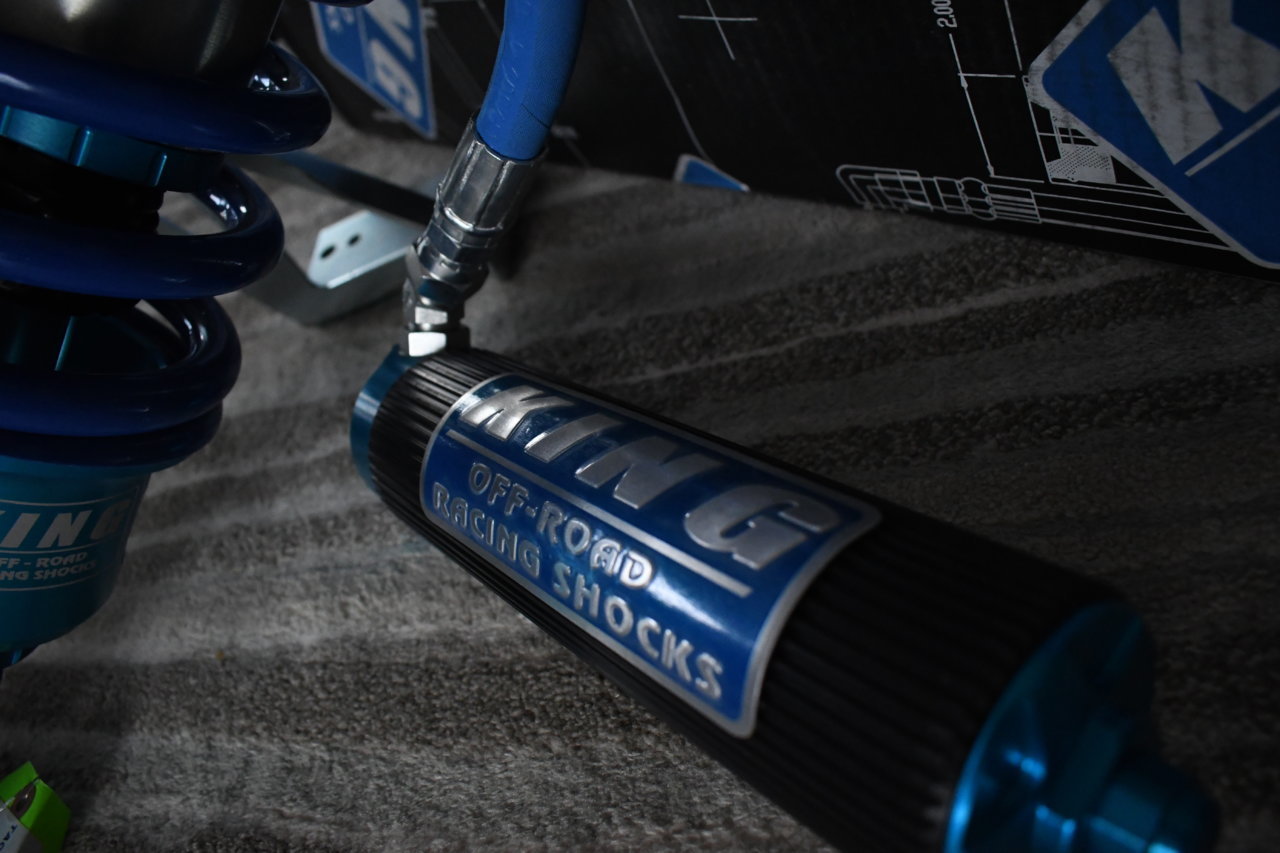

    I ordered the set through Rogue Off Road. The front shocks were here within three days, the rear bypasses and Icon Billet delta joint will be here tomorrow. When I first opened the box of the front coilovers, the first thing that is really exciting is that King blue. The finish of the shocks is something really nice to look at. The next thing I noticed as I opened the box further is just how beefy the shocks were. These things were huge. As I looked at the shocks, I think you can see what makes King's, King's. The clicker on the front feels like a really quality piece, its made out of metal and there is a nice click each time you turn it. The reservoir mount in comparison with my Icon, I have to say goes to King. The King mount looks much more beefy. Staying on the resi mounts, the Icons use essentially pipe clamps to attach the resi to the mount. The kings have their own pieces made that are also finished in King blue. So far in the packaging and attention to detail part, I have to give it to King.
    Here is a quick vid showing the front shock
    https://youtu.be/3QMrUkcOSrw

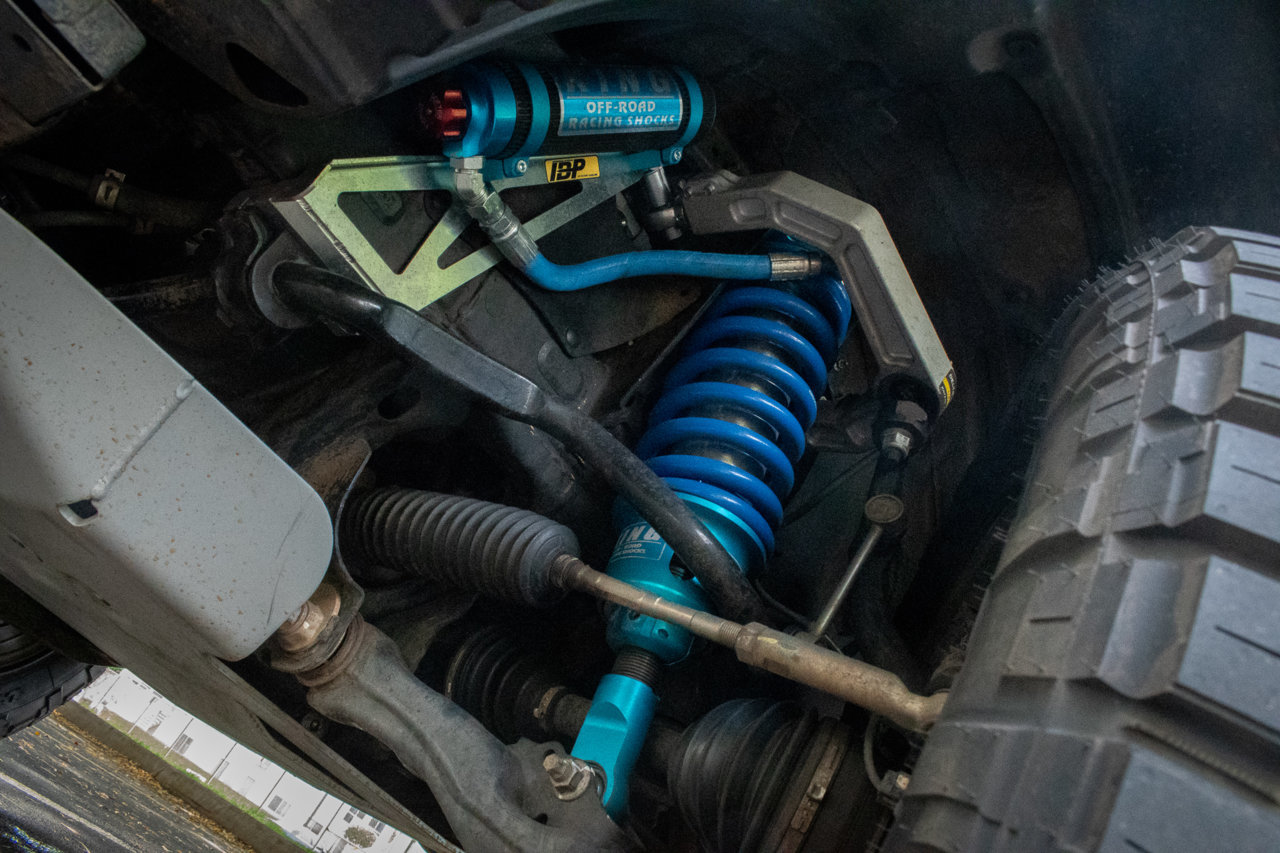

    These are the front Shocks. You can see at the bottom with all other King 3.0 series shocks, the adjustment collar is at the bottom. This made for very easy adjustment. I was able to max out the preload with the shocks on the truck without much difficulty. King says you can get 1.5-2.5 inches of lift on a 2016+ tacoma. I have 1" of threads showing right now. You can also see with the 3.0s vs the 2.5s, the mounting hardware is much nicer. Instead of the pipe fasteners, you get mounting hardware specific to the resi coated in king blue. The 3.0s also have finned resis opposed to the 2.5s that dont have them. The factory springs are 550s from the factory. This is something Im thinking of changing down the line when its time to rebuild.

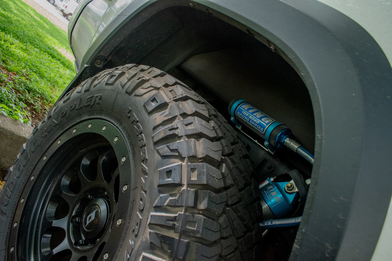

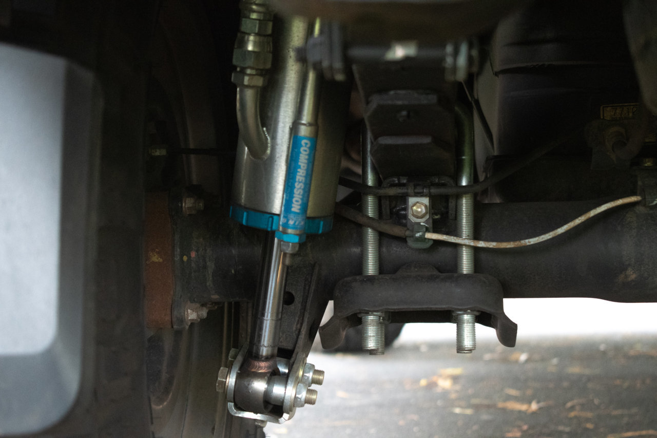

    These are the rear bypasses. King sends you some extra brackets that lower the mounting point of the shocks. It appears to be very similar to Icon's RXT shocks but rather than having the L in the eyelet they just changed the mounting point with hardware. The rears feature adjustable compression and rebound and again finned resis. A nice touch was the new stickers (not really stickers), they were made of a single peice of metal with raised lettering. Similar to the fronts you got very nice mounting hardware as well.
